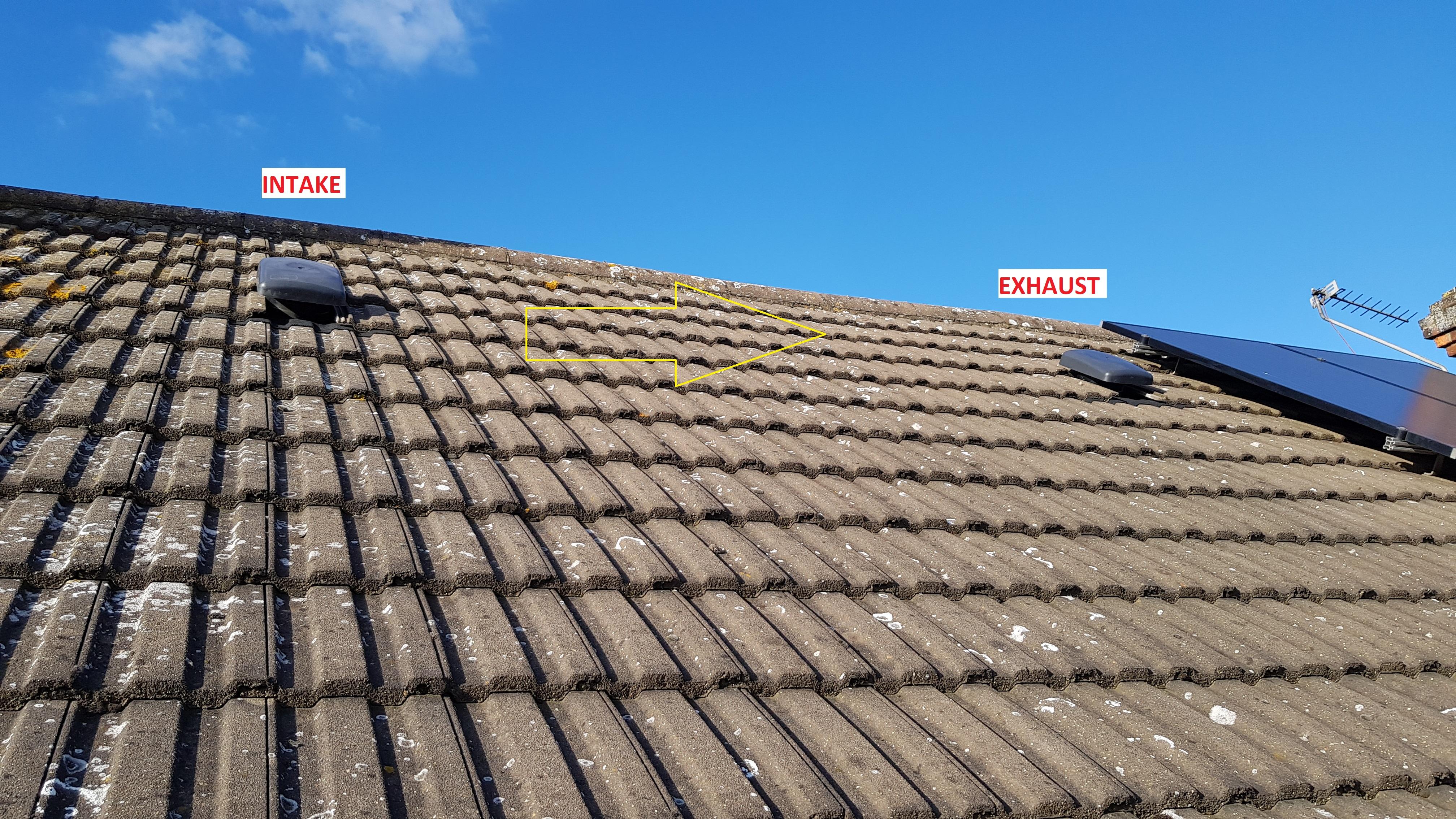

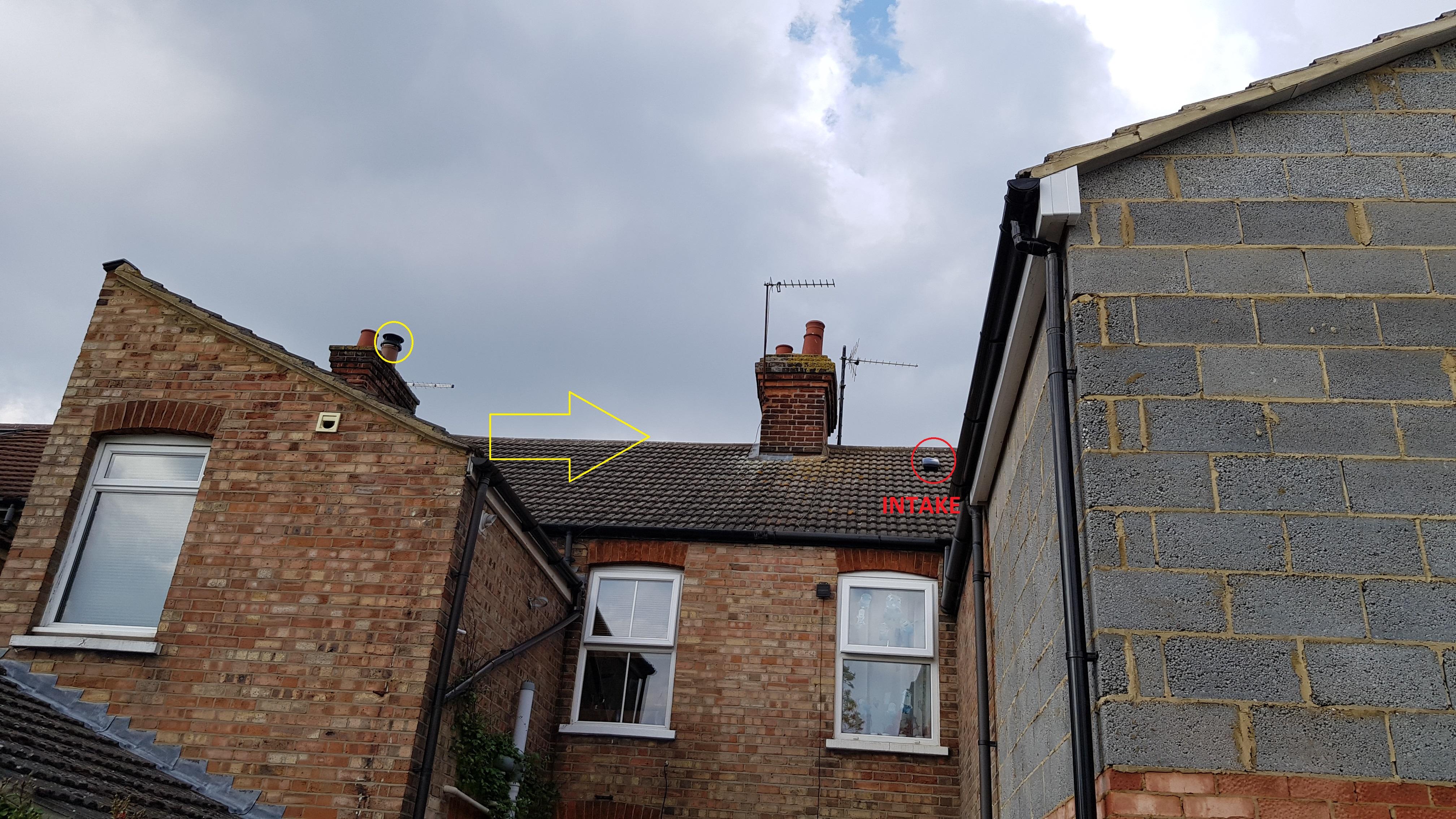

Savage87 Posted May 4, 2020 Author Posted May 4, 2020 I wish I could move the intake somewere else, but my MVHR is in the loft it's not going to be easy. This has been designed in such a way that I keep bends and ducts to a minimum to reduce pressure in the system. I have attached a photo of my room and the offending chimney in yellow together with the wind direction. I'm going to do a bit more investigating in what sensor I need to pick so it can sense the smoke in low quantities. I haven't yet ruled out the carbon pre filter. I would like this to be a last resort. Thanks all for all your help so far.
JFDIY Posted May 4, 2020 Posted May 4, 2020 Can you swap the inlet and outlet pipes to atmosphere easily to see if that is better?
Savage87 Posted May 4, 2020 Author Posted May 4, 2020 Because of wind direction I'm a bit reluctant to do that. My exhaust is almost 3m away for the intake, to the right as you look at the roof. The wind usually blows from the west to east, this means from the intake towards the exhaust. I'm afraid I might get contaminated air back into the intake if I reverse them. ?
JFDIY Posted May 4, 2020 Posted May 4, 2020 Unlikely to be a problem, it'll dispurse if the wind is that strong. Got to be worth a try.
Jeremy Harris Posted May 4, 2020 Posted May 4, 2020 54 minutes ago, Savage87 said: Because of wind direction I'm a bit reluctant to do that. My exhaust is almost 3m away for the intake, to the right as you look at the roof. The wind usually blows from the west to east, this means from the intake towards the exhaust. I'm afraid I might get contaminated air back into the intake if I reverse them. ? I very much doubt there will be the slightest risk of exhaust air being sucked into the intake with them that far apart. Diffusion will be so rapid in any sort of a breeze that the exhaust air plume will be very diluted over a couple of metres or so. Got to be worth a try, as it's probably a fairly easy change to make. 2
