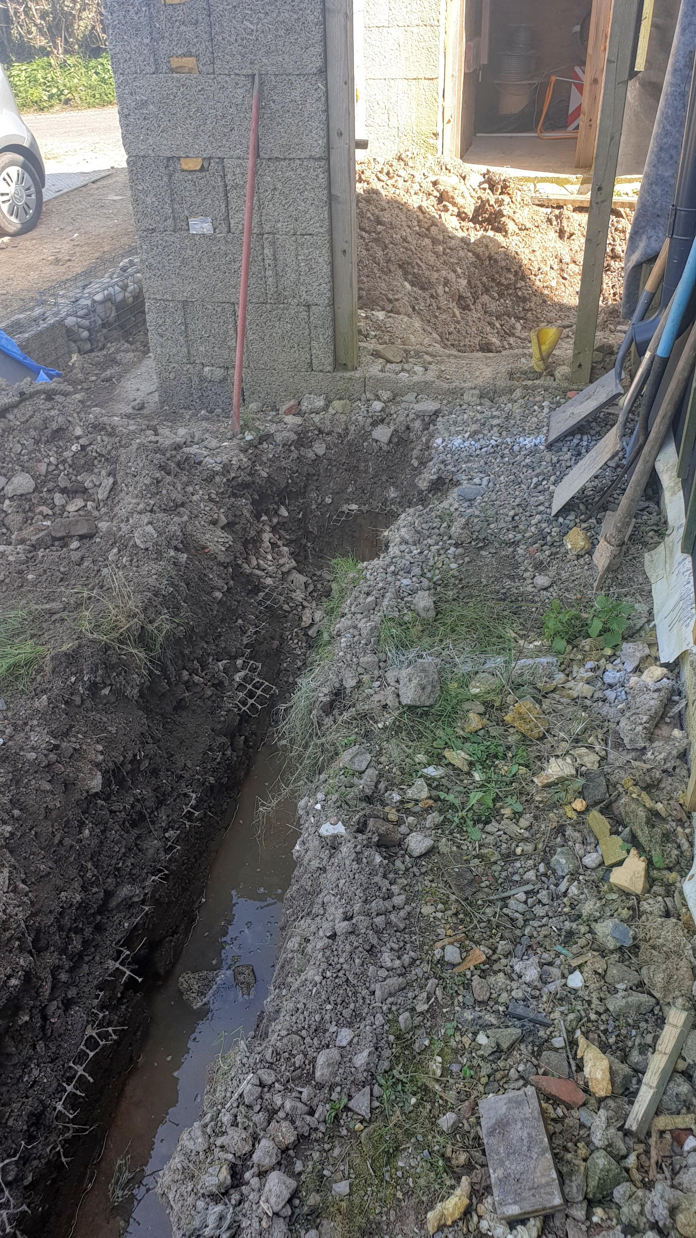

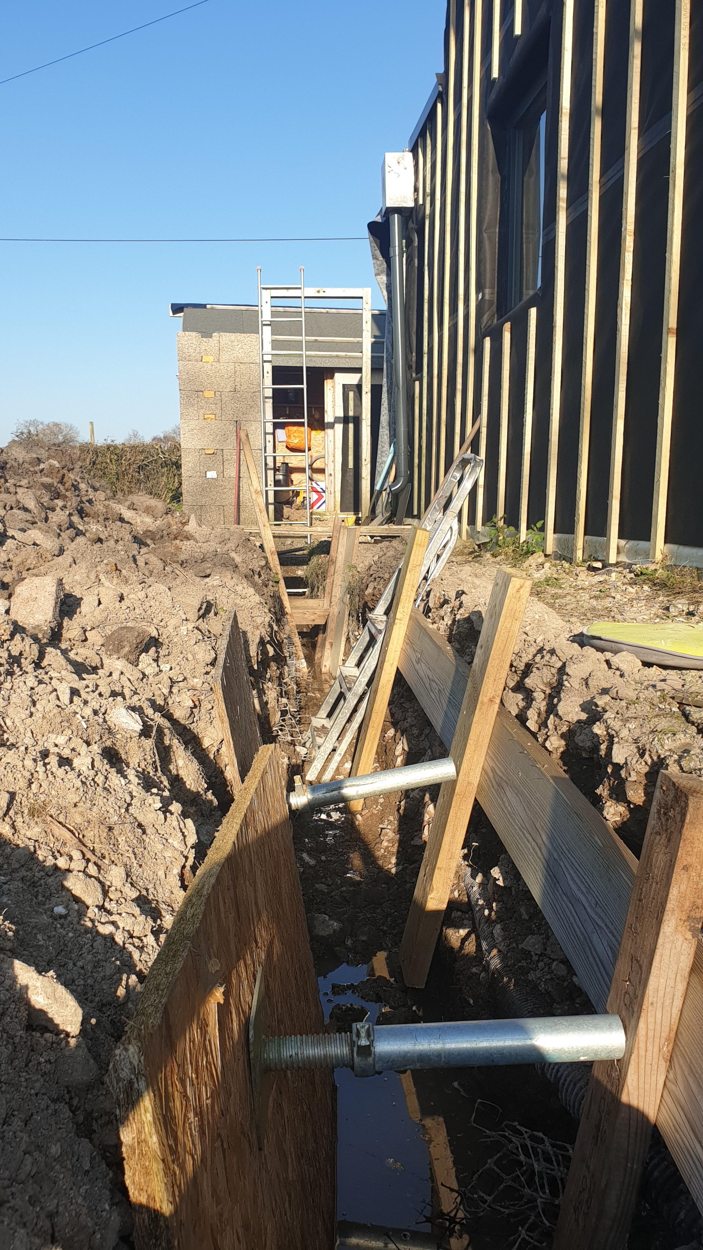

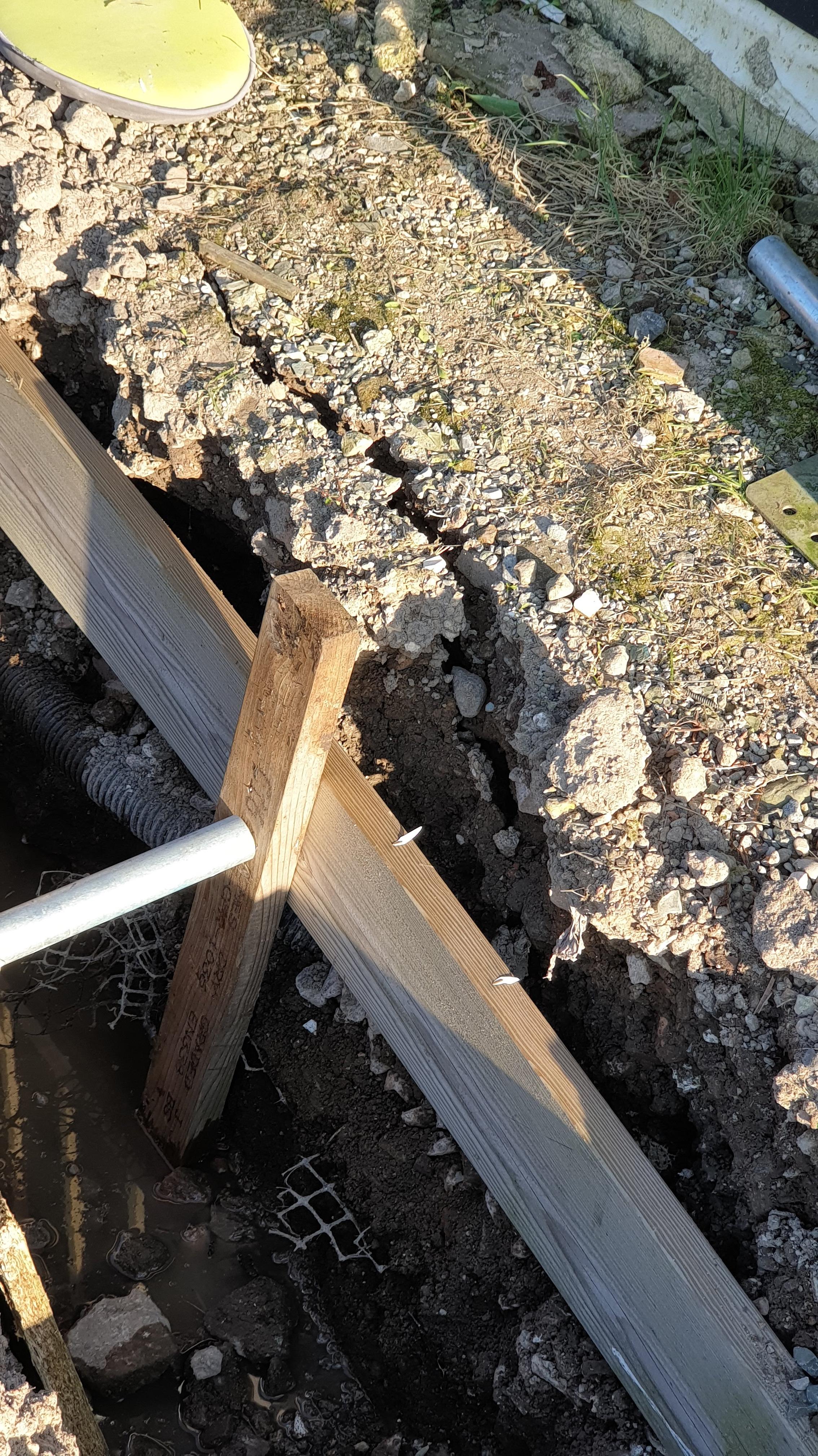

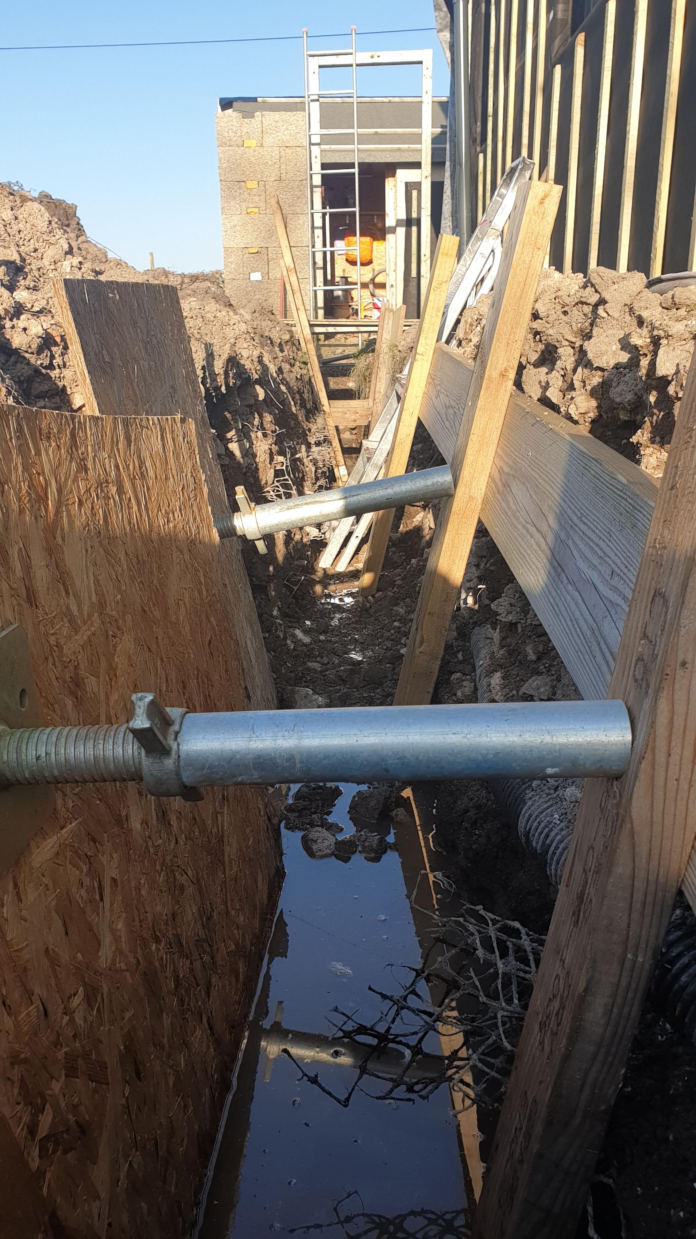

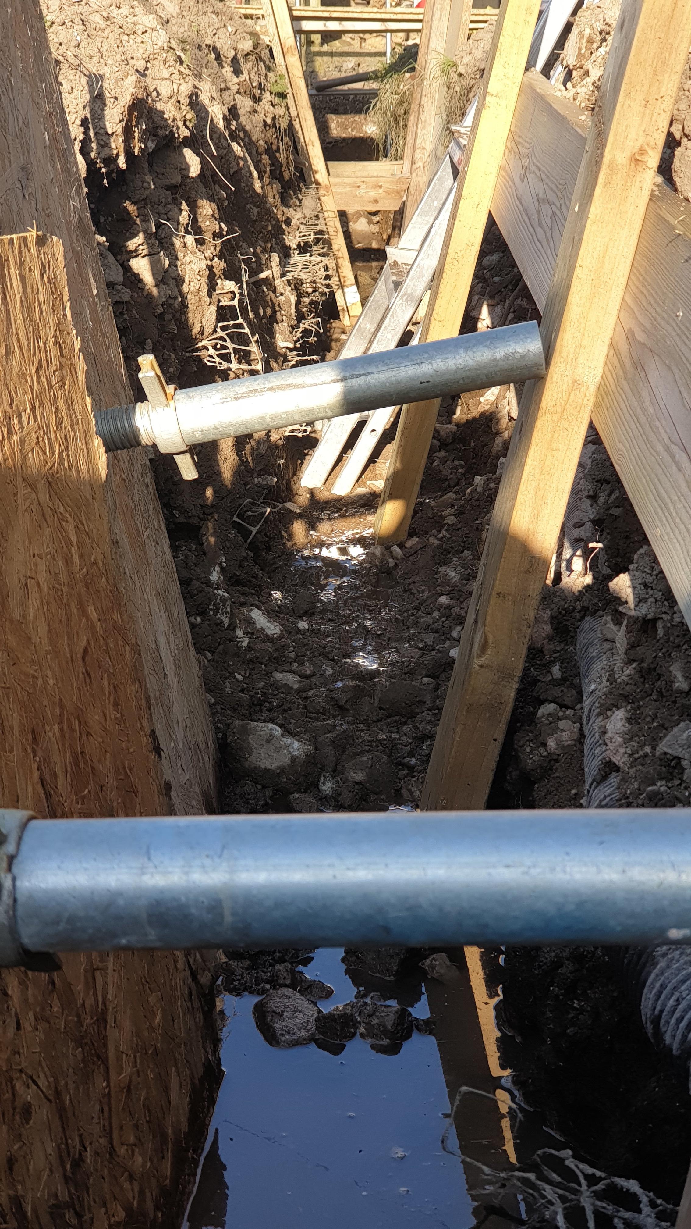

ToughButterCup Posted March 26, 2020 Posted March 26, 2020 The wailing and gnashing of teeth when my digga left the premises only got worse when I realised that Hartley Hire (good mates to me) were shutting up shop - no diggas for hire. The BH member who stole my beloved digger - you know who you are, (Sue) - should give it me back: pronto. I didn't mean to sell it. It wuz an accident. Honest.? I need to dig the trenches for our foul drains. But no digger. Or prospect of a digger. Just a day's work with a 2 tonner. Poo. Back t' 'drawin' board then. Dad was one of the Bridge Masters who were employed by the Local Authority while the M5 was being built. He was permanently banging on about coffer dams. Very focused on digging deep holes for bridge paprapets. Dimly, I seemed to remember something about digging deep holes in sand - like they have to do everywhere in Berlin. Its tricky, dangerous work. I recon the invert for our foul drain is about 1300mm down: not that far. But far enough if the bloody trench keeps falling in. I don't mind spade work, but a weekends' work was disappearing before my eyes. Damn. And then I remembered the key term: timber shoring, or even close timber shoring . Quick google and then this You beauty. Here's the trench without shoring Can't photograph a sore back: but it's sore. Monday afternoon I notice the edge is starting to cave in - collapse. So this is what did .... I've yet to dig towards the house (as opposed to along the side): thats where I'll need the close timber shoring. I'll post some pics tomorrow. Yes, I have blisters on my hands. Big girl...... 1
LA3222 Posted March 26, 2020 Posted March 26, 2020 That's a good effort on the trench, you dug that by hand? It's what I like about self builders, summat needs doing, it needs doing - simples?♂️ No one else is going to do it for you so a 'crack on with it attitude' is essential.
Oz07 Posted March 26, 2020 Posted March 26, 2020 I've never seen something like that shored is the soil crap round your way?
Mr Punter Posted March 26, 2020 Posted March 26, 2020 Looks like made ground. What's the mesh stuff about?
ToughButterCup Posted March 27, 2020 Author Posted March 27, 2020 The mesh is brilliant stuff, as long as you don't have to dig through it. It's function is to reduce the amount of MOT1 needed to underpin the raft. I can't remember what the numbers were, but it made financial sense to buy 100 square meters of it This is the stuff. You need an angle grinder to cut it. This is a good example of how powerful the stuff is.

ToughButterCup Posted March 27, 2020 Author Posted March 27, 2020 5 hours ago, joe90 said: [...]BUT why didn’t you dig this with your digger before you sold it (chump) ?.[...] I'm in competition with @pocster for Eeejit-Of-The-Year Award. I've left @Russell griffiths far behind, flailing in my wake: overthinking some more stuff I expect. I've just realised that I now need to dig a drainage trench before it starts to widdle down with rain - and fill up the trench more than it already has done. Mind you the water table has been higher, and we do have gentle slope on the site. And thats a significant blessing, I know. Hmmm, 'nother weekend lost then. (I'll have a ripped torso soon ?)
