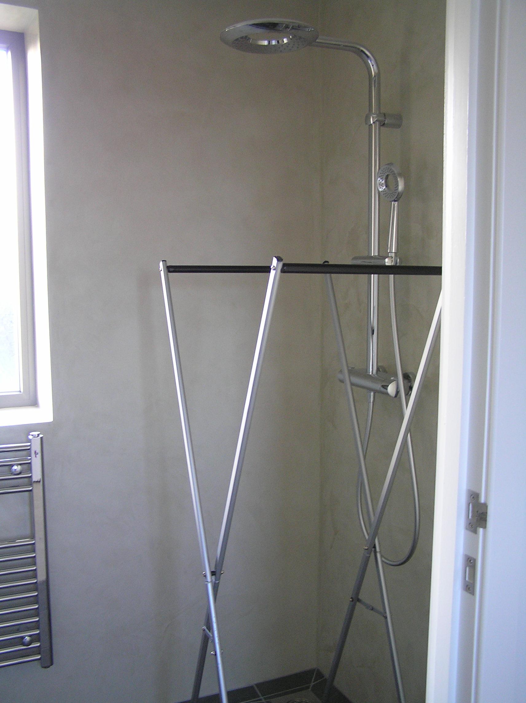

Ferdinand Posted February 12, 2020 Share Posted February 12, 2020 I'm playing with ways of drying washing indoors efficiently, and I would welcome comparisons. Currently experimenting with a drying rack in my downstairs bathroom either in the big shower cubicle, or just in the room, which is the warmest room and has an extractor fan. I find that leaving the fan on dries a load in about 16 hours. How long do other people's efforts take? Bear in mind that I do not have full MVHR. I could get a Pulley Maid for the utility, but I am not convinced that would be much better, or I could potentially stick a dehumidifier in the bathroom with the washing. Ferdinand Link to comment Share on other sites More sharing options...

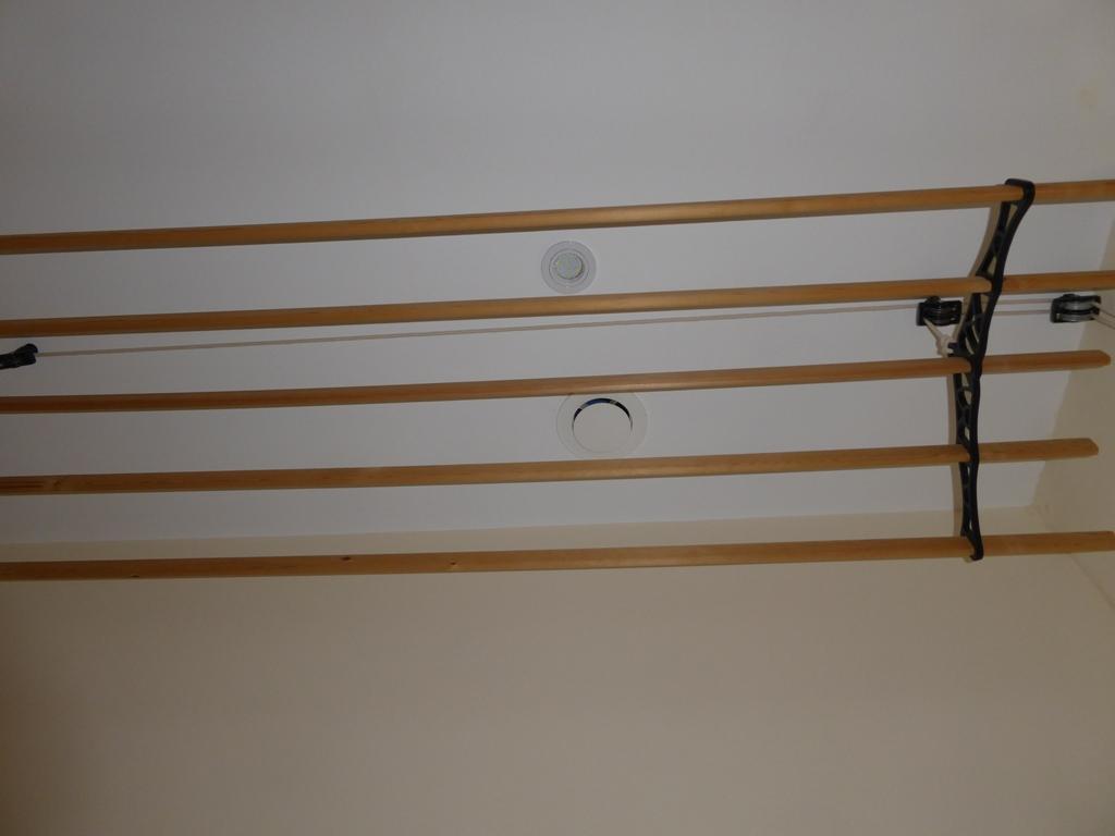

ProDave Posted February 12, 2020 Share Posted February 12, 2020 Pulley in the utility room. MVHR extract vent above it. Dry in a few hours. Never makes the room feel damp and no condensation issues. Some stuff goes in the tumble dryer to "make if fluffy" but we have learned it does not need to "dry" in the TD, just have some time being fluffed up. That too then comes out, still a bit damp, and goes on the pulley. It passes the "fluffy" test when dry. In the summer we use a washing line. Eventually when we build the car port, there will be a washing line under there to avoid the frustration of the washing being nearly dry then a shower comes along. 1 Link to comment Share on other sites More sharing options...
Jeremy Harris Posted February 12, 2020 Share Posted February 12, 2020 We have exactly the same arrangement, extract terminal above a pulley maid in the utility room. Works very well indeed: 1 Link to comment Share on other sites More sharing options...

Ferdinand Posted February 13, 2020 Author Share Posted February 13, 2020 Thanks all. So I am in the ballpark with my times. And the thing to watch is to set it up in the morning when the Waschmaschine has run with the morning solar, to be clear for the next morning. F Link to comment Share on other sites More sharing options...

Ferdinand Posted February 13, 2020 Author Share Posted February 13, 2020 I bought one of these stainless drying racks for £30, which seems great. Just fits in the shower cubicle or the bit of space outside the cubicle. https://www.amazon.co.uk/gp/product/B071K5FQYN/ F Link to comment Share on other sites More sharing options...
