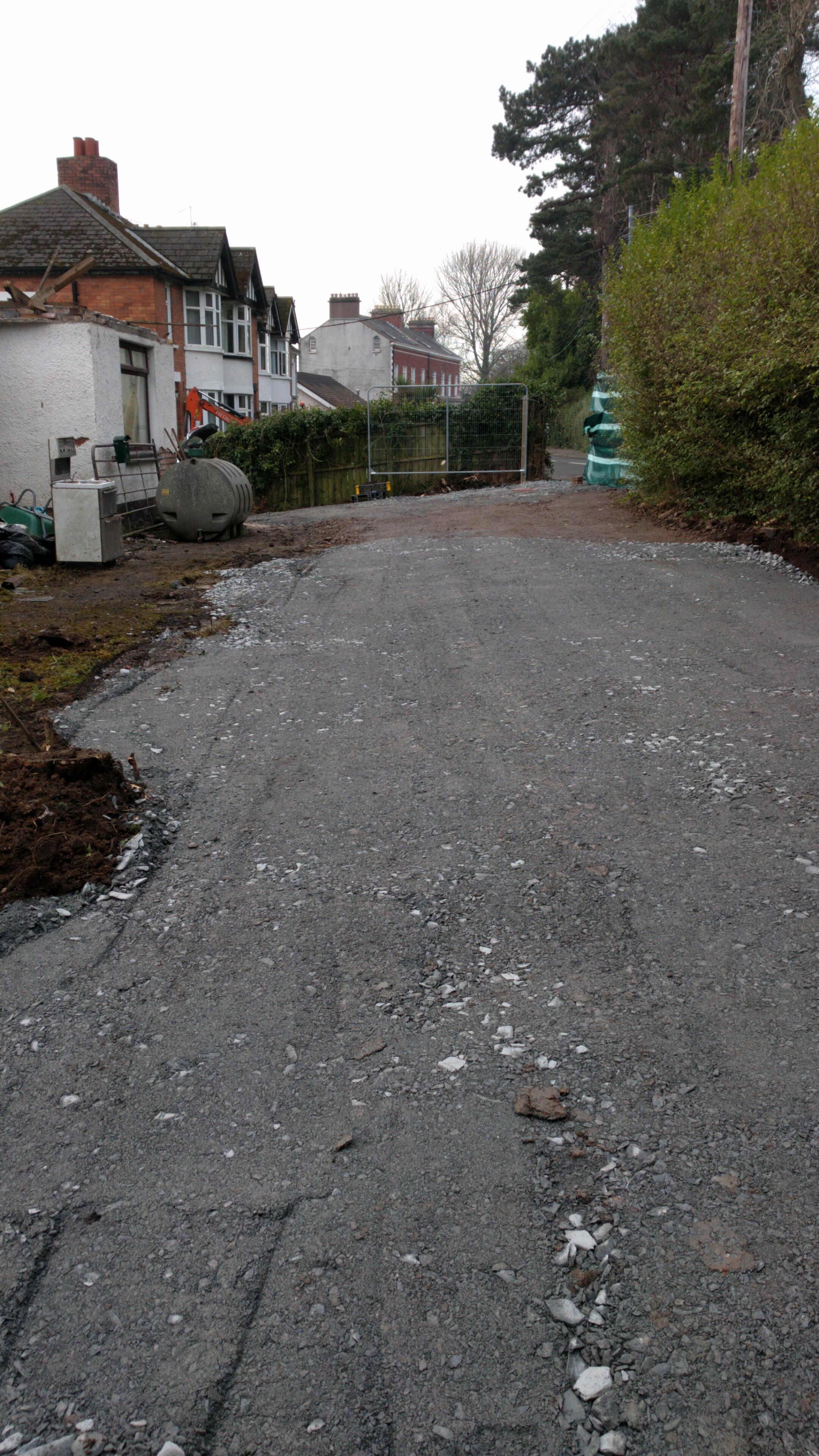

Conor Posted February 3, 2020 Share Posted February 3, 2020 Have a 20ft container arriving tomorrow PM for site storage / workshop duties. I've an area cleared and compacted stones down... But it's far from even. I was thinking of setting down a few 40mm thick paving slabs on the low corners. Would these be up to the job of taking a container that will be full of general tools and materials? How accurate do I need to be with levels? Maybe 4 tonnes in total, not much more. Link to comment Share on other sites More sharing options...

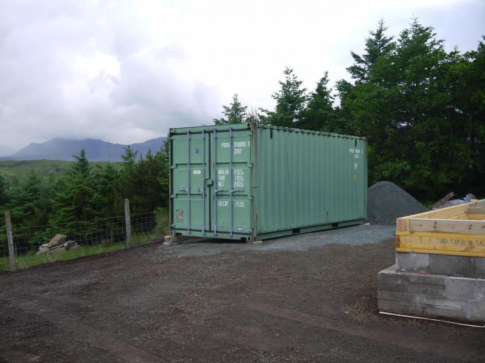

Thedreamer Posted February 3, 2020 Share Posted February 3, 2020 Here is what we did. Mixture of timber and blocks. Link to comment Share on other sites More sharing options...
