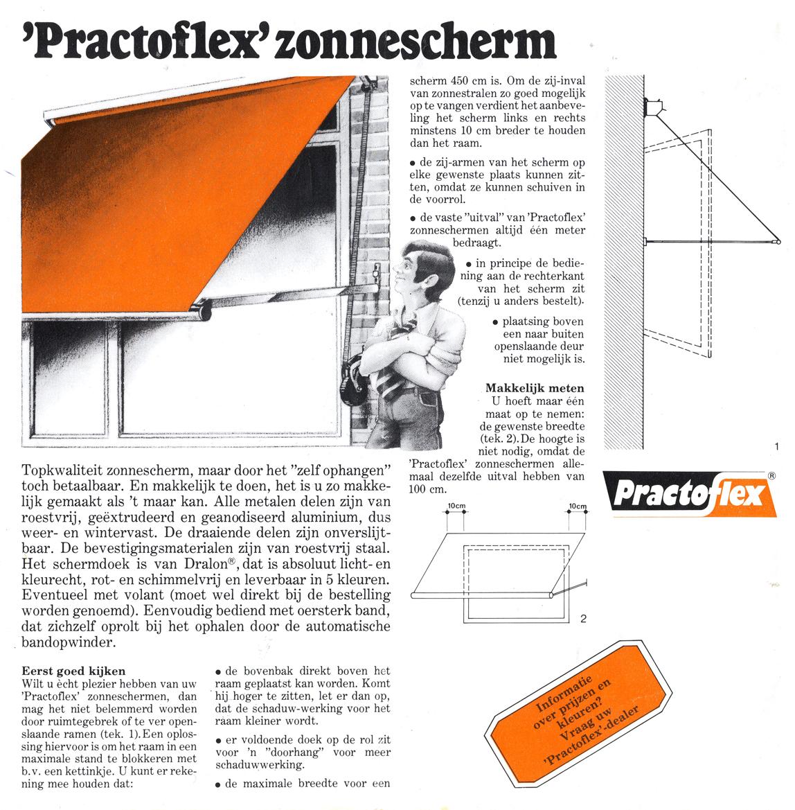

Ha my dad sent me the flier for the awnings.. just as a blast from the past (I want horizontal extending so you can walk under it..)
- Max 450cm wide, should be 10cm wider than the window on each side.
- Dralon anti-mould fabric. Eh. It lasted 'okay' for 60 years..
- Simple 1m rotating area.
  • Like 1
