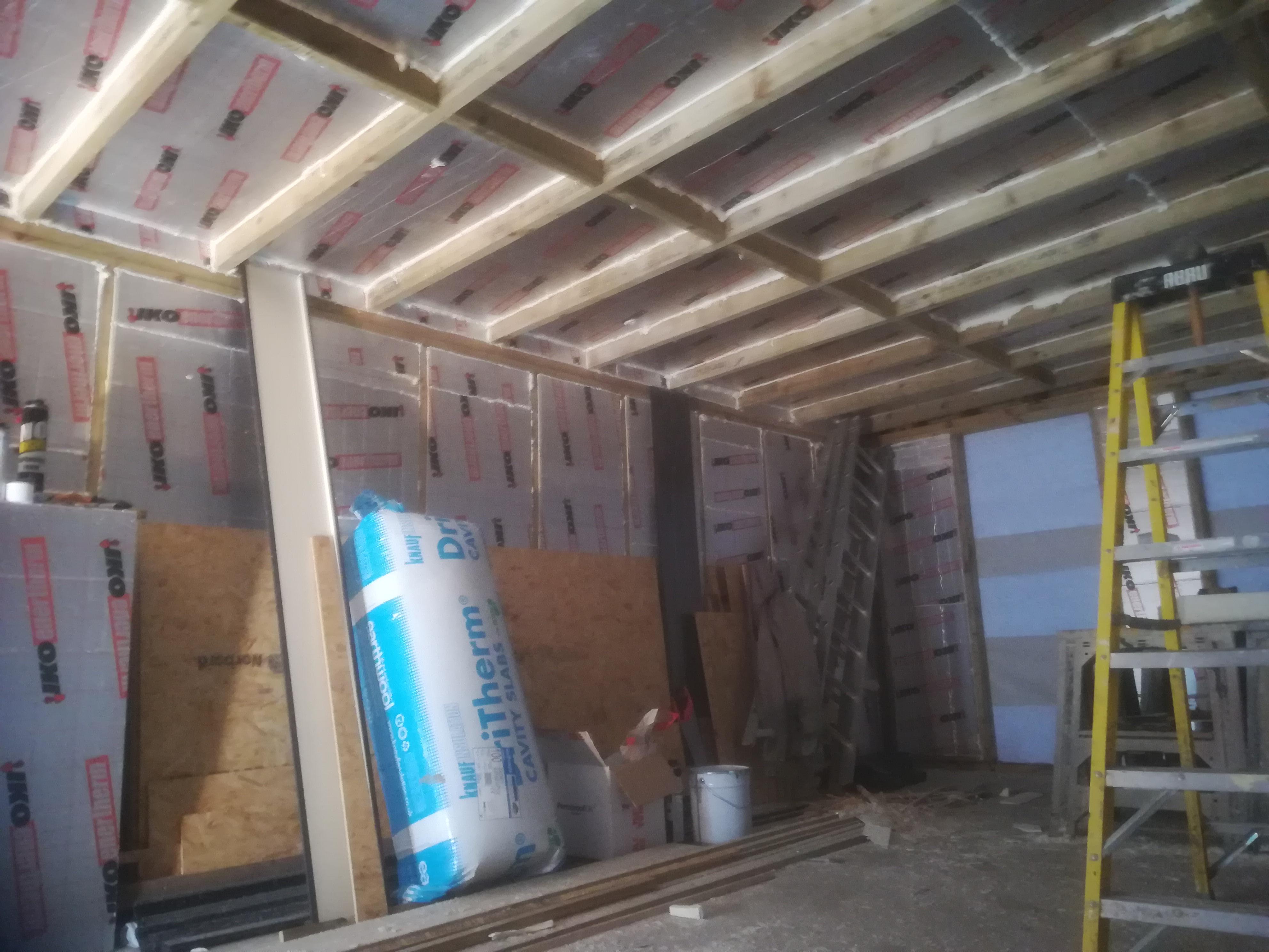

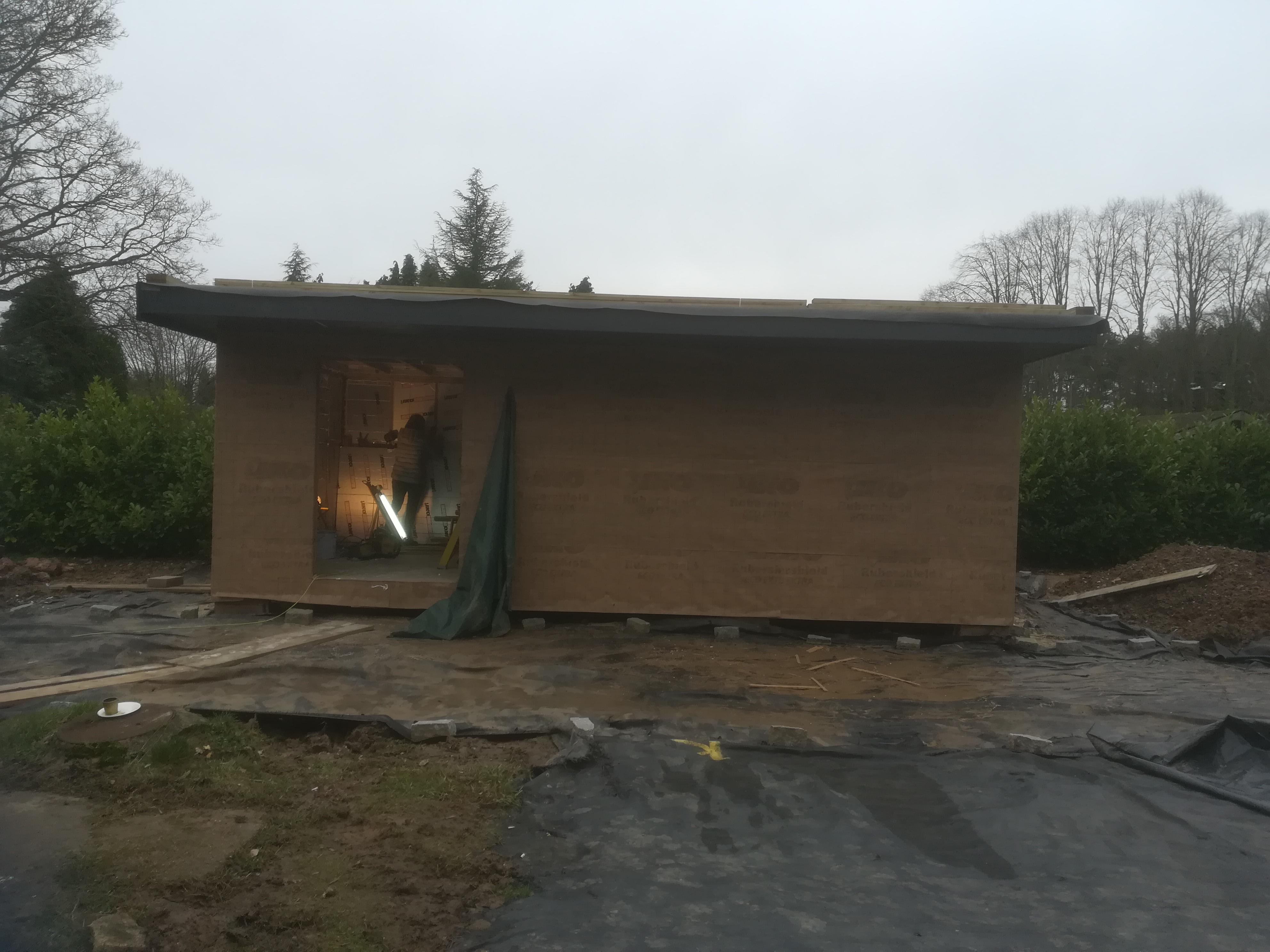

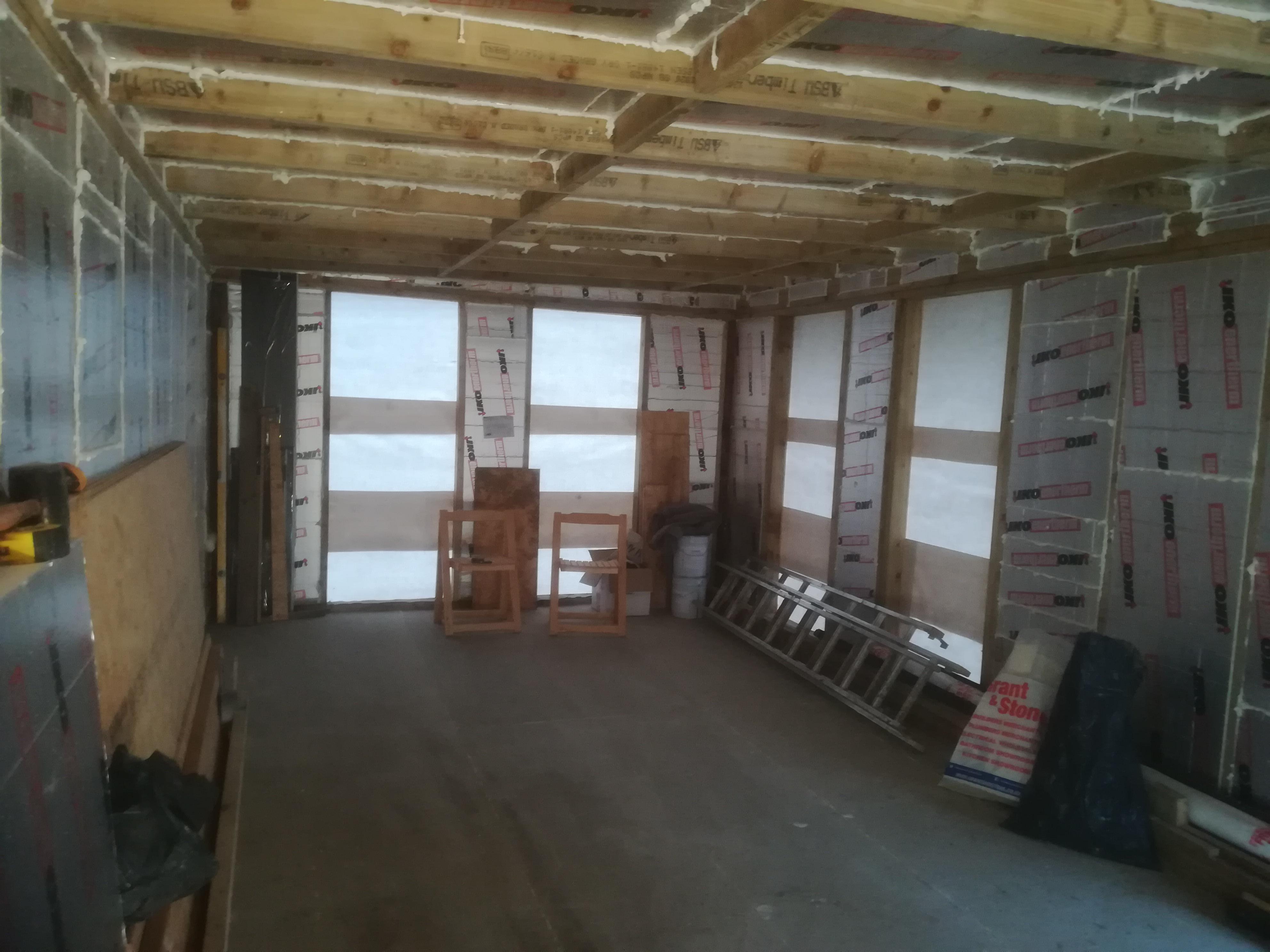

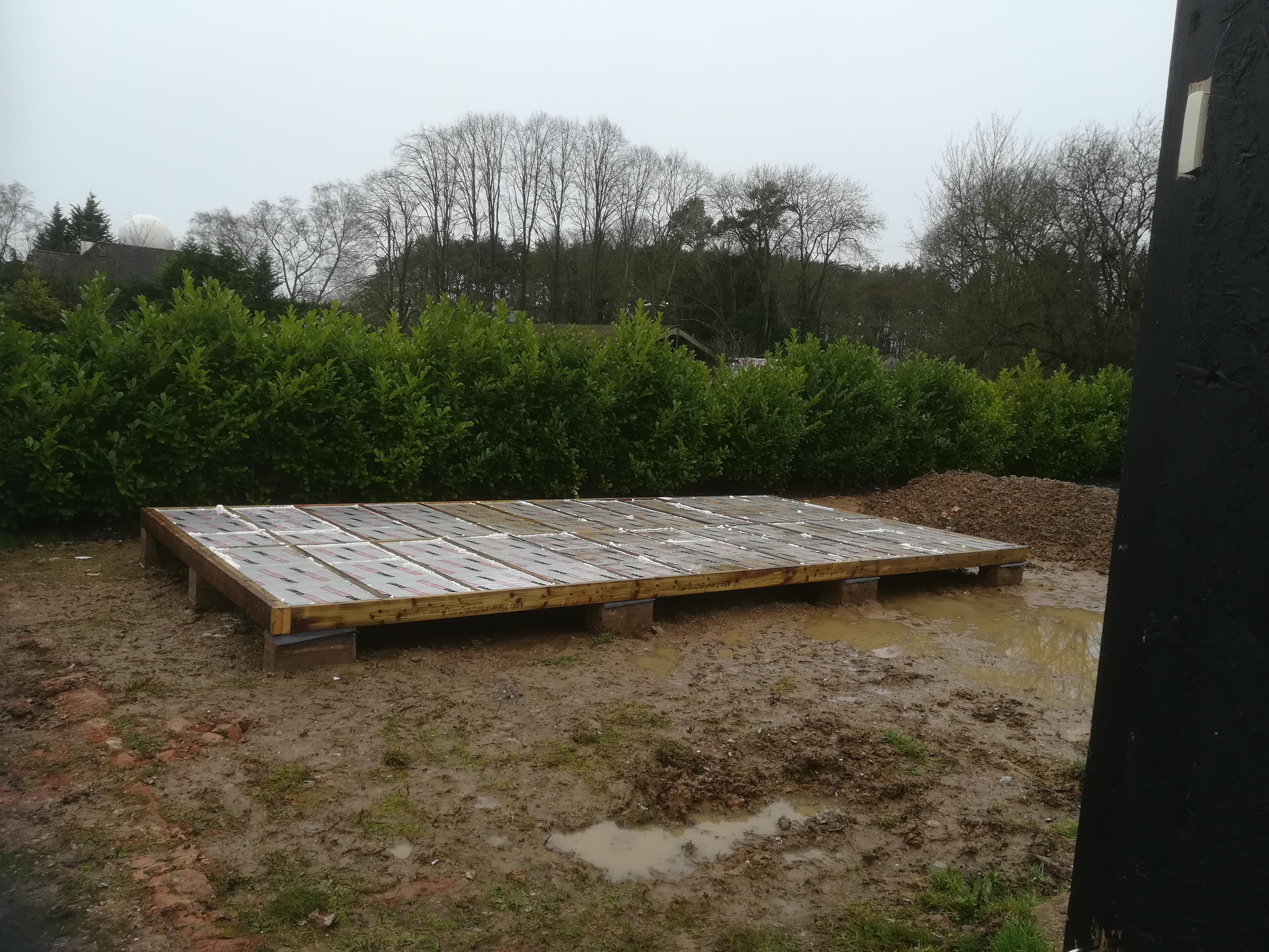

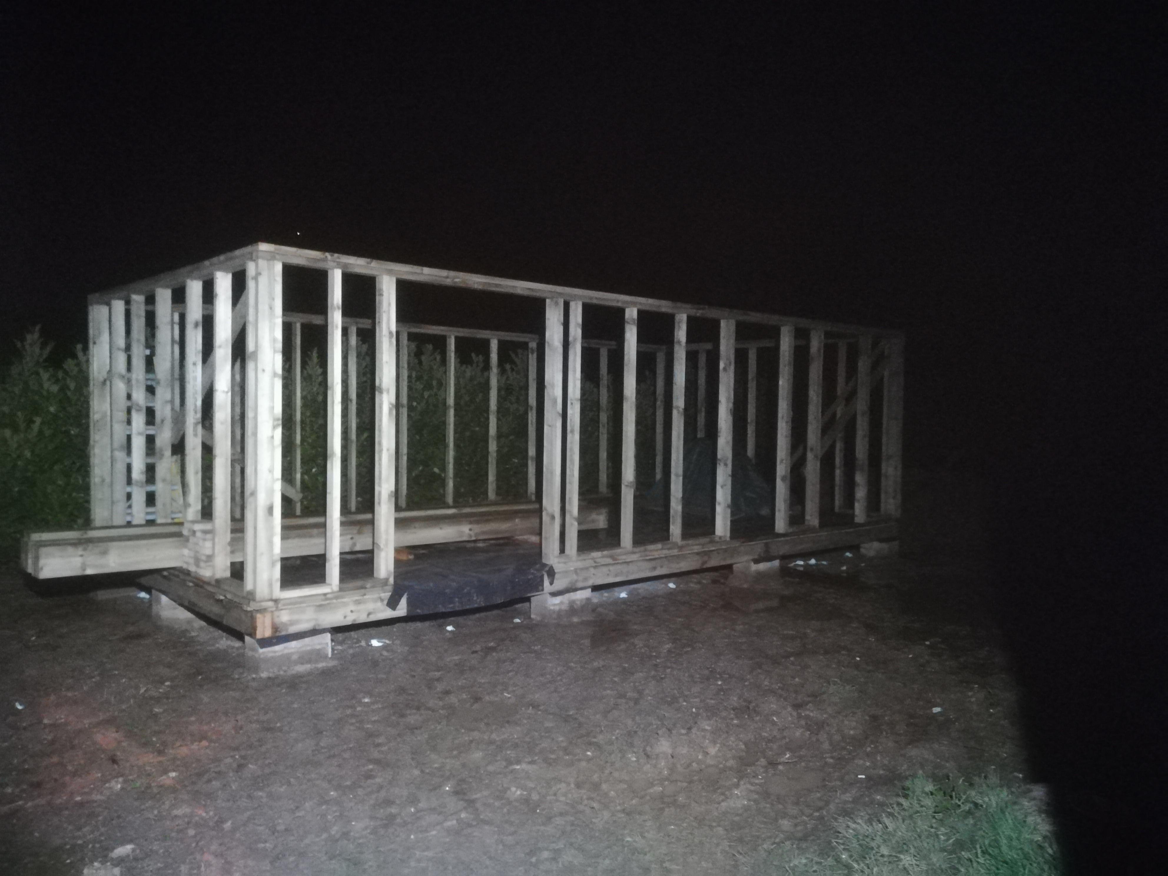

January 30, 20206 yr Author Sorry, I'm totally pants with computers. First pic is my shed base. 12 concrete and block piers, dpm, and 6x2 base frame with 100mm pir insulation between joists. Second pic is 4x2 walls. These have been covered on the outside with 11mm sterling board. The roof is 8x2, Its got 25mm pir over rafters, and 100mm pir inbetween. I was going to use fluffly stuff in the walls, but went with 100mm pir in the end. Next is my mug that my daughter recently got me. finally is my old car which i posted by accident. Sorry. At the moment the roof has got firestone rubber laid over, and weighted down. I'll stick it when the bloody rain allows. Pleased so far
January 30, 20206 yr Your ground looks like the clay I have and just as soggy, good work with your man shed. Can you get the car in it????
January 30, 20206 yr Author 1 minute ago, joe90 said: Your ground looks like the clay I have and just as soggy, good work with your man shed. Can you get the car in it???? The ground can deffo hold bloody water, that's for sure. Nope on the car. The double garage will be coming next. At the moment under a cover out the front? The shed is about 25sq mt
January 30, 20206 yr The pir in the walls was a good call. Any fall on the roof? Could you do a shallow apex? Do you have proper drainage for the WC? Commendable if you do!

January 30, 20206 yr Author 1 minute ago, Russdl said: @Big Jimbo Thanks for the accidental car photo, lovely! Pretty rare as well I suspect? V12? Oh, and the shed's looking pretty damn good as well. Straight Six. 4.2l Daimler made 1600 of them, and about 500+ went sent to South Africa. Mine is a very early one. 72nd one built. I think it may be the oldest surviving one. I have yet to find one earlier. shed, despite the weather is coming on. Garage next for the car.
January 30, 20206 yr Author 6 minutes ago, Mr Punter said: The pir in the walls was a good call. Any fall on the roof? Could you do a shallow apex? Do you have proper drainage for the WC? Commendable if you do! Roof is on now. Flat with a fall to the rear. Covered in rubber waiting to be glued down. Yes, i'm going to put in new drainage for the w.c.
