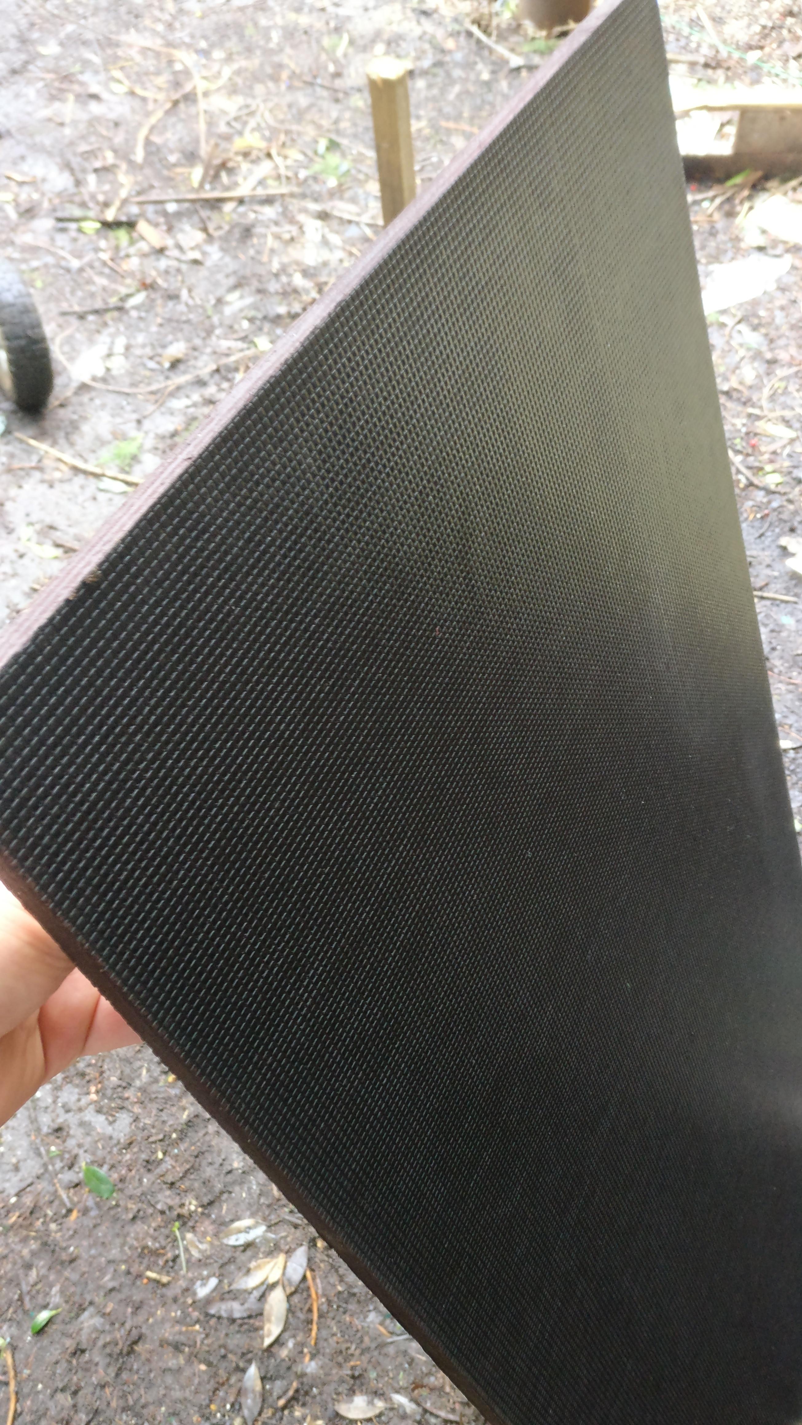

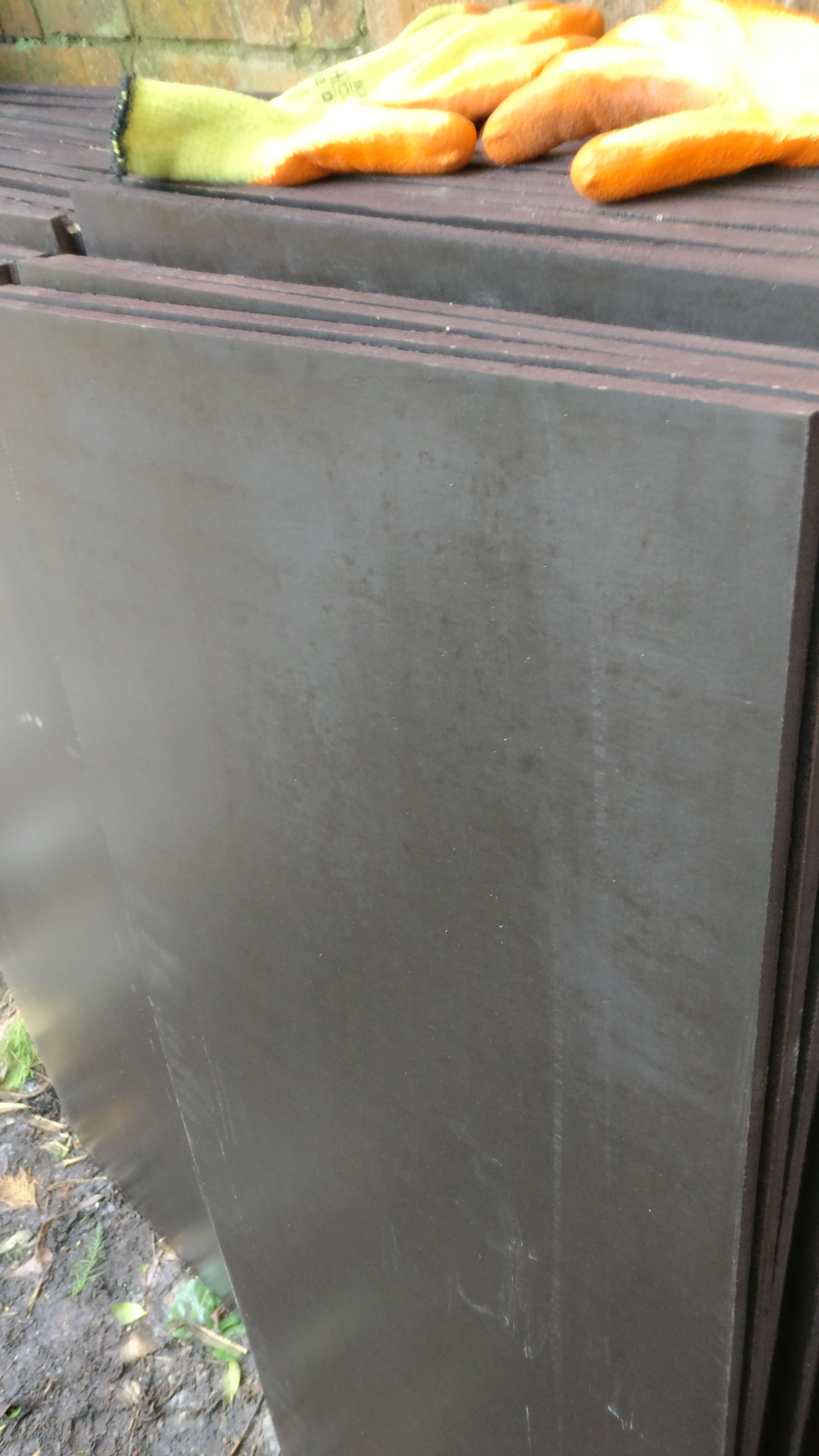

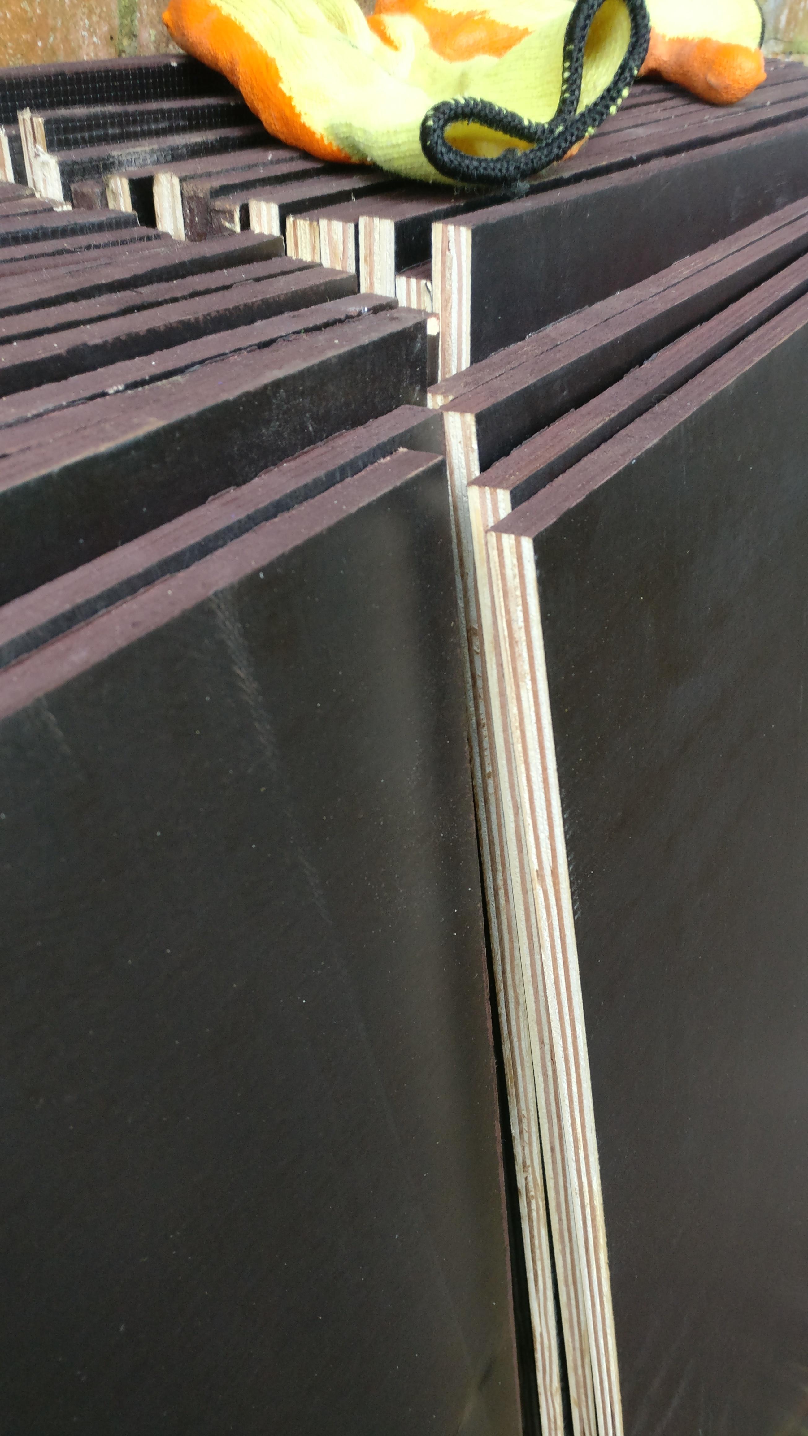

Patrick Posted January 8, 2020 Posted January 8, 2020 I just recently picked up a supply of plywood offcuts for my ringbeam shuttering. It s coated 12mm ply, offcuts with 500mm x 1200mm. Now as I can get them for next to free, I was thinking to do the sheeting of the house, possibly the first floor subfloor, with them. Should be better quality replacing osb with ply. More work involved as basically 4.5 sheets to fix instead of 1 full one. I m currently mainly interested if anybody knows what kind of ply this is. Couldn't really get any details out of the supplier of the offcuts. It s like a slippery plastic coating with 1 side being smooth, the other being kind of mesh. Any downsides of using this instead of OSB.
Moonshine Posted January 8, 2020 Posted January 8, 2020 Riga Trans Birch plywood overlaid with phenol. https://www.finieris.com/en/products/plywood/plywood-with-textured-overlay/riga-trans 1
Temp Posted January 8, 2020 Posted January 8, 2020 Google phenolic coated plywood. Can get it with various patterns on it. 1
Miek Posted January 8, 2020 Posted January 8, 2020 Amazing stuff, almost totally rot proof. Phenolic ply, used for trailer decks. 1
ProDave Posted January 8, 2020 Posted January 8, 2020 And didn't a Grand Designs house use it for just about everything, inside and out?
Temp Posted January 8, 2020 Posted January 8, 2020 14 minutes ago, Patrick said: Any downsides of using this instead of OSB. I would hope that the core is always waterproof plywood but that might not be the case with some grades.. https://www.builderdepot.co.uk/18mm-phenolic-film-faced-shuttering-grade-plywood-2440mm-x-1220mm-8ft-x-4ft After pressing the edges are also sealed to prevent moisture ingress. If cutting is required the exposed edges should be sealed with a rubber based paint in order to prevent any swelling.

Simon R Posted January 8, 2020 Posted January 8, 2020 Hi Patrick, us boaters know this as Bison board (phenolic ply) and it's used for exposed decks on narrow boats. Last for years in the open. A much better product than OSB both in durability and strength. Get as much of it as you can! 1
