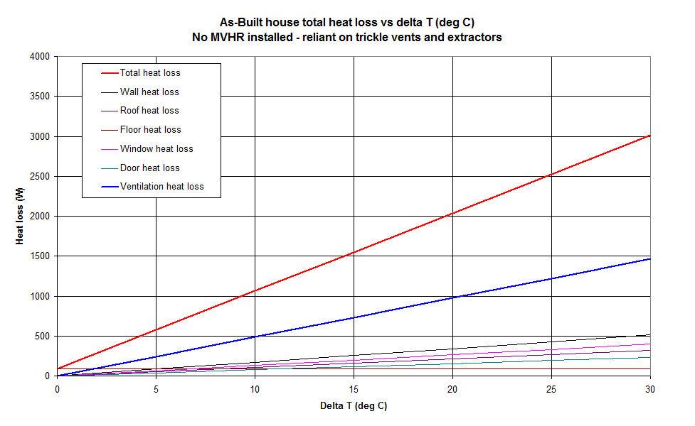

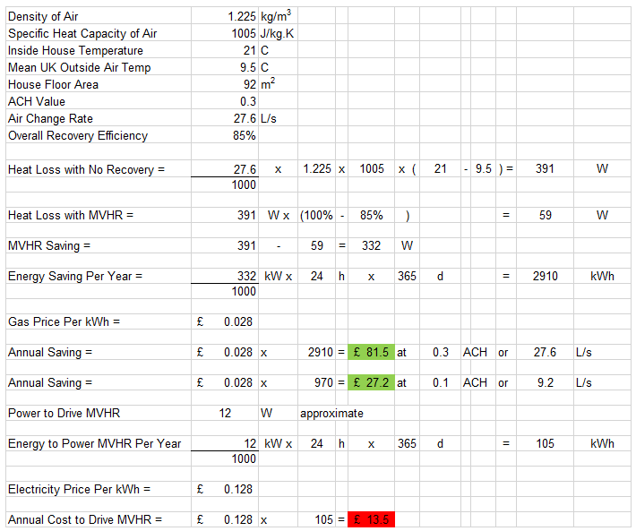

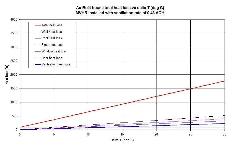

DavidHughes Posted March 21, 2020 Author Share Posted March 21, 2020 I have run my system and reviewed the numbers. My heat flow numbers come out the same as Jeremy's spreadsheet, in fact we have very similar houses. I've worked out the cost/benefit of my MVHR and it's not pretty. See calculations below. The numbers show savings at 0.3 ACH which are bad enough but in reality 0.1 is more than adequate most of the time. These systems will never pay back. My numbers assume a 100% air tight house so the numbers below are a best case scenario. My house isn't 100% but its pretty close. No amount of air tightness improvements will improve the underlying issue. I stand by my first post. Unless you have an air filtering requirement or a damp problem (in which case it would really be better to fix the damp) then don't bother with MVHR, just go with well designed trickle vents and maybe some strong extractors with valves for occasional use. Link to comment Share on other sites More sharing options...
MJNewton Posted March 21, 2020 Share Posted March 21, 2020 You're still missing the point - many (most?) of us are not using MVHR for financial reasons but rather the air quality benefits it provides over and above a passive system (such as trickle vents). Inicdentally, £13.50/yr sounds pretty amazing value to me! Link to comment Share on other sites More sharing options...
Declan52 Posted March 21, 2020 Share Posted March 21, 2020 So not even 4p a day to save some heat but more importantly provide fresh clean filtered air into your build. I will have some of that. Link to comment Share on other sites More sharing options...

ProDave Posted March 21, 2020 Share Posted March 21, 2020 I would be REALLY surprised if your real world energy saving is only £81 per year with the mvhr. Are you taking account of the fact that if you don't fit mvhr you will have to fit trickle vents in EVERY window. You will have to fit an extract fan in the kitchen, utility and every bathroom. Unless you spend a lot of money on those fans, they will be leaking air all the time even when not on. So with all the ventilation you will NEED I suspect your ACH will be a lot more than 0.3 just by fitting all the ventilation that building regs require. Sealing the house up and not fitting mvhr is not an option unless you make other ventilation provision. But do carry on and when it's finished let us know your real life energy bills once you have made all those holes in your house. And let us know if you get any condensation or lingering smells anywhere. For me, mvhr is worth it, not to have anti back draught flaps clattering in the wind, not to have internal doors blow shut when you open an exterior door etc (with a sealed house with mvhr you can open 1 door or 1 window even on a windy day and not have any through draught) Link to comment Share on other sites More sharing options...
Jeremy Harris Posted March 21, 2020 Share Posted March 21, 2020 The basic assumption in Part F is that trickle vents and extraction fans will produce the same degree of ventilation as the background ventilation rate when using a continuous mechanical ventilation system, so the heat loss difference will be just that from the MVHR heat exchanger efficiency (typically about 85%). For our house, I ran the numbers both with and without MVHR, with the same level of ventilation, and these are the results: Link to comment Share on other sites More sharing options...

DavidHughes Posted March 21, 2020 Author Share Posted March 21, 2020 >MJNewton I agree with your comments on air quality but your comments on cost do not stack up. Please don’t conflate the two issues. What I don’t agree with is that you say “£13.50/year sounds pretty amazing value to me!” The true cost is £13.50/day plus say (£2000 DIY + £5000 Installed) / 2, so £3500 amortised over 30 years (which is generous) = 32p/day plus running costs of 4p/day plus filter costs. It is really costing, for even a small system 35-40p/day. >Declan52 “So not even 4p a day” See my comments to MJNetwon >Jeremy Harris >Frankly I'd pay a lot of money to run the thing just to get the air quality benefit. You are a) paying a lot of money and b) getting an air quality benefit. My comments are so that everyone understands what they are getting for their money. Also, your spreadsheet and graphs are very good and I think accurate but nowhere do you evaluate the cost. This is my only issue. >Joe90 >Just had a shower, MVHR came on boost automatically to reduce RH and it will go off automatically when it gets back to normal. No trickle vents to create cold draughts, what’s not to like. All good, but what you say has nothing to do with cost/benefit, and this is the central theme of my post. One could say “I really like my house because it has a huge central heating system for winter and a magnificent aircon system for summer” >ProDave >I would be REALLY surprised if your real-world energy saving is only £81 per year with the mvhr. Those are the numbers which I have calculated and I have more than 10 years of experience running these system, that’s the simple house heat numbers, I invite you to prove me wrong with data rather than conjecture. >Are you taking account of the fact that if you don't fit mvhr you will have to fit trickle vents in EVERY window. You will have to fit an extract fan in the kitchen, utility and every bathroom. Unless you spend a lot of money on those fans, they will be leaking air all the time even when not on. Most windows which require them (like bedrooms) already have them. Fitting extra trickle vents in walls is very simple and not expensive compared to an MVHR. Most bathrooms already have extractor fans, which cost £30-50 for a good one and already have flap valves when they are off but are still a bit leaky but are not that bad. Could be improved. For the two years before I fitted this system, I had largely given up on turning the shower extractor on because there was no damp problem and the ensuite cleared within about 15 min due to the slightly leaky flap valve on the old extractor. >So, with all the ventilation you will NEED I suspect your ACH will be a lot more than 0.3 just by fitting all the ventilation that building regs require. I have measured my needs based on damp control (not an issue at all in my house) and CO2 monitoring. Both are comfortably satisfied by 0.1 ACH, in fact over the last few months I have dropped it to 0.075 based on C02 monitoring. If there were a few more people I would up it to maybe 0.15 ACH, or, as I do press button 2 on the controller for 0.3 ACH with cooking and guests. My master bedroom reads 750ppm CO2 in the morning against a background of 400 ppm and a house average of 550 ppm when occupied by two people indoors all day. And for example, a school maximum recommended is 1500 ppm. Again, I ask you to present facts rather than conjecture. >Sealing the house up and not fitting mvhr is not an option unless you make other ventilation provision. That’s obvious, my house is, what’s your point? >But do carry on and when it's finished let us know your real-life energy bills once you have made all those holes in your house. And let us know if you get any condensation or lingering smells anywhere. I have been running this house on MVHR for 6 months over a stormy wet winter. I have had no problems. I have now ‘let you know’ - Please comment. >For me, mvhr is worth it, not to have anti back draught flaps clattering in the wind, not to have internal doors blow shut when you open an exterior door etc (with a sealed house with mvhr you can open 1 door or 1 window even on a windy day and not have any through draught) These are trivial/non problems. If your flaps are banging then put a put a bit of rubber trim on them. I had the same problem on my last house in an elevated position in the Mendips and the rubber trim sorted it. Even then it needed very high winds to cause the problem. Are you seriously suggesting that one spends thousands of pounds to not have an open-door slam in high winds or flaps clatter? >Simply Simpson >what are they? does a trickle vent move the air where it is required to avoid the build-up of condensation and therefore mould growth? mvhr supply is in the opposite corner to the extract and will move more air from across the room. They are vents in the walls or the windows, commonly built into double glazing units for many years now. If you wish to use them instead of MVHR then you need to place another vent on the other side of the room or in an adjacent room through the ceiling. Thermo-syphoning (hot air rises) will do the rest. You don’t need that much flow, see previous comments. If you do need to control damp, maybe you should look at the damp problem first, MVHR is expensive. <Jeremy I think you are clutching at straws here, however… <Trickle vents have a very highly variable flow rate, from near zero on a still day (so almost no ventilation) to a very high flow rate when extraction fans are running. Then just open the windows in summer, that’s what everyone else does! >Noise was one of the main problems we had. In two of the three houses we've lived in with trickle vents they howled like a banshee with the wind in a particular direction. Get better vents. Also are you seriously saying that in high winds you can’t hear wind noise from anywhere else in the house? I don’t think so. >Dirt was another issue; they produce dirty smears where dirt and cobwebs get pulled in around them. That’s valid but dirt accumulates all over the house from all sorts of sources, the house always needs cleaning. An MVHR will not stop the general cleaning requirements on a house. David Hughes Link to comment Share on other sites More sharing options...
