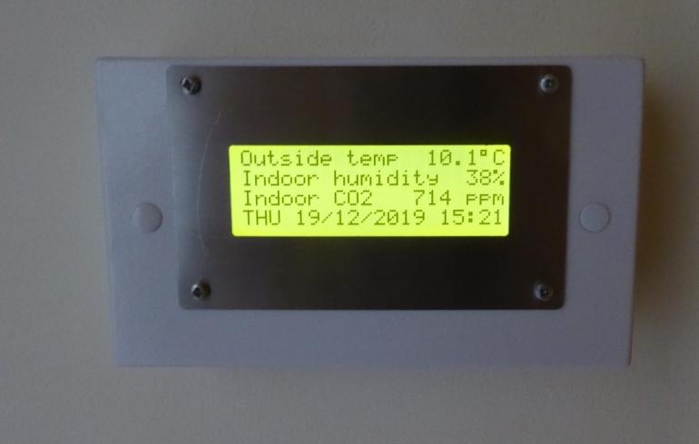

Jeremy Harris Posted December 19, 2019 Share Posted December 19, 2019 36 minutes ago, DundeeDancer said: With the MVHR system on low the CO2 levels were around 900ppm which were decent. It's a nasty, wet, day here, and we've been shut indoors all day, not even gone outside once, so all doors and windows have been shut tight since yesterday. Just taken this 'photo of the hall display from the house monitoring/data logging system: That CO2 level is around 100ppm higher than we normally see, most probably because the MVHR hasn't been on boost since around 08:00 this morning, and because neither of us has been out of the house. If I started seeing levels as high as 900ppm then I'd be looking to find out why they had risen so high. We find that the CO2 level tends to fluctuate between about 450ppm up to about 800ppm, but never much higher than that. The outside CO2 level here seems to be about the global normal concentration ~420ppm. By way of contrast, this plot was from a logger placed in the bedroom of our old house, with a small window left permanently open for ventilation: 2 Link to comment Share on other sites More sharing options...

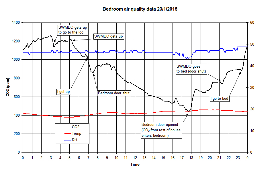

DundeeDancer Posted December 19, 2019 Share Posted December 19, 2019 31 minutes ago, Jeremy Harris said: If I started seeing levels as high as 900ppm then I'd be looking to find out why they had risen so high From what I've read 800-900ppm is about ideal in that it means the room is not being over ventilated. I haven’t got my figures to hand but in my current bedroom if we sleep with the door closed then by around 7am in the morning the ppm will be around the 2000 mark. Also if it is cold outside say under 4c then the windows will covered in condensation. With the door open all night it will average around 1500ppm at 7am which doesn’t feel to uncomfortable. Not that long ago the wife and I went and stayed in a posh hotel up in the Highlands, was a bit of a drive to get there but when we did I had a little lay down on the bed and before I knew it I was snoozing and very doozy. I then looked at my CO2 monitor I thought it must be faulty as was reading about 3,500ppm. The room couldn’t have been ventilated from the night before and the lack of oxygen was making me sleepy. ? Link to comment Share on other sites More sharing options...

Jeremy Harris Posted December 19, 2019 Share Posted December 19, 2019 On 19/12/2019 at 16:12, DundeeDancer said: From what I've read 800-900ppm is about ideal in that it means the room is not being over ventilated. I haven’t got my figures to hand but in my current bedroom if we sleep with the door closed then by around 7am in the morning the ppm will be around the 2000 mark. Also if it is cold outside say under 4c then the windows will covered in condensation. With the door open all night it will average around 1500ppm at 7am which doesn’t feel to uncomfortable. Not that long ago the wife and I went and stayed in a posh hotel up in the Highlands, was a bit of a drive to get there but when we did I had a little lay down on the bed and before I knew it I was snoozing and very doozy. I then looked at my CO2 monitor I thought it must be faulty as was reading about 3,500ppm. The room couldn’t have been ventilated from the night before and the lack of oxygen was making me sleepy. ? @DamonHD (used to be on here for a time, but haven't seen him for ages) looked into this in depth some years ago, in the context of the school environment and the impact of CO2 concentration on the learning performance of children. IIRC, his findings (supported by some reasonably good science) were that learning performance started to fall off at concentrations above about 800ppm. That's not surprising, as we evolved to live in an environment with a CO2 concentration of less than 300ppm. From what I can recall of the aeromedicine stuff that was drummed into me at regular aeromedical and safety training school refreshers, the lower the partial pressure of CO2 in the air we breathe, the better our lungs are at expelling the stuff as a waste product. The rate at which CO2 diffuses from our blood stream to the air in our lungs is pretty much wholly dependent on the partial pressure of CO2 in the air, and that partial pressure is in turn proportional to the CO2 concentration. Arguably there is no optimum level of CO2 as far as our bodies are concerned, it needs to be as low as possible, and the closer we can get the internal CO2 level to that outside the better, as that global CO2 concentration is already a lot higher than it was just 50 or 60 years ago (in 1960 it was less than 320ppm, now it's around 420ppm). 1 Link to comment Share on other sites More sharing options...
