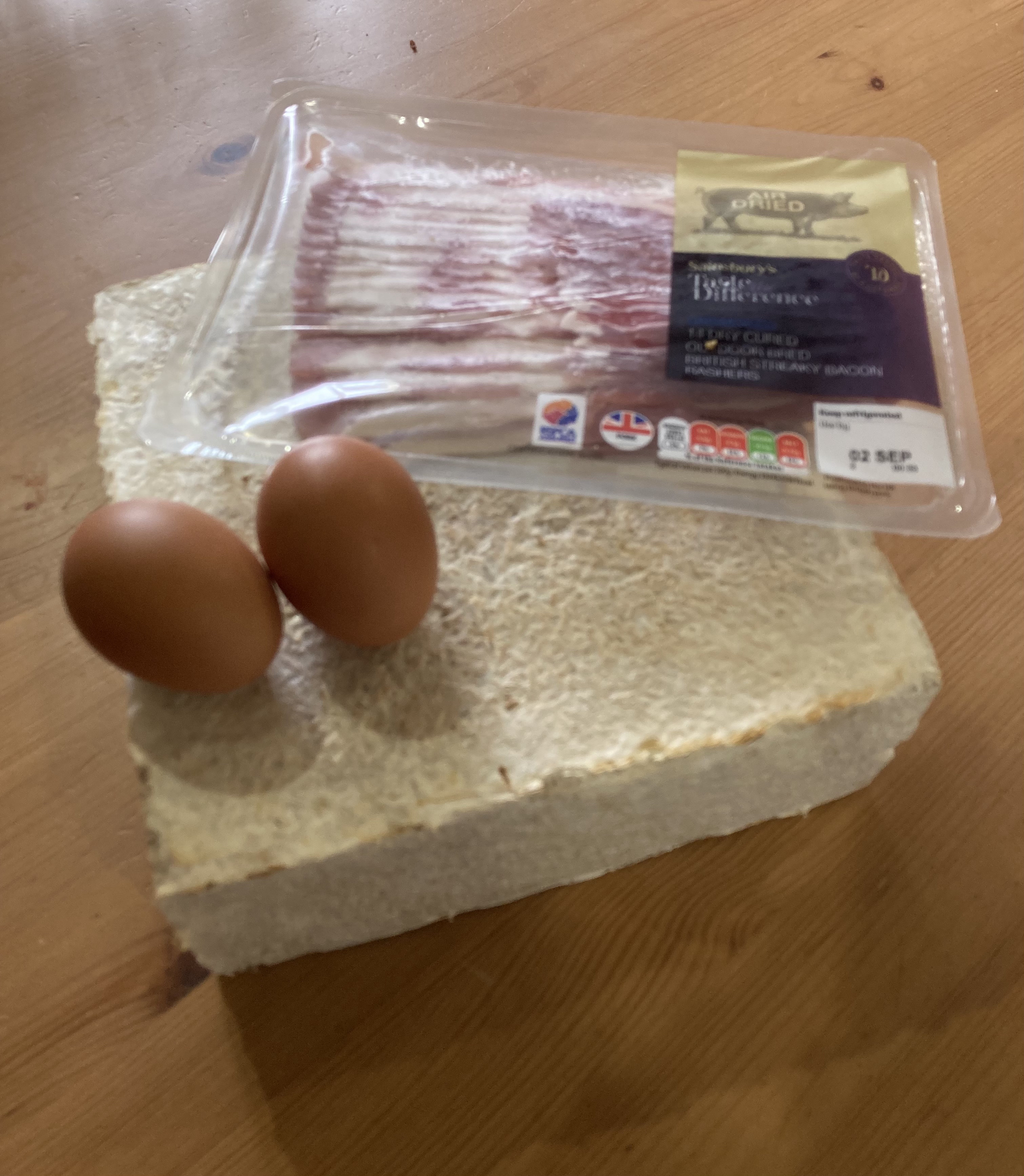

14 minutes ago, jack said:
Funny you say that. Research is being done into using mycelium (the substrate that supports mushrooms) for all sorts of things, including insulation panels.
I have a sample of mycelium on my desk  - I'm looking at using it to make SIP panels
