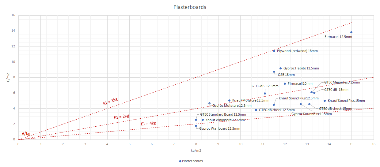

Visti Posted November 17, 2019 Author Posted November 17, 2019 (edited) On 14/11/2019 at 10:50, Moonshine said: If you are only looking to get an equivalent level of acoustic performance from the OSB, then look at getting a similar surface density from the liner board, below is a link to the surface density of many plasterboard sheets. If you are using standard 12.5mm Gyproc wallboard thats 8.0 kg/m2, the OSB / ply thickness should be matched to this surface density. OSB has a density of around 640 kg/m3, you will need min 13mm boards to give you a surface density of 8.3 kg/m2 @Moonshine - doing a review on the £/kg and it looks like the no brainer if going for acoustic performance is bog standard wallboard at 4.52 kg per £ I may as well double up on standard board which will give me a surface density of 16 kg/m2 at £3.53 per m2. That is a full pound pound cheaper per m2 than the most economical soundboard GTEC dB check, and gives an extra 3kg/m2 to boot. Why have soundboard at all? Is it a question of labour? @Nickfromwales - 100% correct on ply... a very expensive approach. I'll be doing it strategically as recommended Edited November 17, 2019 by Visti spelling 4

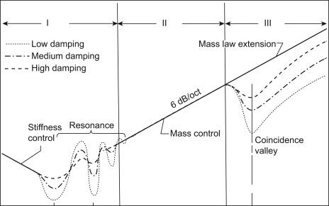

Dreadnaught Posted November 17, 2019 Posted November 17, 2019 A very clear presentation, @Visti! Very helpful. Is your logic correct: does a board of a given density provide the same acoustic attenuation as double the amount of board of half the density? In other words, is kg/m² linearly proportional to acoustic attenuation, and across all wavelengths? As your research continues, I would be interested to know your view on using resilience bars? If you choose to use standard board, will you therefore be wet skimming with plaster too?

Moonshine Posted November 17, 2019 Posted November 17, 2019 (edited) 1 hour ago, Visti said: @Moonshine - doing a review on the £/kg and it looks like the no brainer if going for acoustic performance is bog standard wallboard at 4.52 kg per £ I may as well double up on standard board which will give me a surface density of 16 kg/m2 at £3.53 per m2. That is a full pound pound cheaper per m2 than the most economical soundboard GTEC dB check, and gives an extra 3kg/m2 to boot. Why have soundboard at all? Is it a question of labour? @Nickfromwales - 100% correct on ply... a very expensive approach. I'll be doing it strategically as recommended Interesting graphs, and I agree that the 'acoustic' in a name does give a up lift in cost when it's the density you are really getting. High density boards are needed as they offer the higher acoustic ratings needed in some situations (e.g. trying to meet ADE conversation requirements on a timber floor with limited floor to ceiling space). Also as you say labour, people will start looking at you funny if you start asking for triple boarding, when you could do it in a double layer of SoundBloc. @Dreadnaught in simple terms a single skin partition with double the density will increase the sound insulation by 6 dB In the mass control region, but maybe more like 4-5 dB when considered throughout the whole frequency range. See below Edited November 17, 2019 by Moonshine 2

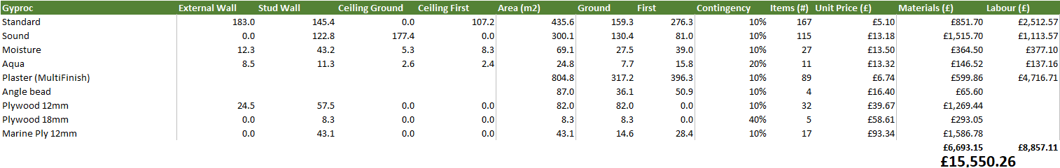

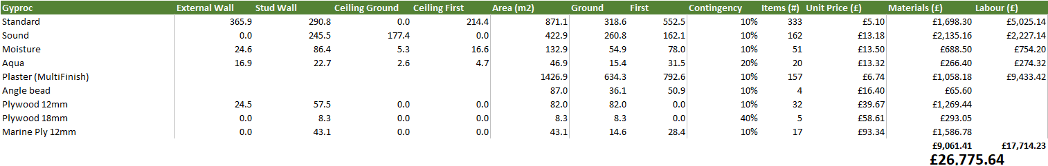

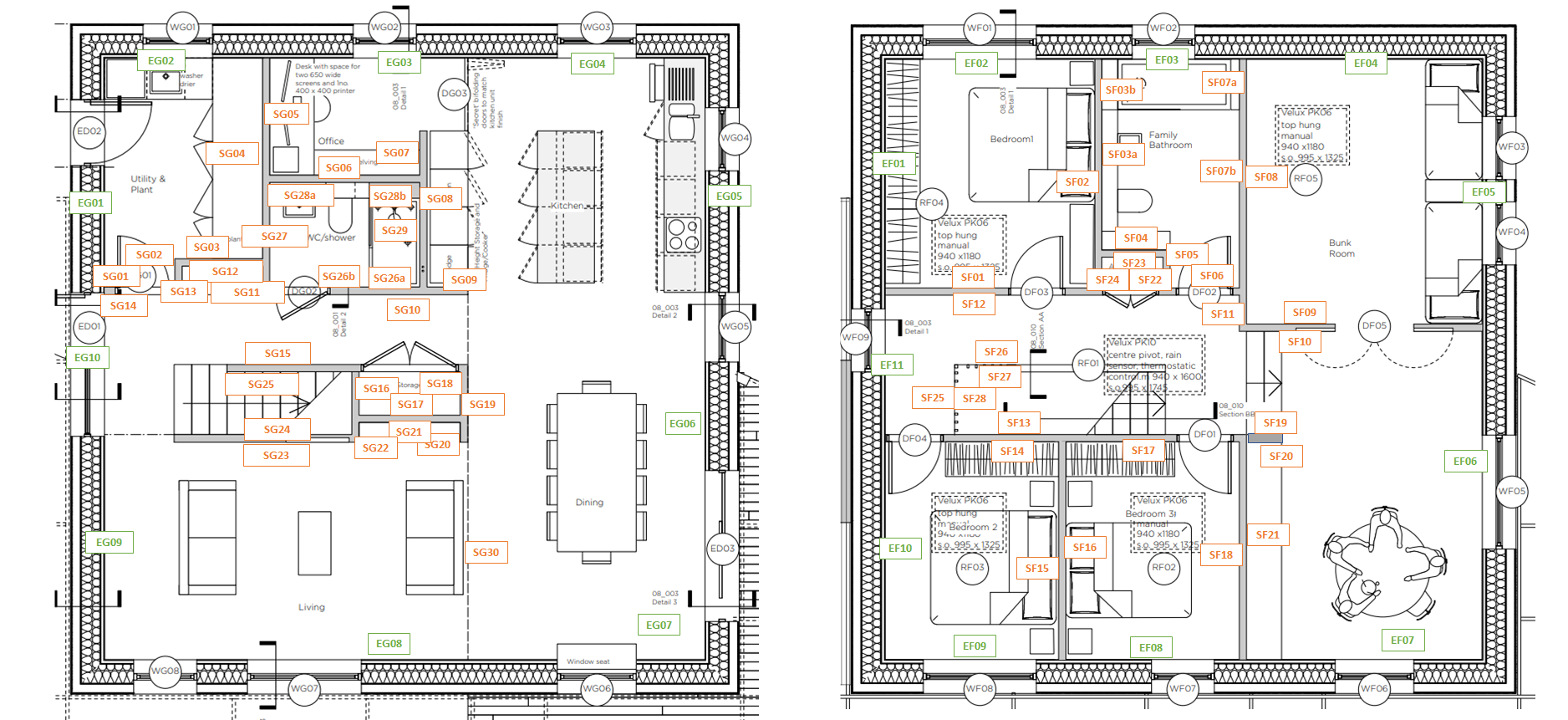

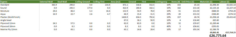

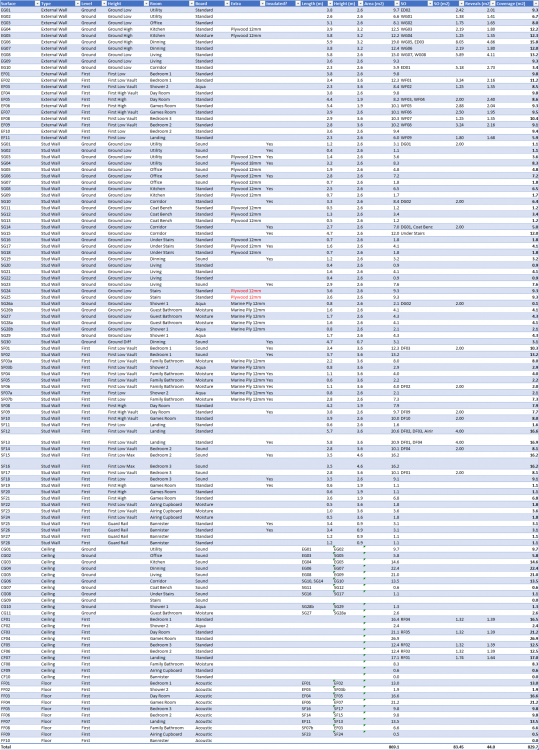

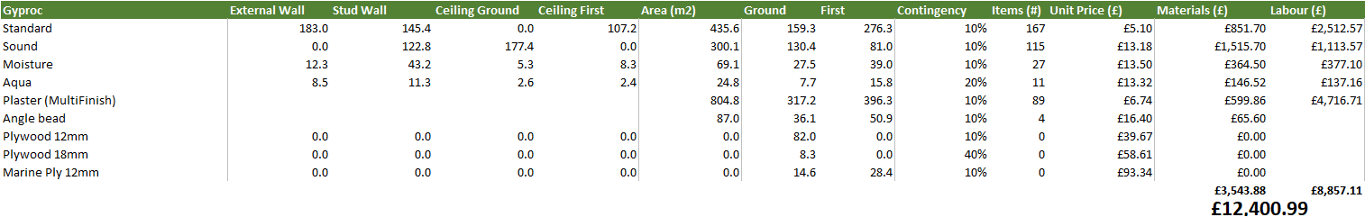

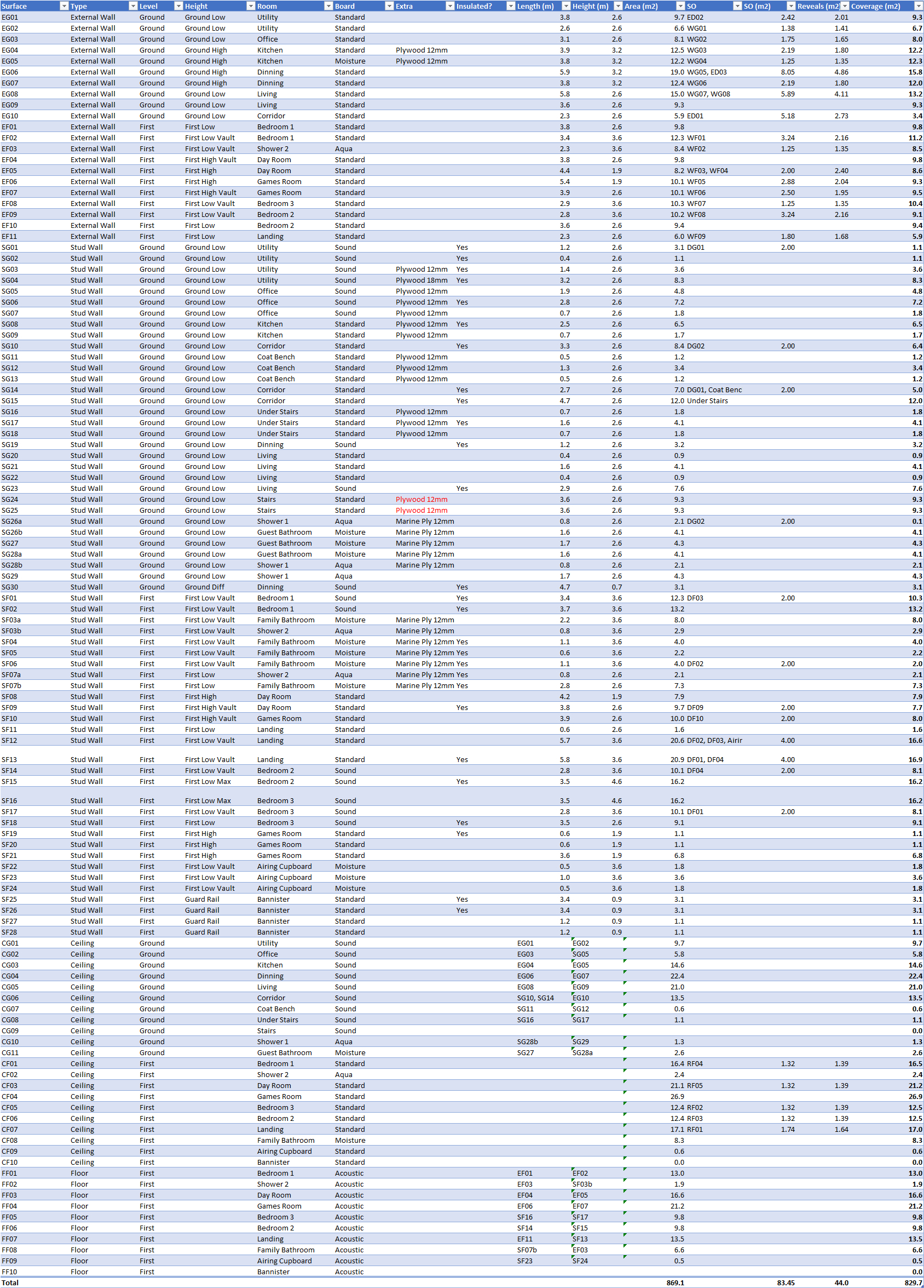

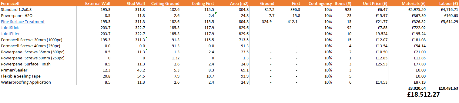

Visti Posted November 21, 2019 Author Posted November 21, 2019 (edited) So I did the number crunching, and it looks like there is actually a good case for Fermacell if you can find a good supplier (found at £6.47/m2, making it £2.22/kg. only slightly worse than standard soundboards in my last chart). 1. Label every wall... 2. Take all the measurements... 3. Calculate labor and materials cost per m2... I've got quotes coming in at 25-33k (Double Plasterboard) - so not far off! Using only standard board I'd save ~£2k in materials. 4. Get a decent quote for Fermacell materials from here ... This is for a single layer of fermacell, equivalent density as doubled up gyproc wallboard. The labour is also an additional £1/m2 for installing these boards. The contractor also quoted more for applying the Fine Surface Treatment than skimming. 5. But what if I did just a single layer of standard wall board... This is half the density of the above except at the ground floor ceiling, and limits fixings to just areas with planned noggins or plywood backing. Using only standard board I'd save ~£1k in materials. 6. and what if no plywood backing at all... Probably the cheapest it'd get unless all the sound board was replaced with the standard board to bring it down to £11.5k. Edited November 21, 2019 by Visti 3
Visti Posted November 21, 2019 Author Posted November 21, 2019 I think it comes down to value for money. The standard single layer of wallboard is cost effective, but personally it doesn't sit right with me.. neither acoustically and quality wise (I'm big, clumsy and have many holes/dents punched through and patched in my current home). The plywood backing also adds a lot of cost to enable fixings to handpicked areas. If I double up for quality, fermacell is just a far more cost effective way as it doesn't double up on labor. Doubling up also still doesn't address the fixing issue, where as fermacell will allow me to do it anywhere. I might also have found a willing laborer to do it at much more favorable rates too...

Russdl Posted November 25, 2019 Posted November 25, 2019 Great research and detail there @Visti. I see that you've specced the Powerpanel H2O in the Fermacell table. Any specific reason for that? My understanding was that the standard Fermacell board, plus a waterproofing treatment, was suitable for domestic bathrooms/kitchens. Is the waterproofing treatment not required on the Powerpanel and therefore it works out cheaper?
Visti Posted November 25, 2019 Author Posted November 25, 2019 2 hours ago, Russdl said: Great research and detail there @Visti. I see that you've specced the Powerpanel H2O in the Fermacell table. Any specific reason for that? My understanding was that the standard Fermacell board, plus a waterproofing treatment, was suitable for domestic bathrooms/kitchens. Is the waterproofing treatment not required on the Powerpanel and therefore it works out cheaper? I over spec'd I guess. I saw that standard board could be used, so I may do that instead in my next revision. On 21/11/2019 at 22:44, eandg said: I can't read any of that from my phone but in any case I'm feeling very inadequate. Replying to compliment your work and for ease of reference if I shame myself into undertaking that level of detail/control. It is more a representation of feeling out of control! I always do this (engineering background) so that I can feel like I am making an informed decision... I am not sure whether the results are improved following a week of evening spreadsheet of good advice @ProDave, I think that is generally the way to go. I may also get a spare box of fermacell screws for other jobs in case. 1

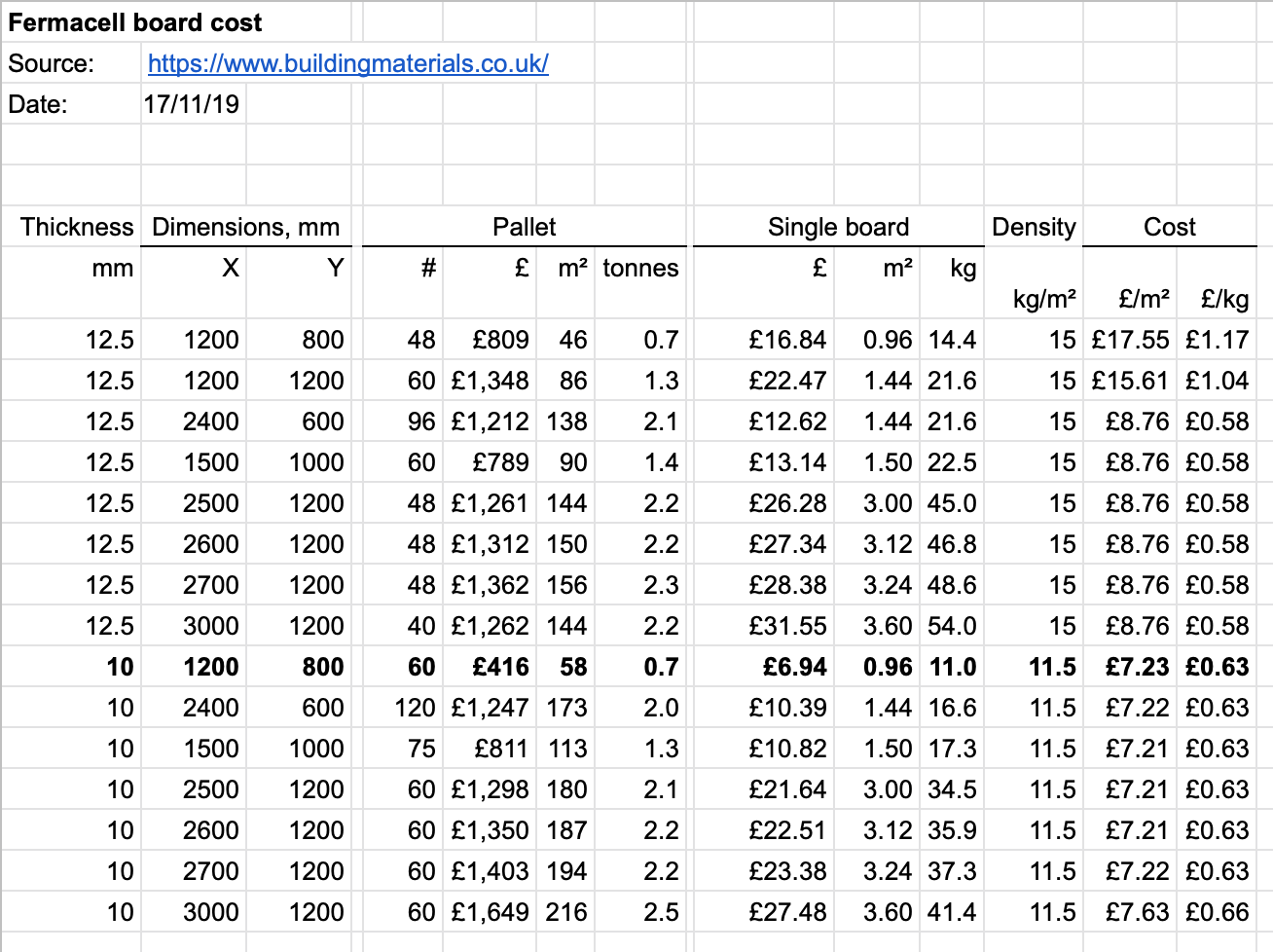

Dreadnaught Posted November 25, 2019 Posted November 25, 2019 (edited) I looked recently at Fermacel prices and prepared a small spreadsheet (see next post). I concluded that 10mm boards were probably the best option from weight and cost. And then I could double-up in locations that required higher sound attenuation. That way I could just buy a single board for use everywhere. The optimum board size and cost was: 1200 x 800 x 10 at 11 kg per board and £7.23 per m². A pallet of such boards was: 60 boards at 0.7 tonnes, so I am maybe thinking of getting them on the slab before the frame goes up (!) Interestingly, the one-man boards in 12.5 mm were much more expensive per m² as I assume they are a special order item. Edited November 25, 2019 by Dreadnaught
Visti Posted November 25, 2019 Author Posted November 25, 2019 55 minutes ago, Dreadnaught said: Here are the numbers I prepared: Encon. Same size at 12.5mm I am getting quoted £6.48/unit, Inc VAT. That is 6.75 £/m2, nearly 50p cheaper. How many units you ordering? I'm at about 930 so volume may make a big difference.
Russdl Posted November 25, 2019 Posted November 25, 2019 29 minutes ago, Visti said: Same size at 12.5mm @Visti, I presume you’re referring to the highlighted 1200x800 10mm board? Unless I’ve read @Dreadnaught‘s table incorrectly your quote is way way more than 50p cheaper. It’s over £10 cheaper. I’ve had a very similar quote price from Encon for the 12.5mm board, regardless of the size of board.
