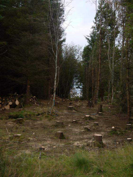

Thedreamer Posted November 1, 2019 Posted November 1, 2019 We remove 100 trees or so to create an access. Chainsaw/axe work was done by my father law and me and I then burnt the foliage pretty much non stop for over two or three days. The stumps were pulled out with a hook attachment on our ground worker's excavator. Even large stumps were easily removed this way. The firewood was stored to season as of yesterday I now have a commissioned stove to burn it in. We have replaced the cut spruce with some oak trees which are developing well. 1
Mulberry View Posted November 1, 2019 Author Posted November 1, 2019 56 minutes ago, Thedreamer said: We remove 100 trees or so to create an access. Chainsaw/axe work was done by my father law and me and I then burnt the foliage pretty much non stop for over two or three days. The stumps were pulled out with a hook attachment on our ground worker's excavator. Even large stumps were easily removed this way. The firewood was stored to season as of yesterday I now have a commissioned stove to burn it in. We have replaced the cut spruce with some oak trees which are developing well. That's an impressively sized project. Pales mine into relative insignificance. Good work and very reassuring. 1
