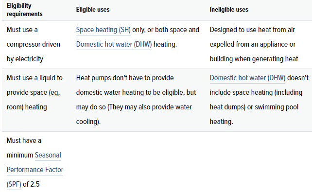

joth Posted December 7, 2019 Posted December 7, 2019 (edited) Latest RHI myth or little known fact: heatpumps are limited to max 65°C to be eligible for RHI payments. Limit applies to heating and DHW Was told this by a certified installer, but I can't find any reference for it. If it's in the MCS rather than RHI guidelines, it would also impact ability to install them under permitted development. If true, it would be a significant impact on take up of these higher temp heat pumps, or using sunamp PCM58 with a heatpump. Interested if anyone else has ever heard of this? Edited December 7, 2019 by joth

oranjeboom Posted December 11, 2019 Posted December 11, 2019 On 07/12/2019 at 08:56, joth said: Limit applies to heating and DHW Your HP does not need to do both space and DHW for RHI eligibility. Not sure if that's what you were implying here. https://www.ofgem.gov.uk/environmental-programmes/domestic-rhi/applicants/eligible-heating-systems: On 07/12/2019 at 08:56, joth said: heatpumps are limited to max 65°C to be eligible for RHI payments Not seen that in any docs either. Best bet is to refer to the eligibility list and see whether the HT pump is included. I did note that Hitachi appear to have a HT pump on there with temp up to 75c (if i read that correct): Link to PEL: https://www.ofgem.gov.uk/publications-and-updates/domestic-renewable-heat-incentive-product-eligibility-list-pel
joth Posted December 11, 2019 Posted December 11, 2019 8 minutes ago, oranjeboom said: On 07/12/2019 at 08:56, joth said: Limit applies to heating and DHW Your HP does not need to do both space and DHW for RHI eligibility. Not sure if that's what you were implying here. no, not exactly what I meant. (I knew at the time it was ambiguous wording but at the time couldn't think of any clearer way to say it). What I mean is: if you have a ASHP that is say set to 35°C for heating and 70°C for DHW then the DHW temp would invalidate it for claiming any RHI payments at all. There's no option for saying "please only consider the heating output, and ignore the DHW part". That is what I was being told by this installer, anyway. There's so much misinformation and confusion out there already, I don't put a whole lot of weight behind this one specific view point. and I feel a little ashamed I may be perpetuating another myth here -- just wanted to test the water (no pun intended) and see if anyone else had heard of this before writing it off 14 minutes ago, oranjeboom said: I did note that Hitachi appear to have a HT pump on there with temp up to 75c (if i read that correct): Thanks - that's a useful reference. I guess, like cooling, it could be that the model is compliant, so long as it is setup a particular way. And.. there's very stopping a technically capable user from re-configuring it after the MCS install was signed off..... [apart from the fear of making an annual declaration]. All in all I'm really inclined to make my choices I'm not getting RHI anyway. Mostly just curious as to the position to try and guess how it might impact of uptake of them.
