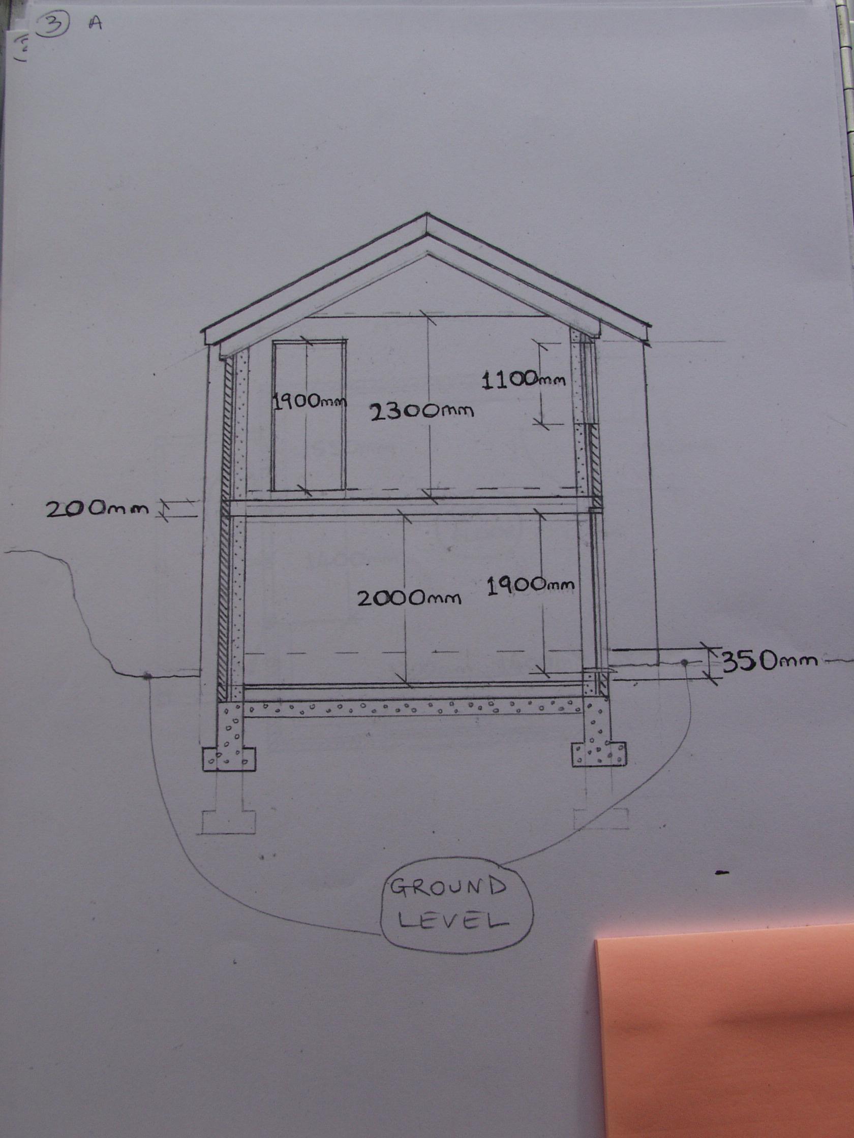

Onoff Posted October 15, 2019 Share Posted October 15, 2019 Bottom line is there is no agreed proper drawing with levels stated. There's very little to work to other than that fag packet sketch. You reckon there was about a foot of concrete poured for the footings? Concrete should have been poured to the height of pegs banged in with the level marked. A foot doesn't sound deep enough to me. Again depth of footings should be on the drawing. Who wins if the trench isn't as deep as it should be? Less digging, less time, less diesel. Not you. Who wins if there's less concrete? You might be paying for Xm3 of concrete but they've only supplied Ym3 etc. Again not you. And how do you know the BCO isn't their mate etc. You've made your own bed I'm afraid. In all honesty there's two storey builds still standing built hundreds of years ago on footings less than a foot deep if at all. Loads of compacted hardcore and a slab poured should allay your fears over the soil from the side of the house eroding. You'll keep whinging, it'll get done somehow. See if the BCO is happy (tomorrow?) and raise your concerns with him. Link to comment Share on other sites More sharing options...

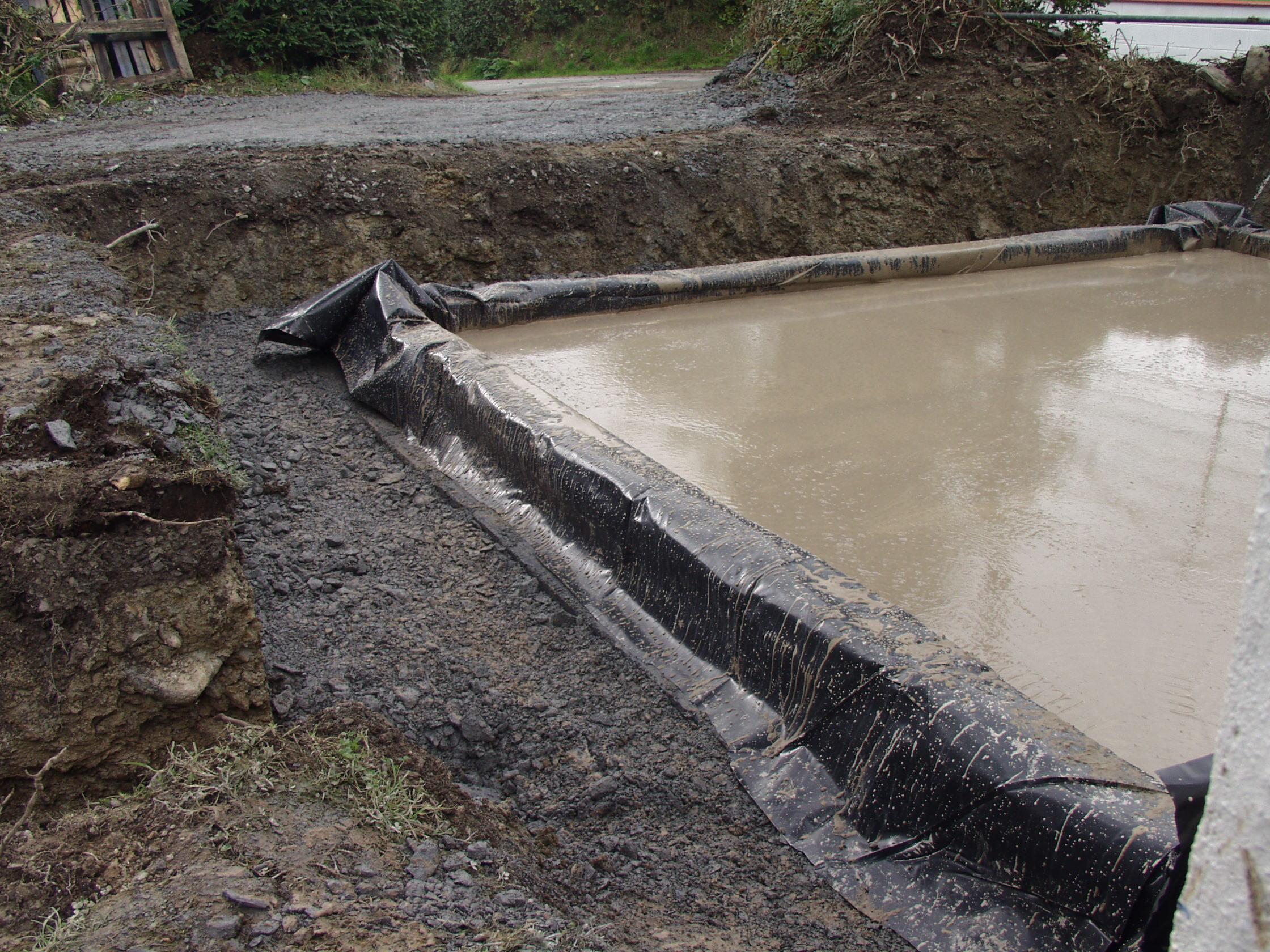

zoothorn Posted October 15, 2019 Author Share Posted October 15, 2019 8 minutes ago, PeterW said: You could use a concrete slab on edge to hold back that hedge - cheap and cheerful That side Peter is no issue. The problem I have now, just speaking to no2 again, is because this is ALL 1ft lower.. this path area @ 600mm is being talked of I had never accounted for. This eats into the very small parking area I had meticulously accounterd, for in terms of where my corner point was decided at, with, only going 1 step down (IE the surrounding ground could go up to the extention). Now no2 is firm firm on this path area around PLUS some sort of retaining wall: albeit 1x BIG FO block high at best (maybe 1.5 height needed I think). So now I'm not happy. I wanted the adjacent ground -always- to go up to/ marry in with the extention, not some big step down into a path all around it. But I hjave no choice with this now. Not happy. But I can't visualise end result, the extra cost involved, whether I can -maybe- somehow backfill this damn path area I don't want. Link to comment Share on other sites More sharing options...

zoothorn Posted October 15, 2019 Author Share Posted October 15, 2019 6 minutes ago, Onoff said: Bottom line is there is no agreed proper drawing with levels stated. There's very little to work to other than that fag packet sketch. See if the BCO is happy (tomorrow?) and raise your concerns with him. That's rude Onoff: my plans are exactly what I was asked to do not some quick sketch on a fag packet thank you. And there's obviously ample to work off if both happy with it to work from. Both are & said how neat, all good etc. I was not asked to do accurate footings depth. This was not my dept. I was asked where I want my doors, windows, etc etc.. critical positions --as a build plan, NOT NOT NOT as a detailed full plans (I was NOT expected to do this with perfect D footings, u-values etc etc how many times do I need to say it! NO) which is what you keep suggesting I should have given them. Wrong. The depth of footings is therefor irrelevant, to my input. It matters not whether they are 10' deep or 10" deep IF my floor level is met. There is a mistake by my no.2. NOT by me. Everyone is suggesting this is all my fault. It is not. Link to comment Share on other sites More sharing options...

Declan52 Posted October 16, 2019 Share Posted October 16, 2019 Ok you are where you are so let's try and figure out what can happen next and less on what has already gone. So to try to help a bit we need a bit more information. Distance from the top of your Founds to your finished floor level in your house, doesn't have to be exact to the mm an inch out is fine for now. How much insulation did you plan to put under the floor?? How thick is concrete screed for your finished floor?? Have you any services to go in, things like a toilet or sink or shower??? Link to comment Share on other sites More sharing options...
Onoff Posted October 16, 2019 Share Posted October 16, 2019 That 2300mm is it from the existing upstairs ceiling height? I'm guessing it is but it should be clearly marked so there's no doubt. Theres no datum i.e an unequivocal reference point marked, to work from. Moving on...they need to block up the difference at their cost with blocks suitable for below ground, and infill accordingly. I wonder with all that accidental depth if you couldn't make use of it and put extra insulation in and maybe some UFH pipes... Link to comment Share on other sites More sharing options...
zoothorn Posted October 16, 2019 Author Share Posted October 16, 2019 Photos as it is, with a socking great 600mm wide trench I'd never anticipated around it too.. due to having gone down the extra 350mm is my reasoning for it, but maybe this trench would have been done anyway? He told me he needed to do this for 'access' & reluctantly I agreed thinking only that it was for brickie's access (IE temporary/ & earth piled > blocks done > earth put back I assumed).. so I do some work, come back & see no pile of earth. So builder2 can say I gave him permission, when it wasn't clear (purposefully I believe) that it was a permanent extraction, & that a "retaining wall/ this a path area now" he says.. all bits Id NEVER known about, anticipated, planned or really understanding why the need for this fkn trench, even now. You can see here how low we've gone relative to the (already small) parking area. Id spent months of meticulous thought on this corner point & the parking area squashed in front. A precise cnr point, to give me -just- room for 2 cars. Meticulous pin-point design, ruined by 600mm damn trench. And talk of retaining walls & paths around it (urgh). 1 Link to comment Share on other sites More sharing options...
zoothorn Posted October 16, 2019 Author Share Posted October 16, 2019 9 minutes ago, Declan52 said: Ok you are where you are so let's try and figure out what can happen next and less on what has already gone. So to try to help a bit we need a bit more information. Distance from the top of your Founds to your finished floor level in your house, doesn't have to be exact to the mm an inch out is fine for now. How much insulation did you plan to put under the floor?? How thick is concrete screed for your finished floor?? Have you any services to go in, things like a toilet or sink or shower??? Hi Declan. I've just put up my plan again ^ for convenience: you can see the 350mm fig. I explained to main builder1 (I went through the 3 simple pages with him carefully, made sure happy with my drawings- very happy "good, neat") the 350mm figure, & it being from the finished floor level in the house. I said the broken lines are "original floor levels". Understood. "Am I right broken lines are usual as used for such adjacent/ finished floor levels".. "yes". So I did my best, my very best. Yes I forgot the wording.. 'orig floor level' but he didn't show ANY concern, as I could see he understood perfectly simply. Thing is he didn't do the groundwork as I assumed he would, his chap2 suddenly appears & wants to start wed 3pm. No warning. "Erm.. ok.. you have plan & happy? (Yes- all clear). I'll just put a mark where existing floor is.. & critical thing is 350mm down from it". So I crossed every t & dotted every i. As best I could. And I get a slew/ deluge of opinion on here that my plan's not this or that, or its all my fault. No, that's just not right at all. More haste less speed is the fault, this & only this. Link to comment Share on other sites More sharing options...
zoothorn Posted October 16, 2019 Author Share Posted October 16, 2019 @Declan52 sorry to answer your Q's. 350mm 100mm (whether 50mm-100mm it doesnt alter the final floor/ scree H, as this has to be @ top of the 2x 9" blocks surely?) 25mm? (again whatever is planned, to meet the top of the 2x9" blocks' level.. I don't know how it could be any extra) No services, just minimal electrics. Link to comment Share on other sites More sharing options...
