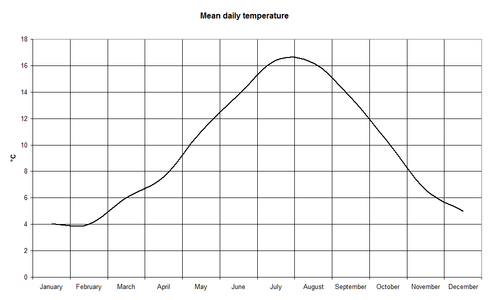

The operating principle was to ensure that the larder had a high heat capacity (hence the "cold" shelf) and to prevent it getting any solar gain at all.  That way it would end up at around the mean daily temperature, cooling slightly during the night and warming slightly during the day, with the high heat capacity of the shelf and tiles helping to maintain an even temperature.
However, a look at the mean daily temperature data shows that a passive larder like this would never have stayed very cool in summer.  This is the mean daily temperature for our area (data from the Met Office), for example:
This shows that for about 5 months of the year a simple vented larder would be above 10°C, and for a couple of months it would be above 15°C, assuming that it was perfectly insulated from the inside of the house.  In practice the inside of the house will always leak some heat into the larder, so it will be slightly warmer than these mean daily temperature data would suggest, plus it would be a source of heat loss from the house.
The myth that larders were always cool places really goes back to the days before we had refrigerators, where a ventilated space like this would always be cooler than the house, so better for keeping perishables in.  The reality is that they weren't ever very effective, and anyone that really wanted to keep food fresh (and had the money to do so) would have an ice house, usually built underground, or in a basement.
A larder built into a basement, and insulated well from the thermal envelope of the house would stay at the typical UK ground temperature, which is about 8°C.  Not as cool as a fridge (they are typically around 3°C to 4°C) but fine for storing fruit and veg, cheese and possibly wine.
