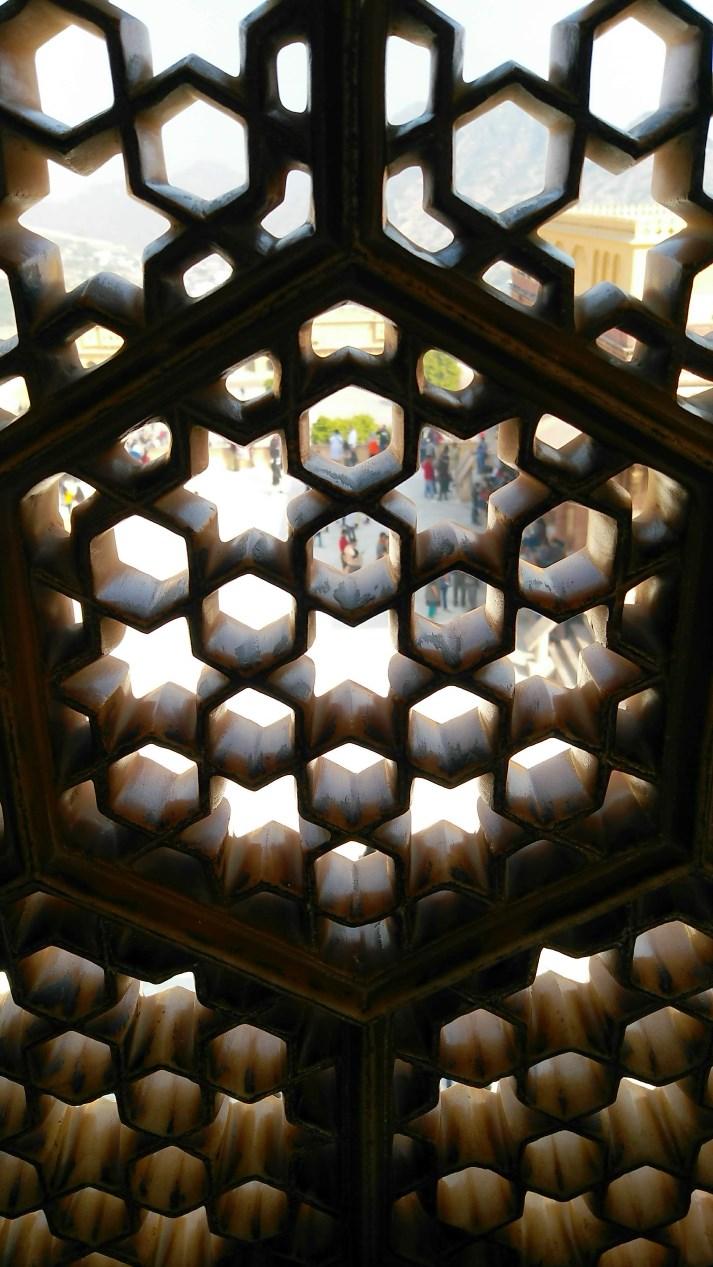

Or maybe a mesh screen? Might create an interesting effect.
We were soaking up winter sun in India at christmas - their architects really understood the effect of screening to aid cooling - shading and ventilation - plus privacy.

Brilliant idea about the screening, but would hate the interior to become too dark.

It is a balance - anything you do to reduce direct light coming into the house (film, trees etc) will mean you are making it darker.
6 minutes ago, Canoehq said:
brise soleil unfortunately, as anything that sticks out over the footprint
Brise does not have to stick out by much - you can have window slats, random google search: http://dougintology.blogspot.com/2007/11/solar-decathlon-window-slats.html

So, shutters it may have to be.
