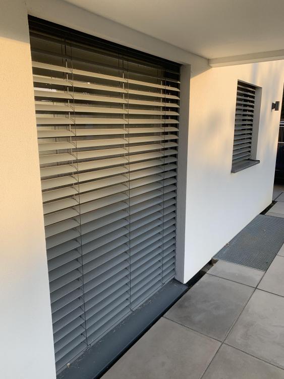

Jeremy Harris Posted September 22, 2019 Share Posted September 22, 2019 Welcome. As above, you're going to need to do a massive amount of work to mitigate overheating. Stopping heat getting in is far, far easier than trying to get rid of it once it's in, so I'd suggest making sure that the arrangement of brise soliels you have will be effective for all sun angles, consider using solar reflective glass, or perhaps Sage glass, and look to see if you can fit external blinds or shutters. The latter can be very effective, more effective than probably any other solar gain reduction method. There are lots of threads here on dealing with overheating through glazing, but I don't think we've yet seen a house with that much glass, so your challenges may well be significantly greater. Not sure what you're considering as a heat source, but a heat pump would seem a good candidate, as it could be run in reverse for most of the year to remove heat from the house. Floor cooling using UFH pipes works well, but with the amount of solar gain you're going to get I would consider fitting lots of fan coil units run from chilled water from the heat pump as well. Both these systems could also provide winter heating. Out of interest, how have you managed to meet the requirements of Part L1a with that much glazing? Link to comment Share on other sites More sharing options...

Jeremy Harris Posted September 22, 2019 Share Posted September 22, 2019 16 minutes ago, Canoehq said: Yes, the glass is a worry and no, not deep pockets, so cheaper glass with solar film or external shutters I guess. Whatever stops the heat getting in, unless forumites have some better ideas before the first spade goes into the ground, as still time to replan ! I had to fit solar film when we found that solar gain was too high, as have one or two others here. It works, but it's not as effective as solar reflective glass, you can tell there's film on the glass and it was more expensive overall than if we'd have fitted solar reflective glass in the first place. External blinds or shutters can be very neat and effective. Worth designing in, as then they can seem invisible when retracted. One or two here have then fitted, and have described how they look and work in other threads, so might be worth seeking those out. Retrofitting external blinds is possible, but never looks quite as neat. 12 minutes ago, Canoehq said: Thank you so much for such useful help this early on, really kind. Re your question, there are no other windows in the barn apart from the ones you see. Actually, tell a lie, there are bi-folds on the kitchen gable end. I'm hoping there are technical people out there who can advise appropriately, but generally find where there's a will................. ! If not done yet, then I think that an early run through SAP would be a great benefit, to see how far off you are from meeting the regs. Having bifolds will make things worse thermally as they will inevitably end up with poor sealing after a while, reducing airtightness and increasing heat loss. Have you considered something that will be significantly better thermally, like lift and slide doors? You can still get large openings, but without all the intrinsic issues that beset bifolds. Link to comment Share on other sites More sharing options...

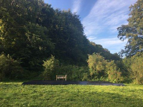

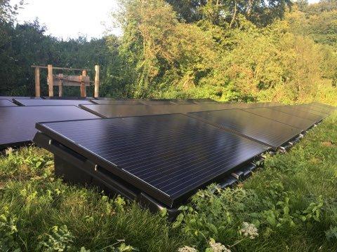

ProDave Posted September 22, 2019 Share Posted September 22, 2019 Hi and welcome. You certainly have some challenges there. As it's certain you are going to need active cooling, I suggest you install solar PV to help power that in the summer. Probably ground mounted. Please don't take this comment the wrong way, but I think this build illustrates just how plain stupid our planning system has become. You have got permission to convert that open Dutch barn into a house, but let's be honest for a minute, that building is the very last building I would consider a candidate for conversion. Nothing about it lends itself to conversion. You are in effect building a new house and sitting it under the tin roof of an old barn so it is counted as a "conversion". And this is where I think the planning law is just plain bonkers. It would be far far better if you were allowed to knock that down and build a proper house from scratch, of no greater size than the old barn. You would end up with a better house technically, and (please don't take offence) a better looking house. Having said all that and hoping I have not upset you, you certainly have some interesting challenges ahead. Link to comment Share on other sites More sharing options...
