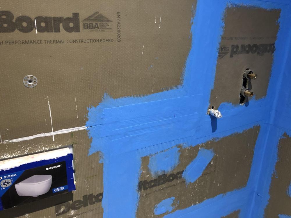

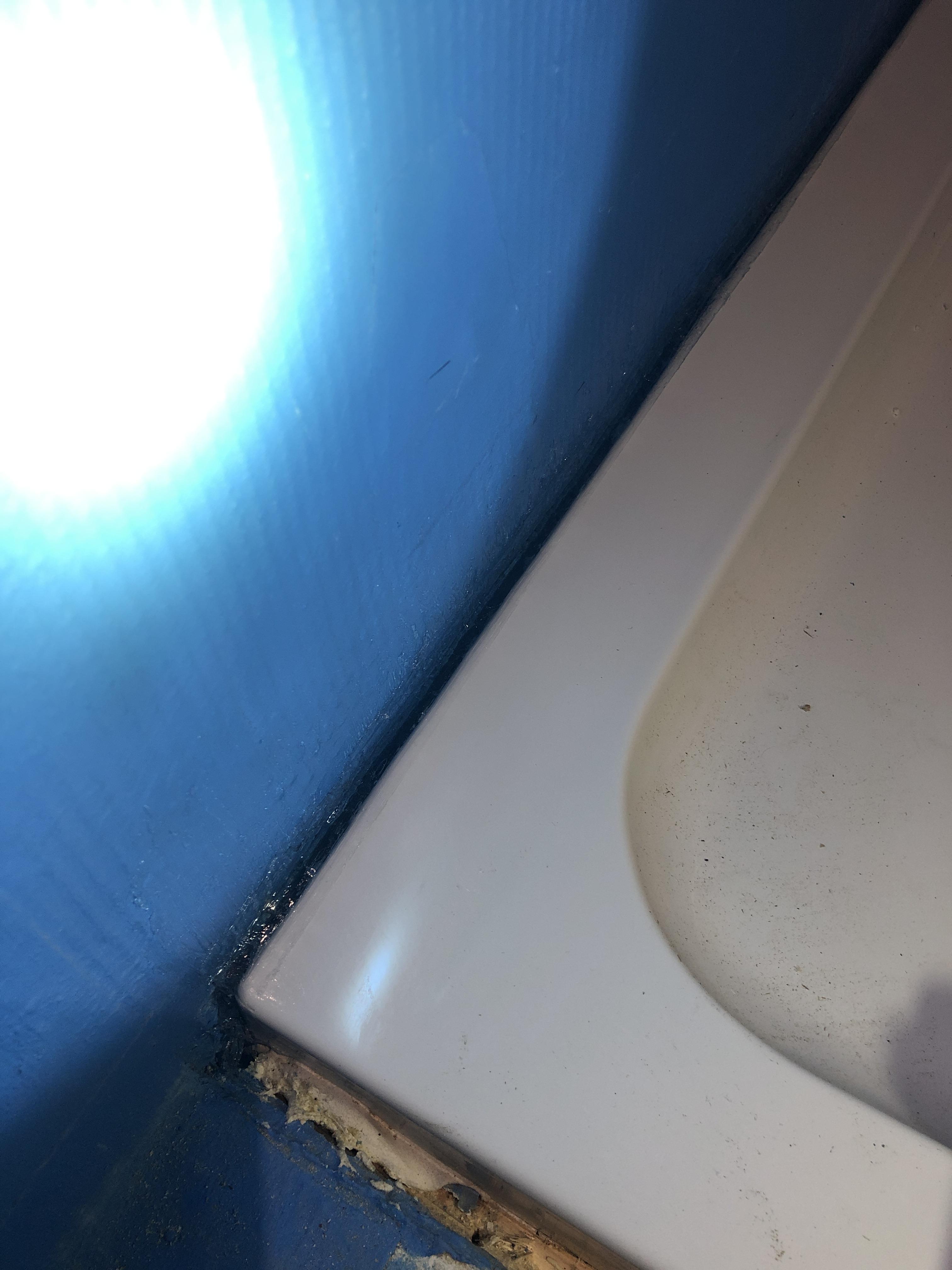

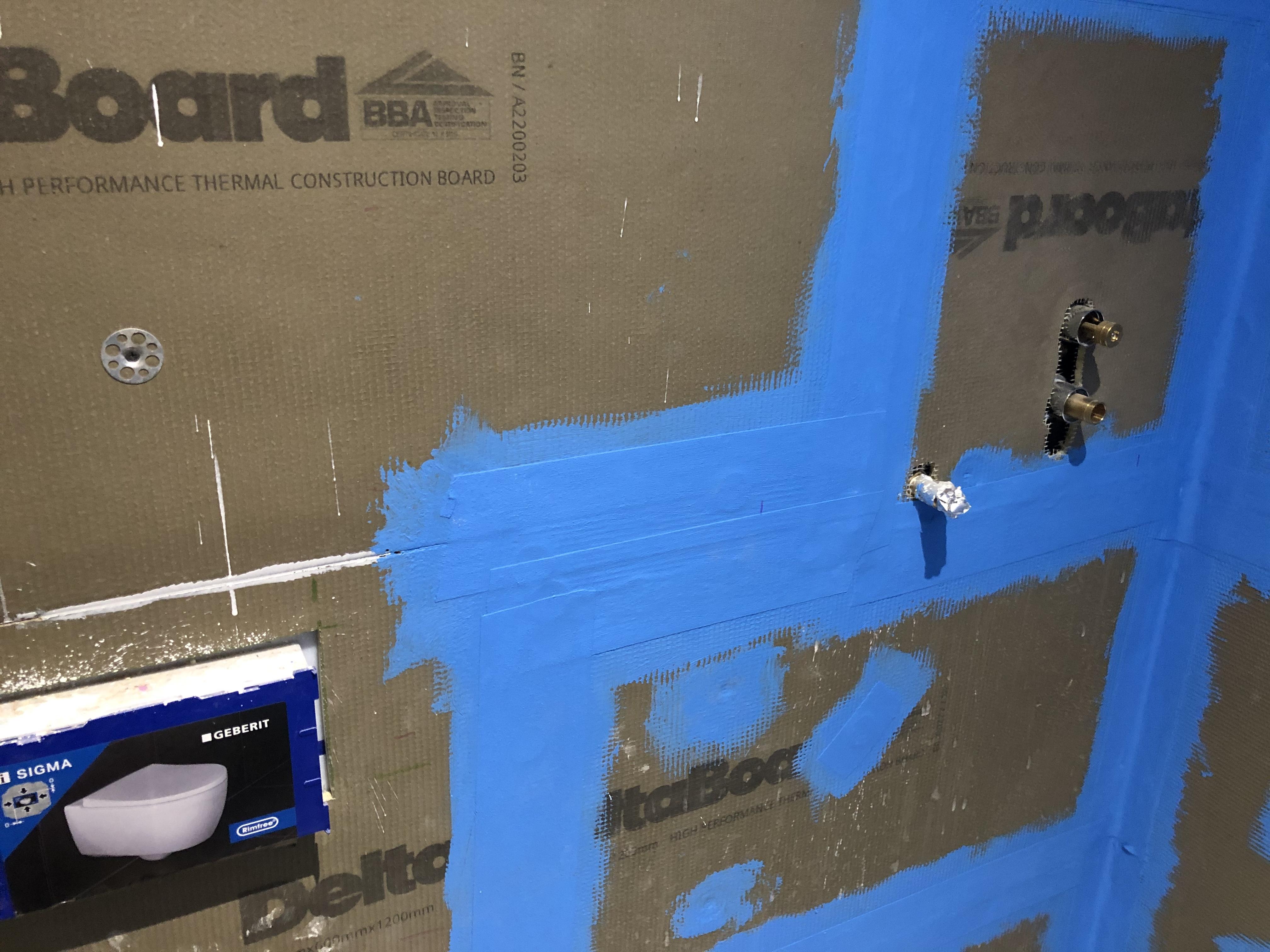

Ct1 again with up stand . Half a tube used
Used clear but white would of been better as can actually see it . With a torch though I can see the ct1 shine so I know it’s in there !
37 minutes ago, PeterW said:
Aren’t you tiling over the gap anyway ..??? Or using panel system ..??
Yes . Tiling over it . Just following Nicks ct1 in there . Then ct1 ‘lip’ over it again .

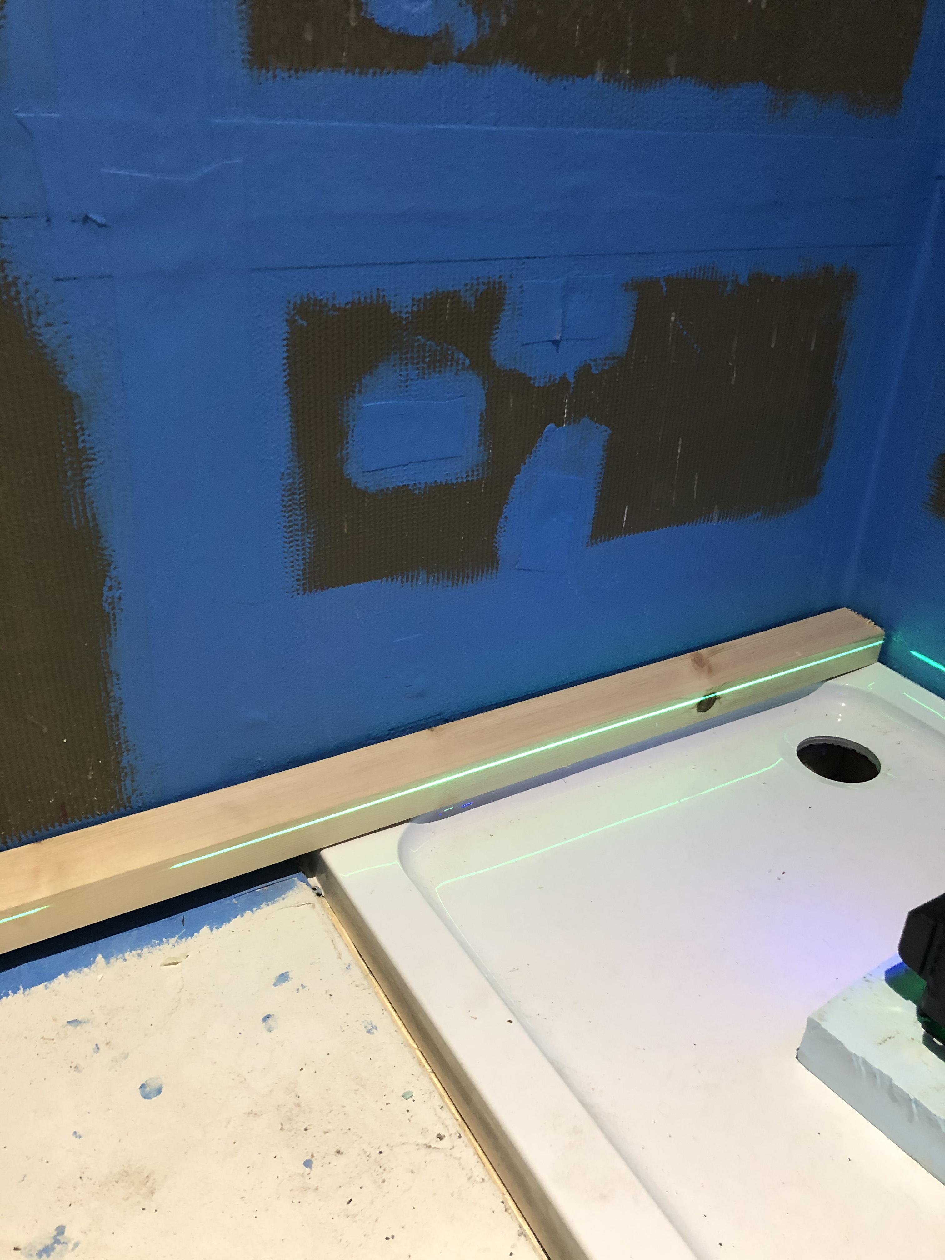

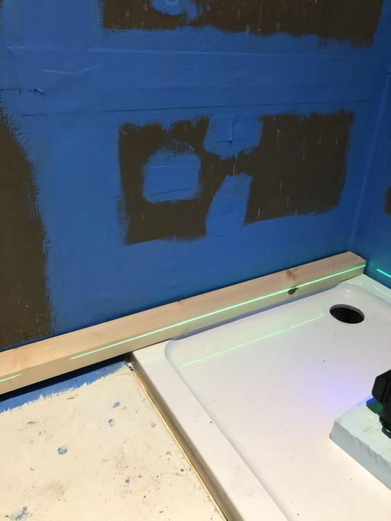

Starting on this wall . Got a timber beam to hold first full bottom course of tiles. All seems level - might go a bit higher . Must avoid @Onoff ‘s rips on this facing wall at the top
Hmmmm

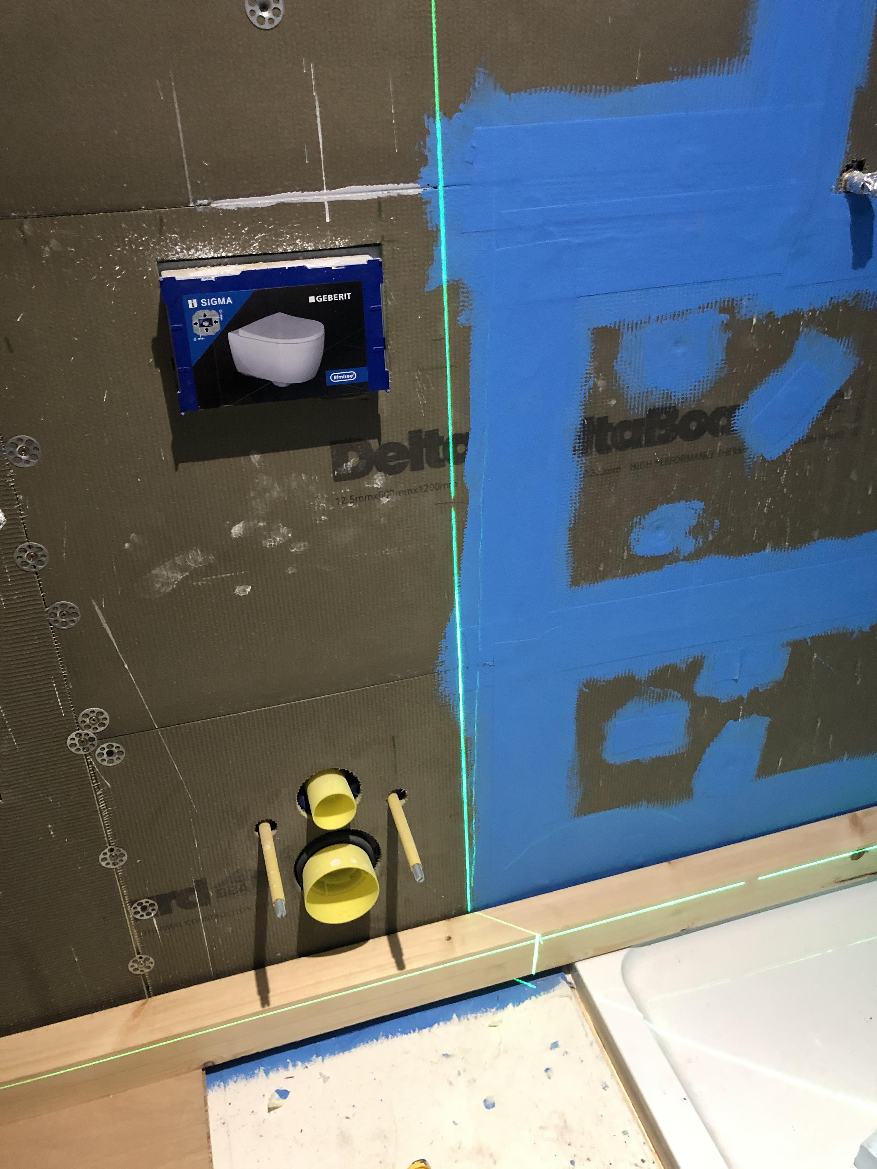

These wall tiles are 50cm x 20cm . I’m laying them long ways . So it’s hard not to get a slim bit at the bottom or the top . I reckon bottom would be about 10cm and so would top sliver . I’m probably over thinking this . Once mirror , sink , toilet , shower door in ( all on this wall ) probably won’t see hardly any tiling anyway !! ?
Dilemma !
As the most obvious visual thing with be the toilet flush decided to take the centre of that and work left and right . Means in the shower to the right Of the fitting there will be a 10cm wide cut . Bit narrow , but what else can I do ?!
2 minutes ago, Russell griffiths said:
10cm is not narrow, 2-3cm is narrow.
Then that’s sorted ! Let the tiling commence !!!! ?

49 minutes ago, pocster said:
Dilemma !
All sounds alright to me.
