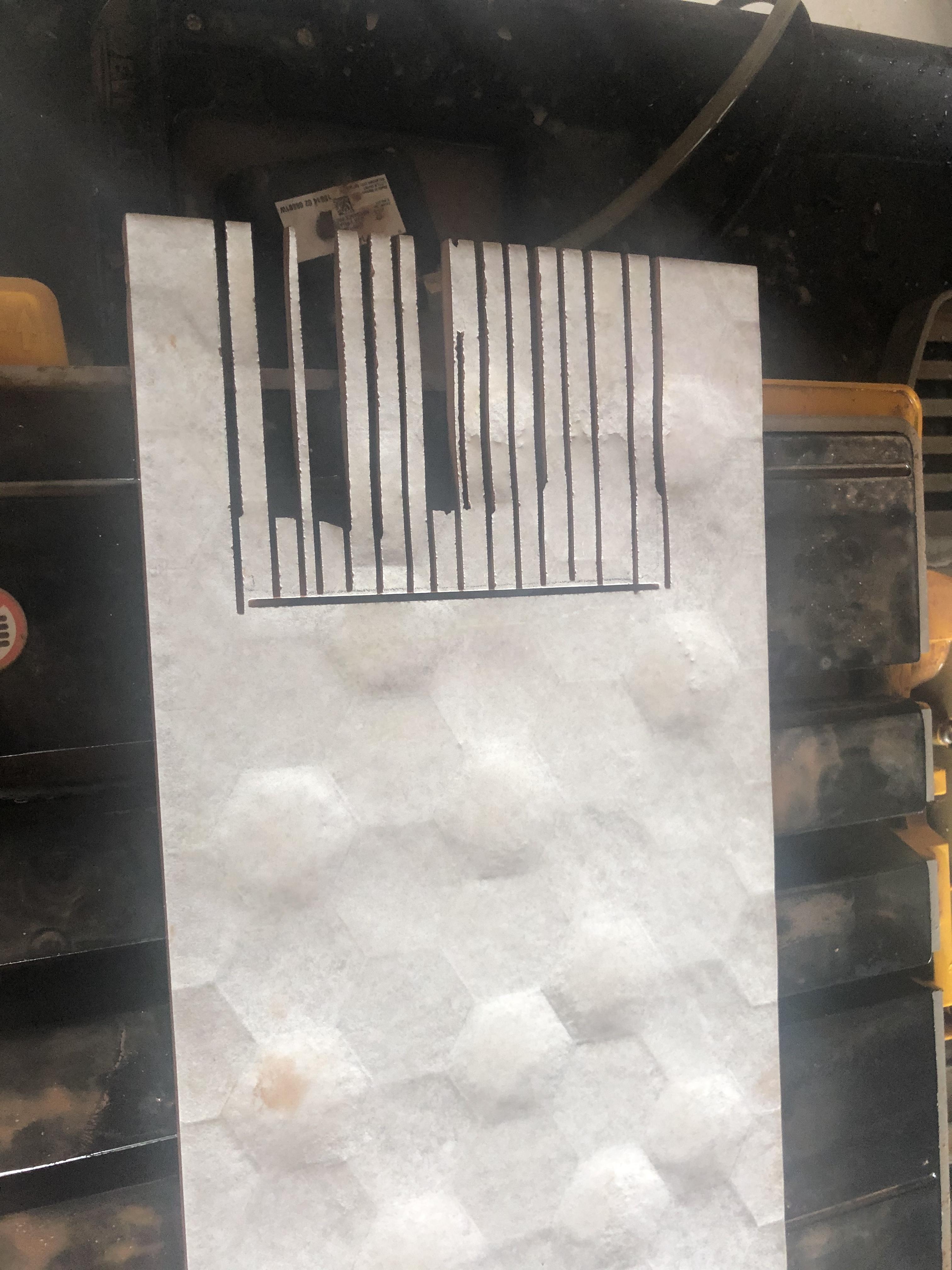

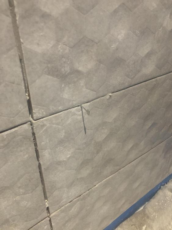

I cursed this day, all done with a template:
20180922_154218
Dry fit:
20180923_135701
Second time lucky:
20180923_172931
That’s a big effort!!
very impressive, especially as you won’t see most of it hidden behind the pan.

I assume the little metal t shape end bit is now integral due to adhesive.
I guess you have to remove them soon after getting the tiles level, before the adhesive fully sets.
Using the jigsaw blade again they do eventually come out . Note to self remove levellers next day !! ?

Just out of interest I scanned that tile with a barcode reader:

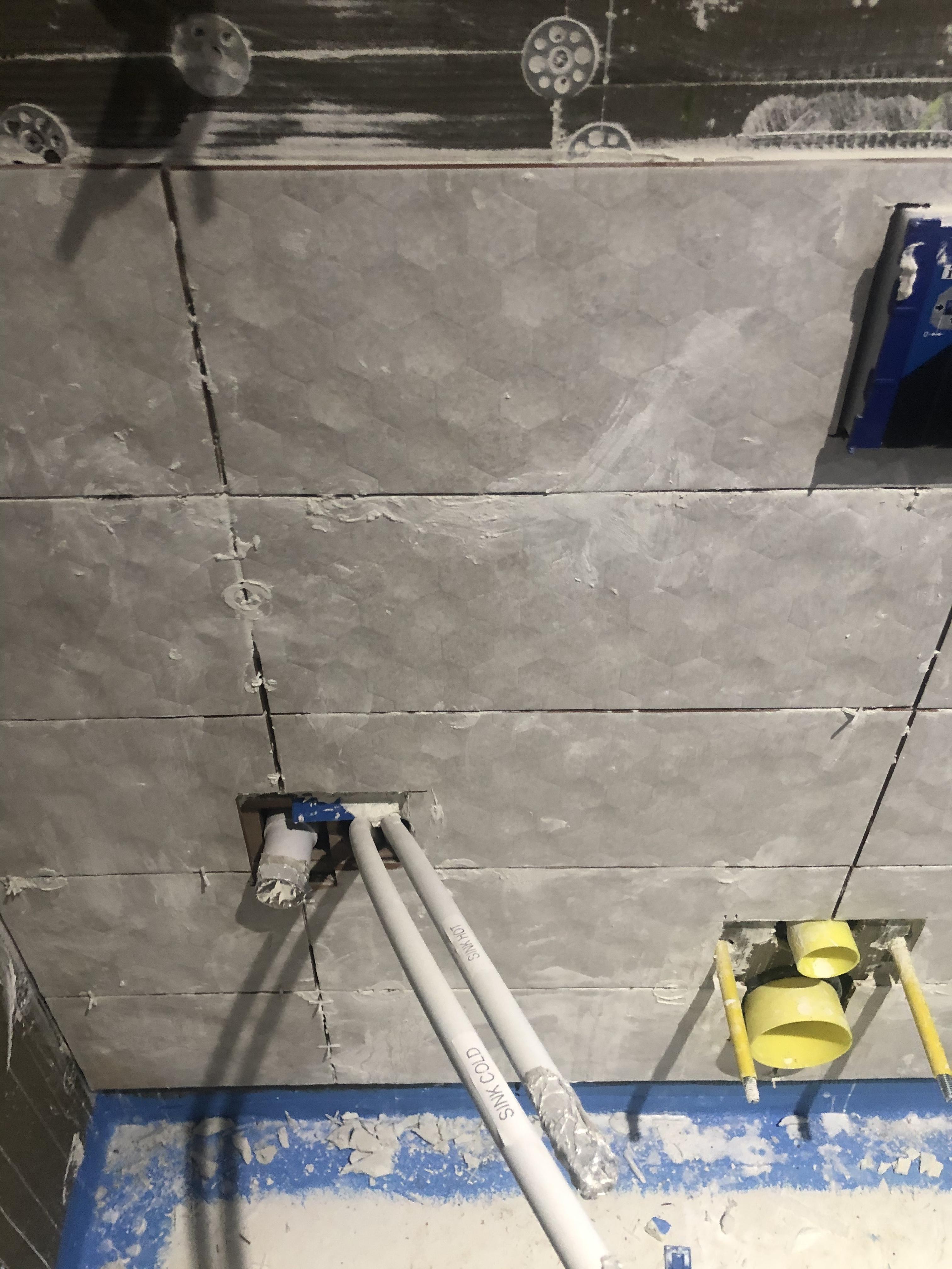

Is cleaning and trying to get these f ing things out meant to take longer than the tiling ??? ?

One tile left to fit in my bathroom!
My levellers were loose in a box with no instructions - but unsurprisingly I found
3) Before the cement or tile glue has completely dried up (usually no more than 6 hours),
tighten the adjusting cover in the opposite direction, then rotate the T-pin 90 degrees
so that the T-pin turns to a zigzag parallel to the tile, and remove the leveler;
Tricky when you don't live on site!
Edited by pocster

Make sure you wipe the adhesive off the tiles and try to get it out of the grout line too. It will make your job a lot easier later on.
Use a damp sponge and just keep rinsing it off.

I had a big bucket of clean water for the wipey down sponge. A smaller bucket (brush pot) to put my notched trowel and paint brush in and a second big bucket full of water to wash my tools in when they got too messy or started drying. I would also throw any removed tile spacers into the tool washing bucket. I'd use the paint brush "dry" to take out excess adhesive from along the joints...and there was a lot!
So wish I'd accepted my mate's offer of help.
Not unsurprisingly, very thorough! ... but hopefully resulted in a lot less ‘cleaning’ later.
When I got to grouting I always wish I had been more robust in removing any excess and cleaning the adhesive. ... there’s always next time to get it right!

I just wish I'd used a tile levelling system on floor and walls.
Glad I did the floor tiles first though then the walls. Imo it makes for a better, more invisible and more waterproof joint. You do of course have to protect the whole floor with Correx/Proplex/Antinox etc sheets taped together when you do the walls.
This is going to take some cleaning !!
