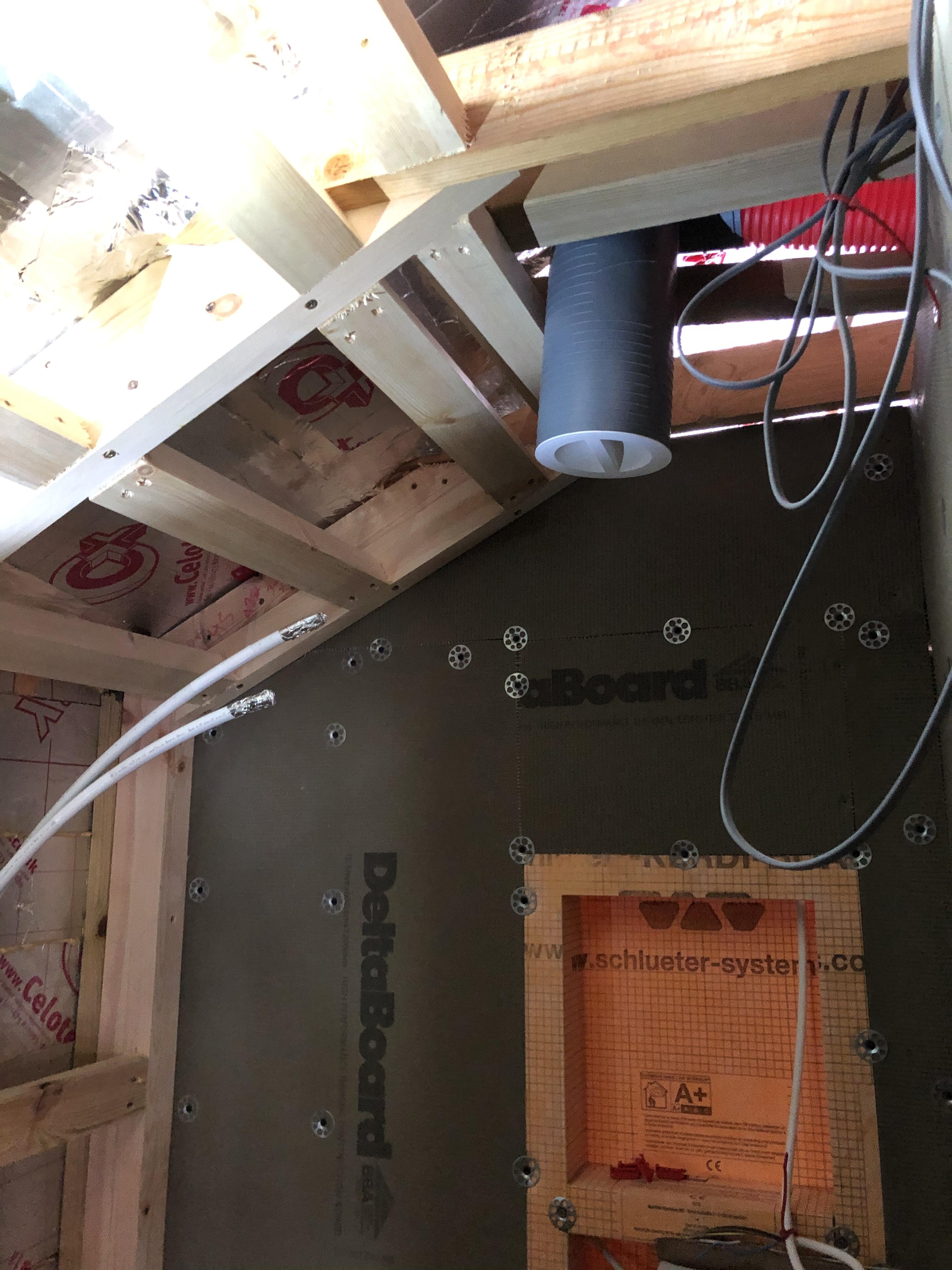

Pocster Posted May 8, 2020 Author Posted May 8, 2020 (edited) Just for you @Mr Punter ! What a pita it was . Working on a bank holiday that’s dedication ; vent above shower ? Edited May 8, 2020 by pocster 1

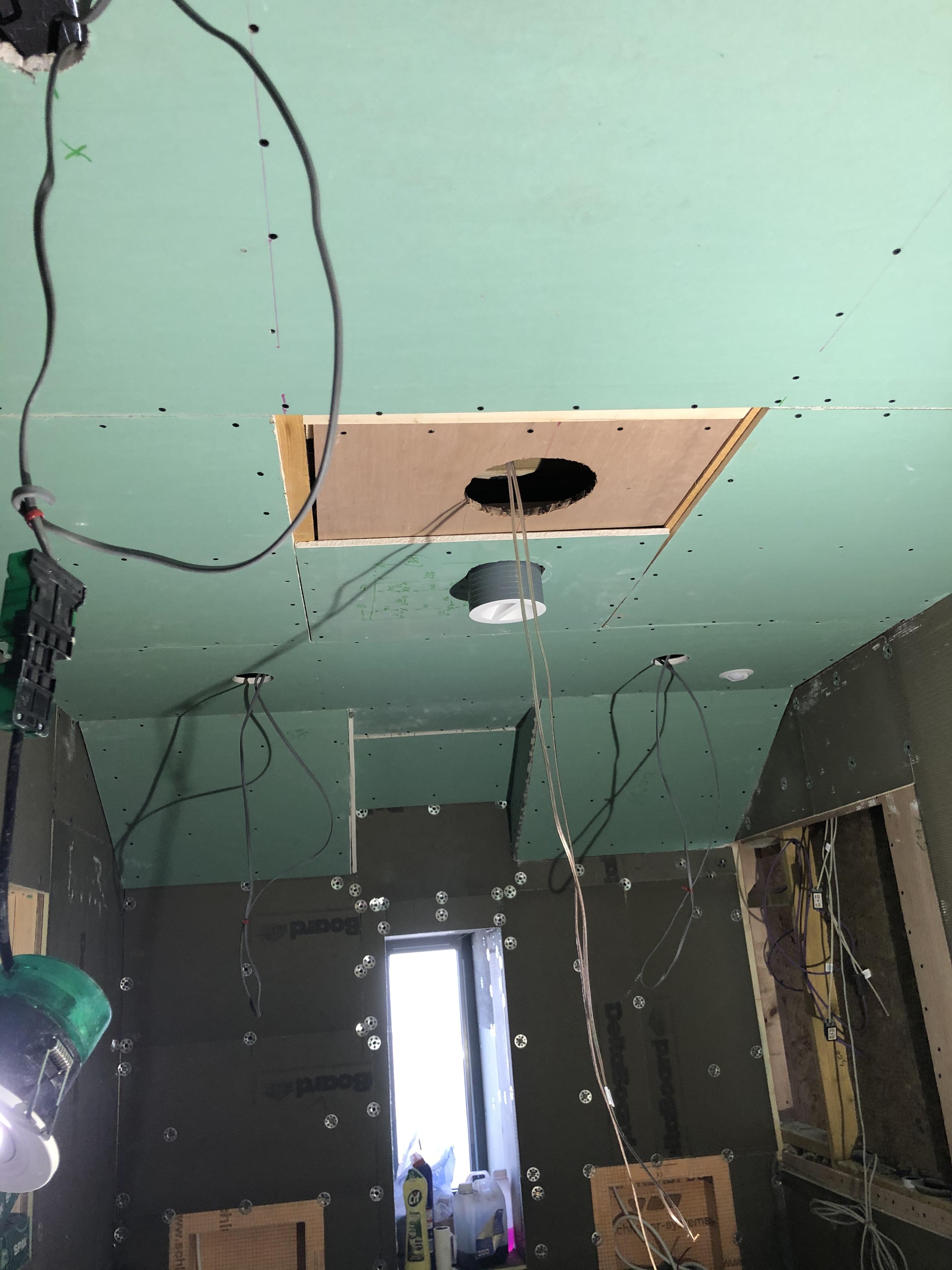

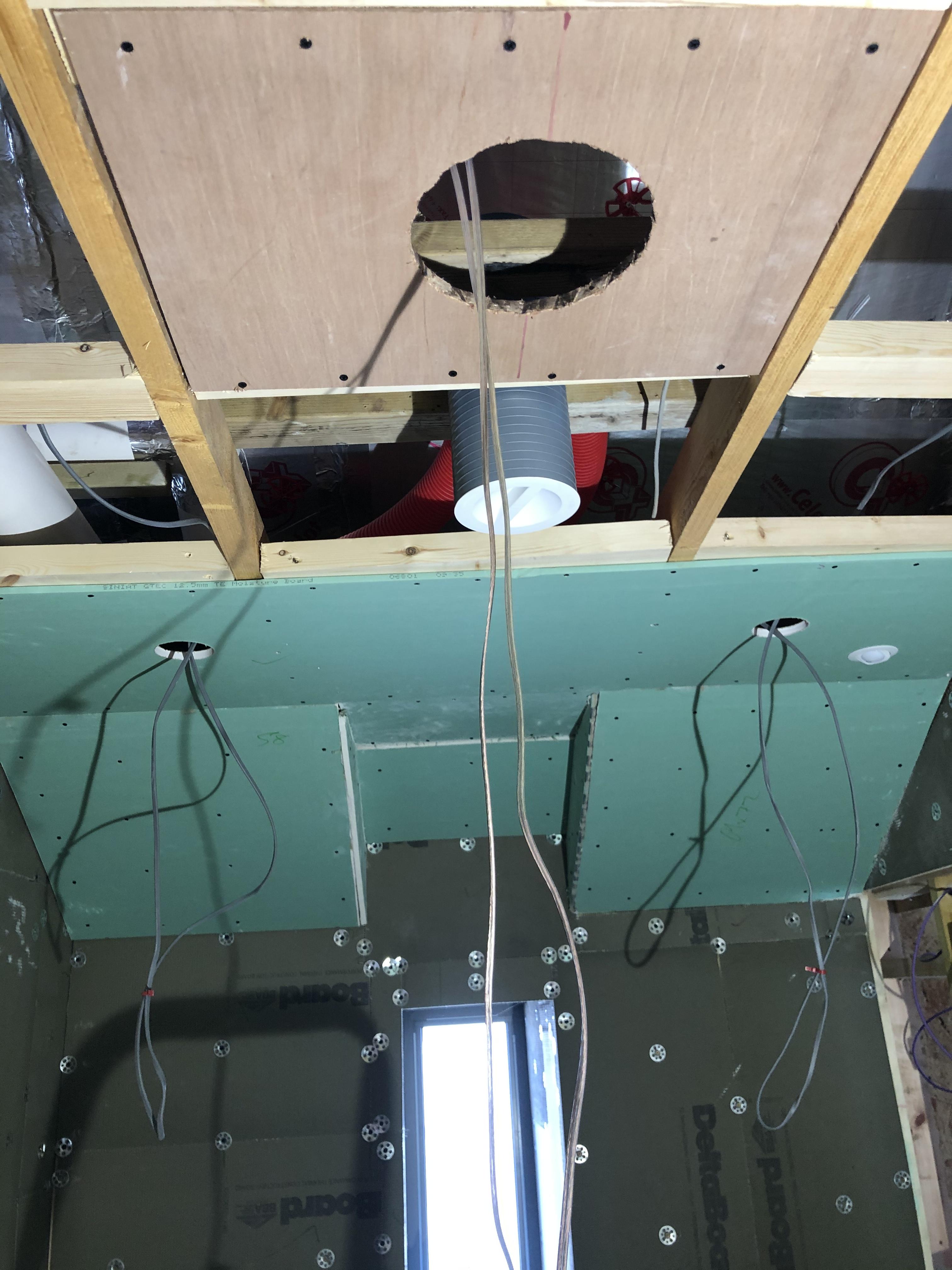

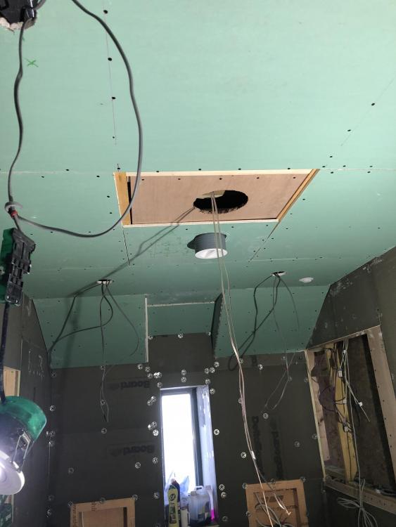

Pocster Posted May 20, 2020 Author Posted May 20, 2020 Almost finished bathroom ceiling . Was worried ceiling speaker would be too heavy just to rest on plasterboard . So added a Marine ply base for it .

PeterW Posted May 20, 2020 Posted May 20, 2020 On 20/05/2020 at 14:36, pocster said: Almost finished bathroom ceiling . Was worried ceiling speaker would be too heavy just to rest on plasterboard . So added a Marine ply base for it . Expand Take it you're not bothered about acoustics..???
Pocster Posted May 20, 2020 Author Posted May 20, 2020 On 20/05/2020 at 15:19, PeterW said: Take it you're not bothered about acoustics..??? Expand Sure I asked about this before. Everyone suggested plasterboard. Or do you mean specifically the speaker???
PeterW Posted May 20, 2020 Posted May 20, 2020 Single speaker in marine ply and plasterboard ..?? I’m sure Adele won’t mind .... 1
Onoff Posted May 20, 2020 Posted May 20, 2020 I'm amazed at how good my Bluetooth speakers sound in the bathroom. I was worried they would sound tinny.

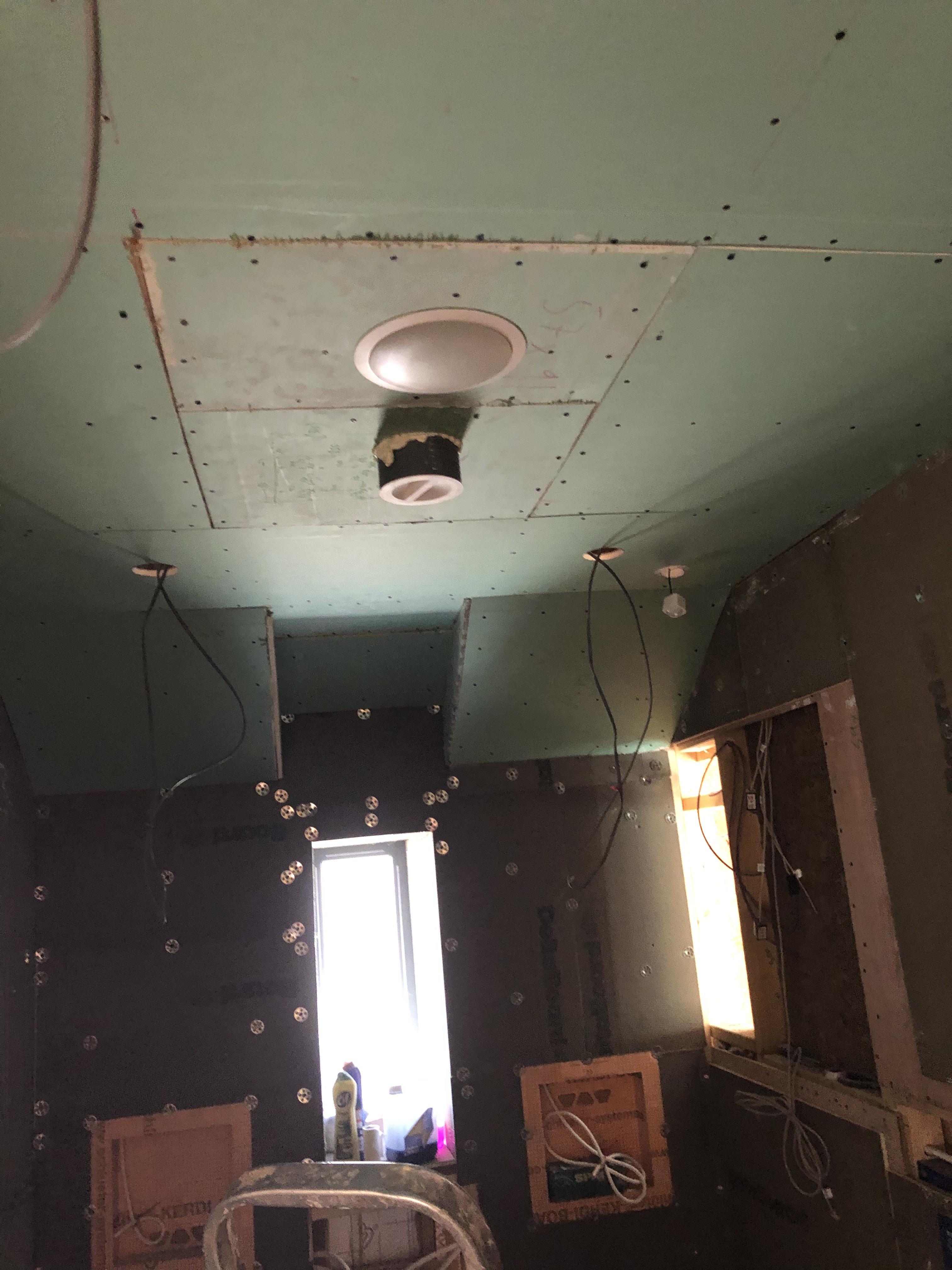

Pocster Posted May 21, 2020 Author Posted May 21, 2020 On 20/05/2020 at 16:36, PeterW said: Single speaker in marine ply and plasterboard ..?? I’m sure Adele won’t mind .... Expand I’ll finish that bit today and give Adele a proper workout
Pocster Posted May 21, 2020 Author Posted May 21, 2020 And Adele did indeed sing with her Warm tones ...

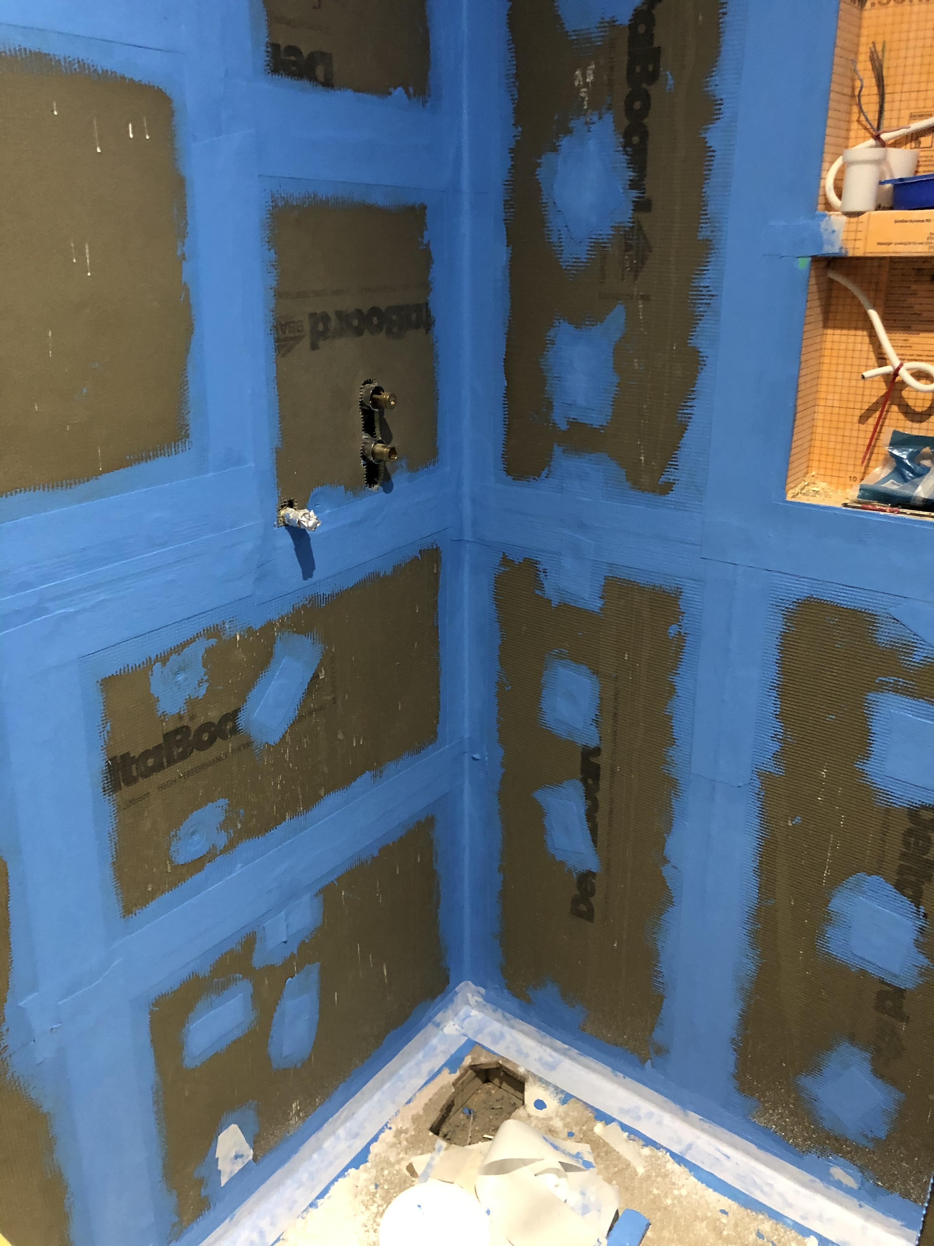

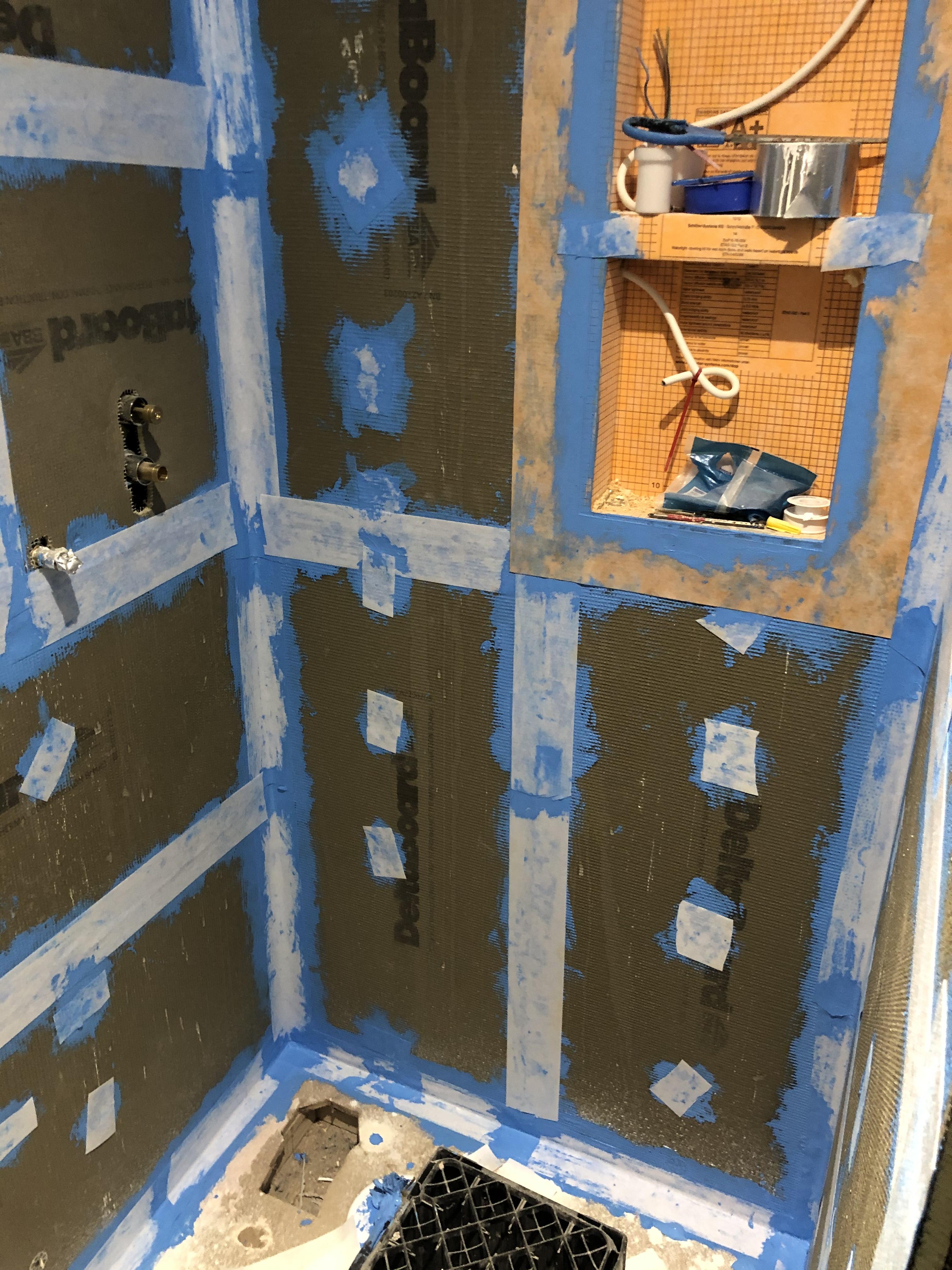

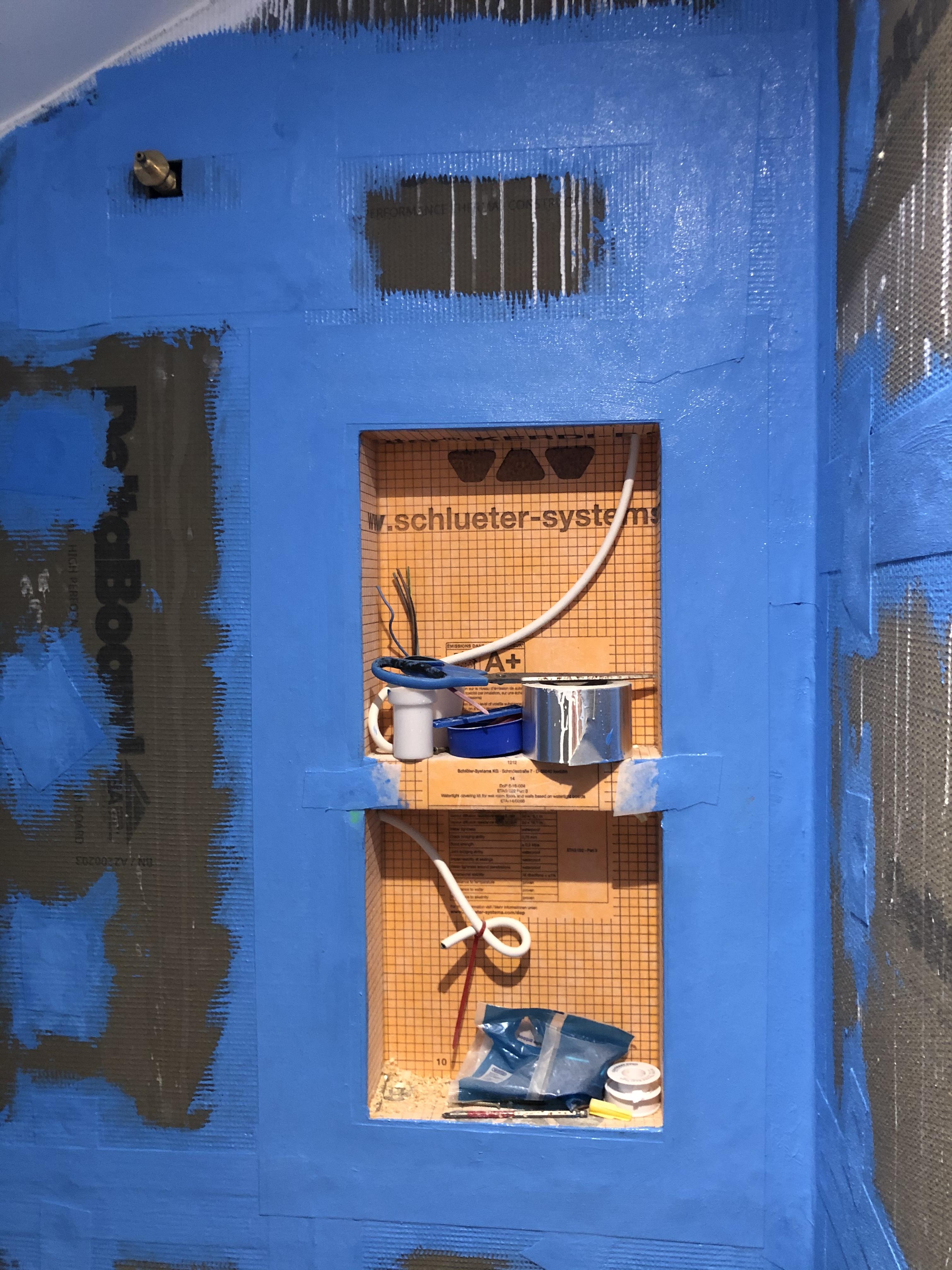

Pocster Posted August 18, 2020 Author Posted August 18, 2020 First round of ensuite tanking done . Never really sure about this where you just glue bits of material down ....
Pocster Posted August 18, 2020 Author Posted August 18, 2020 I’ve always been confused by the point of this . After all if water gets past grout / Mastik I.e the initial barrier . You have a problem anyway . As the shower tray sits on this - then any water here means everything above has failed . So is it just delaying the inevitable???
Pocster Posted August 18, 2020 Author Posted August 18, 2020 No ones said anything - that means I’ve done it right !!

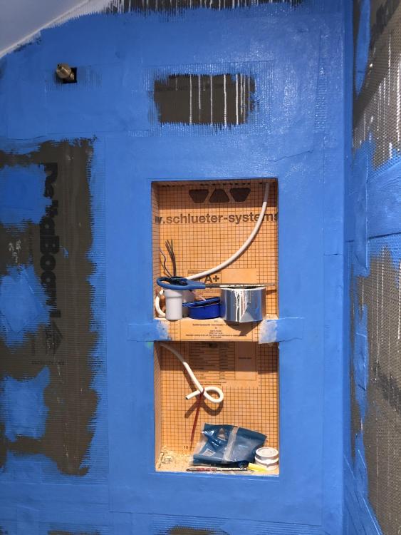

Pocster Posted August 19, 2020 Author Posted August 19, 2020 Assume I should paint the inset with the water proof blue paste ? . Makes me wonder what the wall tile adhesive is actually going to stick to !
Onoff Posted August 19, 2020 Posted August 19, 2020 On 19/08/2020 at 11:33, pocster said: Assume I should paint the inset with the water proof blue paste ? . Makes me wonder what the wall tile adhesive is actually going to stick to ! Expand The (blue) tanking needs to be continuous. I think the theory is that you should also use the tanking tape at any change in materials say where mrpb meets the concrete floor etc. Guess you primed like mine before applying the tanking liquid? You then prime again with tile primer (over the blue) before applying the tile adhesive. Wotsit to a blanket!
Pocster Posted August 19, 2020 Author Posted August 19, 2020 (edited) On 19/08/2020 at 11:39, Onoff said: The (blue) tanking needs to be continuous. I think the theory is that you should also use the tanking tape at any change in materials say where mrpb meets the concrete floor etc. Guess you primed like mine before applying the tanking liquid? You then prime again with tile primer (over the blue) before applying the tile adhesive. Wotsit to a blanket! Expand Didn’t prime . The tanking and backer board all from same supplier - no mention of priming ( unless as they state in their instructions you are using other mediums ) So I should ‘blue out’ the niche ? . I stuck the niche collar down with the blue and then went over it again . May of mis understood the instructions so did a second tape / corner pieces at base . Edited August 19, 2020 by pocster
