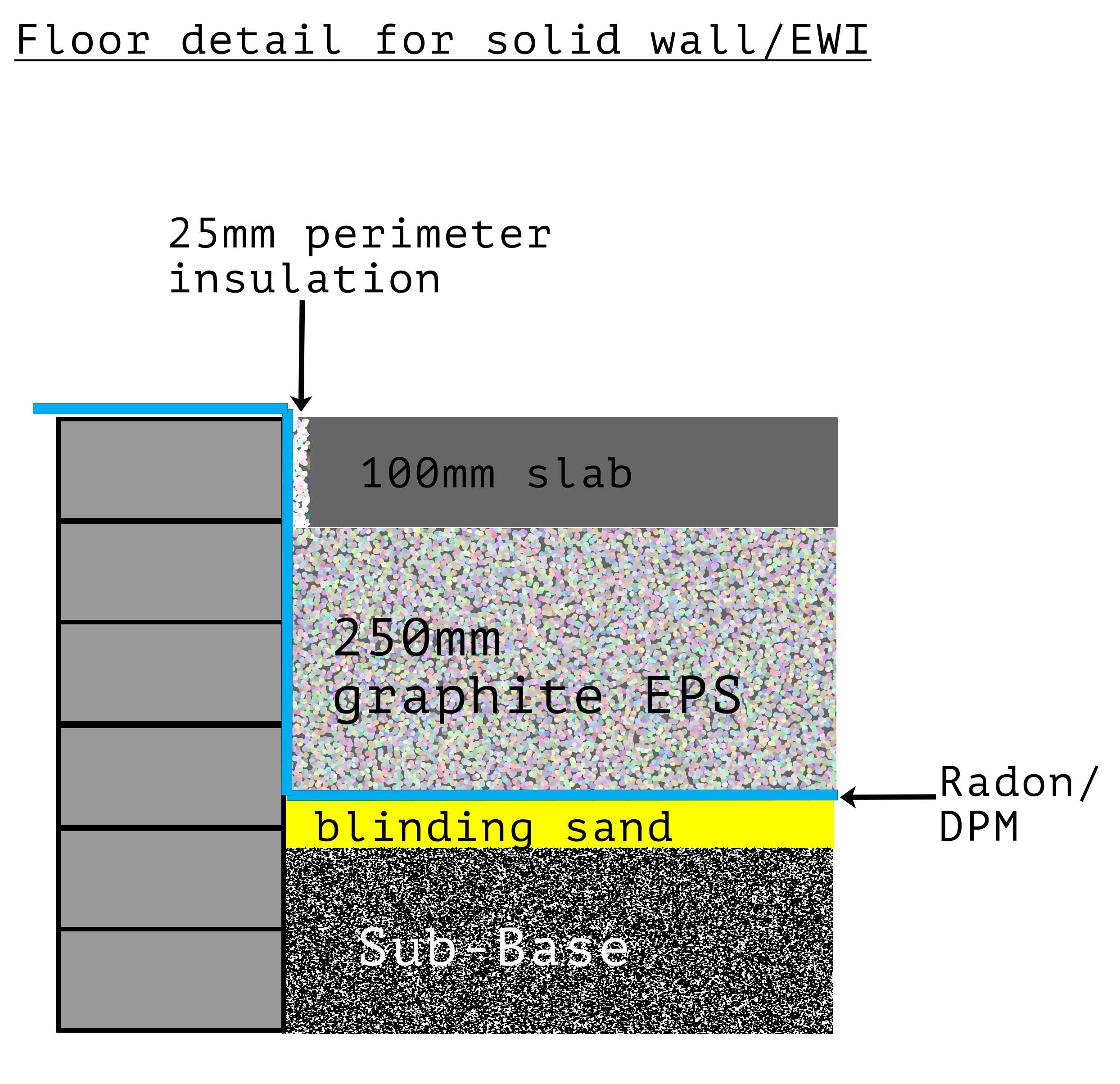

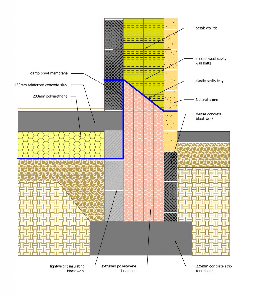

MarkH Posted September 24, 2016 Share Posted September 24, 2016 (edited) Here's our floor construction. I'd appreciate any opinions on it and in particular on a couple of details currently in decision limbo: 1) I'd assumed the DPM would go as pictured in this diagram - under the insulation - as it seems to make sense to have it contained within the waterproof envelope. A couple of people have suggested that the membrane goes OVER the insulation though. 2) slab reinforcement & UFH... am I overkilling by adding reinforcement mesh mainly to give me something to attach the UFH pipes to? Would it be easier to clip the UFH to the insulation (I saw a handy clip gun thing) and leave out the steel? By the way, the EWI isn't shown on the diagram above but is (probably) 200mm of EPS extending down 200mm below the slab insulation. Edited September 24, 2016 by MarkH Link to comment Share on other sites More sharing options...
jfb Posted September 24, 2016 Share Posted September 24, 2016 I had a very similar build up with the dpm as you have it and used mesh for slab strength and, as you say, something to attach UFH to. Not sure how easy it would be to clip the UFH pipes to EPS (might be easier with other types of insulation board). The pipes will be under a fair bit of tension especially at tight corners and EPS isn't the firmest/strongest material to fix to. Link to comment Share on other sites More sharing options...
joe90 Posted September 24, 2016 Share Posted September 24, 2016 I am having UFH pipes cable tied to steel mesh within the concrete slab and that slab is going on top of the internal wall so there is no potential weakness in doorways. Our DPC is going under the insulation like this:- Link to comment Share on other sites More sharing options...

Nickfromwales Posted September 24, 2016 Share Posted September 24, 2016 The mesh reinforces the slab, adding immensely to the integrity for one. I'd not even think about not fitting it tbh as it's cheap as chips and gives you a grid to attach the pipes to. Has your engineer / BCO specified no re-bar ( mesh ) ? I'd have thought it would be a given. Link to comment Share on other sites More sharing options...

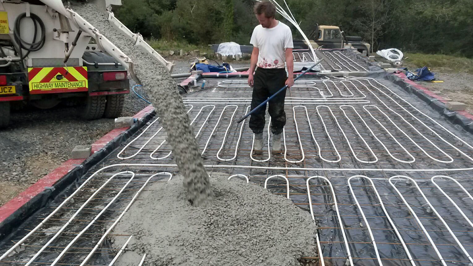

TerryE Posted September 24, 2016 Share Posted September 24, 2016 Here is the lads pouring our slab. We have a passive slab hence the rebar box ring and 2 load-bearing internal walls. Note how the UFH piping is snappied to the rebar mesh. We also have extra 200×200mm bracing sections every 2m on the slab areas. (The funny T that Danny on the left is holding is the laser target -- the slab was levelled end-to-end within a few mm.) As Nick says, I am surprised that your BCO would be happy with 100mm unreinforced concrete. Link to comment Share on other sites More sharing options...
MarkH Posted September 24, 2016 Author Share Posted September 24, 2016 3 hours ago, Nickfromwales said: Has your engineer / BCO specified no re-bar ( mesh ) ? I'd have thought it would be a given. Our garage has a 150mm slab with reinforcement specced by planning but the house is just 100mm, no reinforcement (the architect mentioned having a couple of movement joints recently). Since getting prices for mesh and taking into account the convenience of mesh acting as a suitable spacing for the UFH pipes I can see your point - why not use it... Thanks! I'll order some steel on Monday. Link to comment Share on other sites More sharing options...

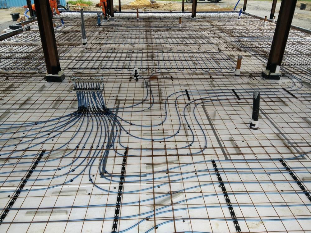

IanR Posted September 24, 2016 Share Posted September 24, 2016 Just to mention an alternative option for fixing UFH. On mine UFH clip rails fitted to EPS, pipes into clip rails, mesh over the top. I'm having a heart attack with every hole drilled into the slab (mostly to bolt down sole plates), so am grateful of having the pipe generally 75mm deep into the concrete. Pipe was also protected by the mesh while being walked over during the pour. Link to comment Share on other sites More sharing options...

MarkH Posted September 25, 2016 Author Share Posted September 25, 2016 Ok thanks folks. We'll stick with the mesh - can't see a good reason not too - and probably attach the pipes to it. Link to comment Share on other sites More sharing options...
