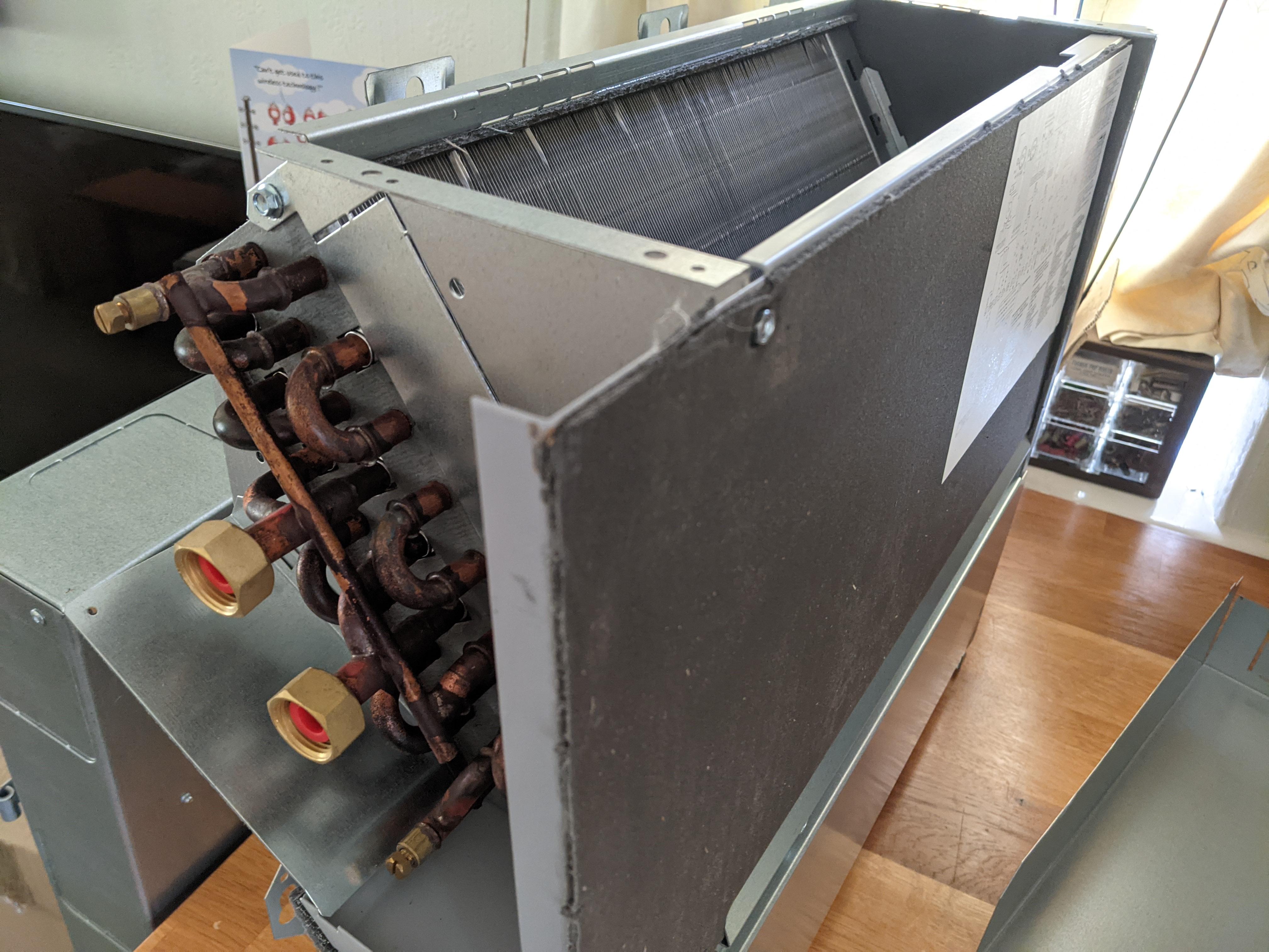

joth Posted March 20, 2021 Share Posted March 20, 2021 (edited) On 26/09/2020 at 11:01, joth said: It has arrived! Although the box it arrived it was 90% destroyed, visual inspection it seems ok and mercifully the loose items in the box were still there. Next up will be an electrical and water (air??) leak test €289.00 delivered from ShopClima, took about a month from order to on-site Well 6 months on we finally got this working! I won't quite say commissioned yet, as we're still running the FTC6 in single zone for fan coil + ufh, but now the plumbing is all complete I can think about getting the control systems properly working. (I say plumbing is complete, there's still a broken flow sensor to replace) Progress has been so slow with our MCS installer I actually got my main contractors plumber to help me debug the fan coil yesterday. The issue was obvious, looking at that photo above the red things in the threaded connectors are bungs. Kinda important you remove those before hooking it up, else no water ain't flowing anywhere. Would have been nice if the MIs has mentioned that! Being in the loft, this is obviously the highest point in the system by quite some way, so bleeding the system has to happen here. It has manual air release vents but it'd be nice to have automatic ones (or a system fill point up there next to it) to allow single person system pressurisation. Anyway, bit of a faff but I think this is really going to pay off come summer. It's amazing how no one at all on our build has ever seen anything like it. Thanks RHI random restrictions. They're so common on the continent. Glad I read about it here. In a pinch a plinth heater would also have worked I think, but for cooling we'd have to DIY build a condensation tray and ensure it doesn't get into the electrics. Edited March 20, 2021 by joth 6 Link to comment Share on other sites More sharing options...

Nickfromwales Posted April 17, 2021 Share Posted April 17, 2021 On 20/03/2021 at 13:02, joth said: Kinda important you remove those before hooking it up A cheque for £50 and a 1st prize BH ribbon is winging its way to you in the post 1 Link to comment Share on other sites More sharing options...
