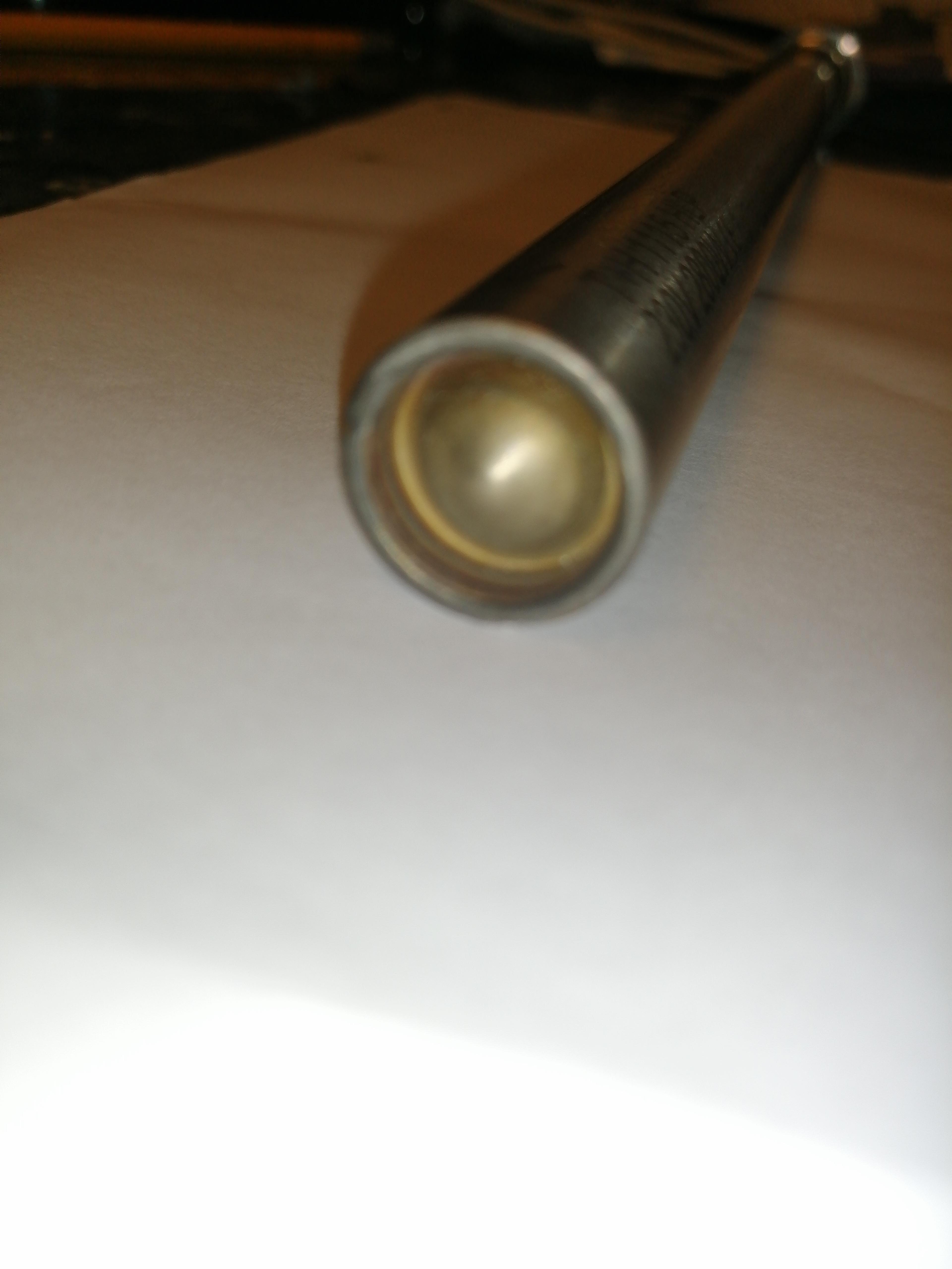

MartinP Posted July 3, 2019 Share Posted July 3, 2019 Looks like my SunampPV killed its 3rd heating element in 2 years (and second one was on the day of replacement of the 1st one). Its not burnt, still steady 17Ohm when cold, just leaking to the earth (about 260kOhm there) so RCD trips away. As Sunamp support has the usual dislike to emails / catch-me-if-you-can phone attitude - does anyone know if it is stock item or... its Sunamp special? Quick check shows its 2800W HLP version from https://www.tuerk-hillinger.com/products/ - but ones in their catalogue only go up to 1000W At his point I'm thinking that Willis inside is a bit undersized / prone to overheating, so... would the control board cope with 3kW/11-inch element in an external one? Don't want to hack it... but if this is the way to keep it working, so be it. I really like it, when it works. Link to comment Share on other sites More sharing options...

MartinP Posted July 3, 2019 Author Share Posted July 3, 2019 5 hours ago, JSHarris said: Is this a Sunamp PV? Yes its the PV. I think the overvoltage to 248-250 is part of the problem, element is rated 2800W @230V. That does not quiteexplain why the heating element would leak to earth - instead of burning out - is it simply ceramic getting wet due to leak caused by overheating/expansion of the tip of the sheath? It does looka bit like press-fit (photo of the old one) Link to comment Share on other sites More sharing options...
Temp Posted July 4, 2019 Share Posted July 4, 2019 260kohm equates to about 1mA leakage current. Bit low to trip an RCD? Link to comment Share on other sites More sharing options...
Onoff Posted July 4, 2019 Share Posted July 4, 2019 4 hours ago, Temp said: 260kohm equates to about 1mA leakage current. Bit low to trip an RCD? Depends when he's measuring it as to how "real" that figure is. You often have to be real quick. As a test I've measured elements causing nuisance tripping as NOT being down to earth when cold. Chucked them in a pint glass and topped up with hot water out of the kettle and watched the resistance to earth drop like a stone as the casing expands and damp gets in. Take it out, dry it off / let it cool down and the resistance goes back up. Let's face it a mere IR test can "dry out" a damp motor. Has the RCD itself been checked & ramp tested? It might have a tripping threshold of maybe 25mA...the standing protective conductor current might already be close, cumulative from other circuits and its not taking much to put it over and trip it. I'm sure Sunamp's technical department will help... ? Link to comment Share on other sites More sharing options...
