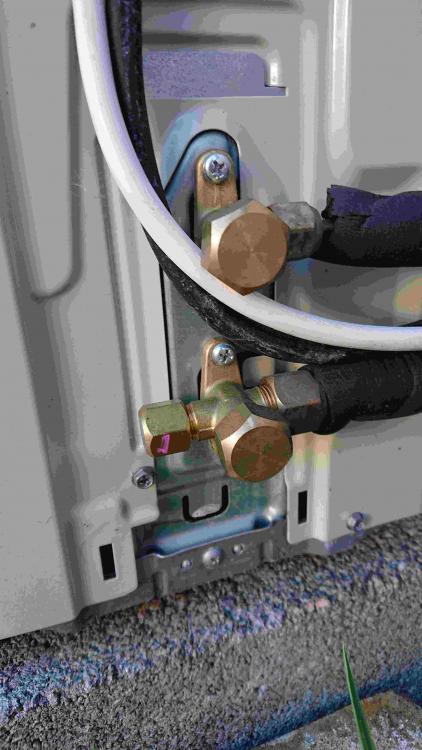

    Just to close this off, I finished commissioning the Toshiba unit this afternoon (good timing, probably the hottest day of the year).  It was delayed by me not realising I needed an adapter to allow t
  • We had a small precharged split unit purchased in Belgium 12 years ago. The unit came with instructions on how to separate the two units to allow the pipe to pass through a hole in a wall. As I recall

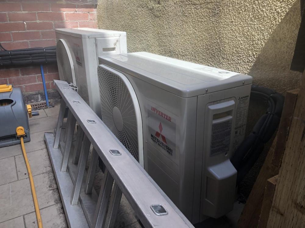

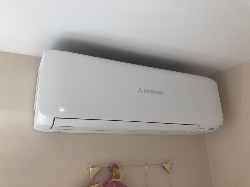

I fitted 3 of these now well this 1 and 2 others.
