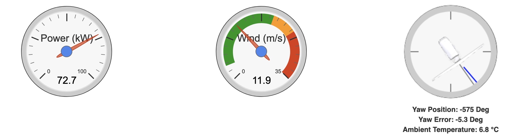

You don't need an 'expert'. You *need* someone who knows what they are talking about!... and they are like hen's teeth, sadly. Lots of rather negative sentiment towards wind in this thread and I can see why. It has been traditionally much more expensive than PV in terms of bang for buck but with the advent of good (ie Li-based), cheap batteries and electricity prices trippling (not to mention the same happening to new mains electricity supply costs) I think it's time battery + wind got another look. The other issue is *location*. I'm on a Hebridean island and have access to the data from a 100kW turbine a few hundred metres away. Typically, for the 4 months of winter Nov-Feb, the *average* wind speed here (or at the turbine site) is 8+m/S. That's *average*... for 4 months of the year when electricity use is highest! Even a very modest turbine would make a huge dent in the average households energy use with that much wind on tap - assuming you have the flexibility of storing it n a battery for se when it is needed, not just when the wind is blowing a hooly. A 1kW HAWT would generate 12kW/day easy. Cost? Under £1k (+installation) plus another £4k for a decent chunk of 10kWh battery/5kW inverter/2kW turbine controller, again plus installation (not beyond the realm of competent DIY, of course). But ideally you would want a good-sized PV array for summer, too. 4kWp would do for most people especially if they space/water heat with a heat pump (or wood burner, of course). But, like I say, there just seems to be a complete dearth of users with good experience of small scale wind and the time/inclination to write about it.

...at the moment about 80% of that is going onto the grid (50kW max - any more is burned off in warming the log store, ie wasted)... and the *average* wind speed for the 4 months of last year, here (Nov-Feb) was 8.5m/s...
