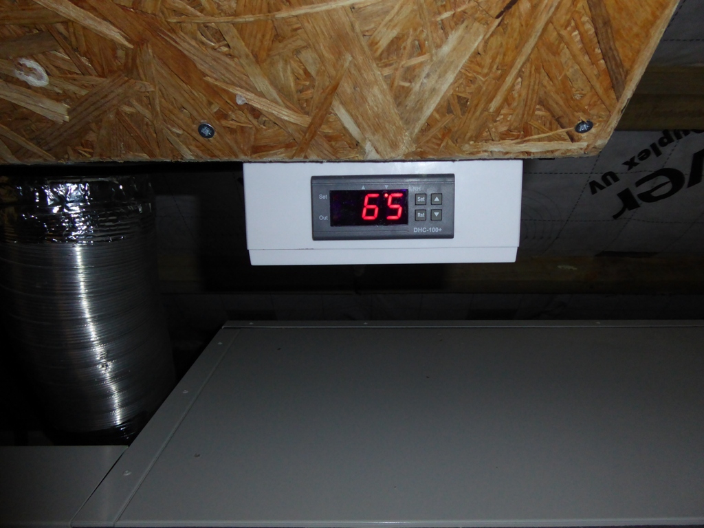

The programmable humidity sensor and switch I used was this unit from Poland: https://www.ebay.co.uk/itm/DHC-100-Feuchtigkeitsregler-Hygrostat-Humidity-Control-Sensor-Fuhler-2-meter/182951476628?hash=item2a98c1fd94:g:hAgAAOSwFSxaKeA~
I put the remote sensor inside the extract plenum chamber and it seems to work well.  Boost turns on within a few seconds of a shower starting, or even just from the steam from making a cup of tea, and the unit can be programmed with a variable turn off delay and RH hysteresis.  I fitted the controller inside a surface mount box, in the services room, just above the MVHR:
I bought one of those and it's still sitting in it's box unused. I have never found it necessary to increase the extract fan speed.
