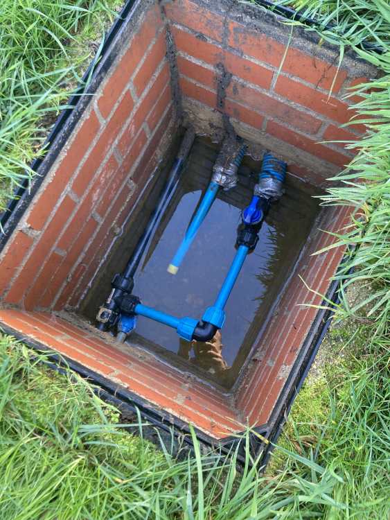

How to waterproof a brick built manhole

Fair enough. whats the best way to waterproof the duct? A bit of expanding foam as a backing and then a bunch of bathroom sealant ? Any advice on the best type? -
So I have a brick built manhole (engineering bricks on a concrete pad base) where the water supply is split into three and when it rains heavily it fills with water (very high water table). I presume water is getting in through the joints in the brickwork. Water is then getting into the duct and reappearing where it comes up in a barn (which is lower than the manhole level) causing a minor spillage. two questions: 1. Best way to waterproof the manhole itself ? 2. Best way to waterproof where the duct starts (as in the blue pipe and the blue duct in the picture)? any suggestions? I do see some blocks where the ducts exit so don’t suppose those are waterproof but I presume some water is getting in through the joints.

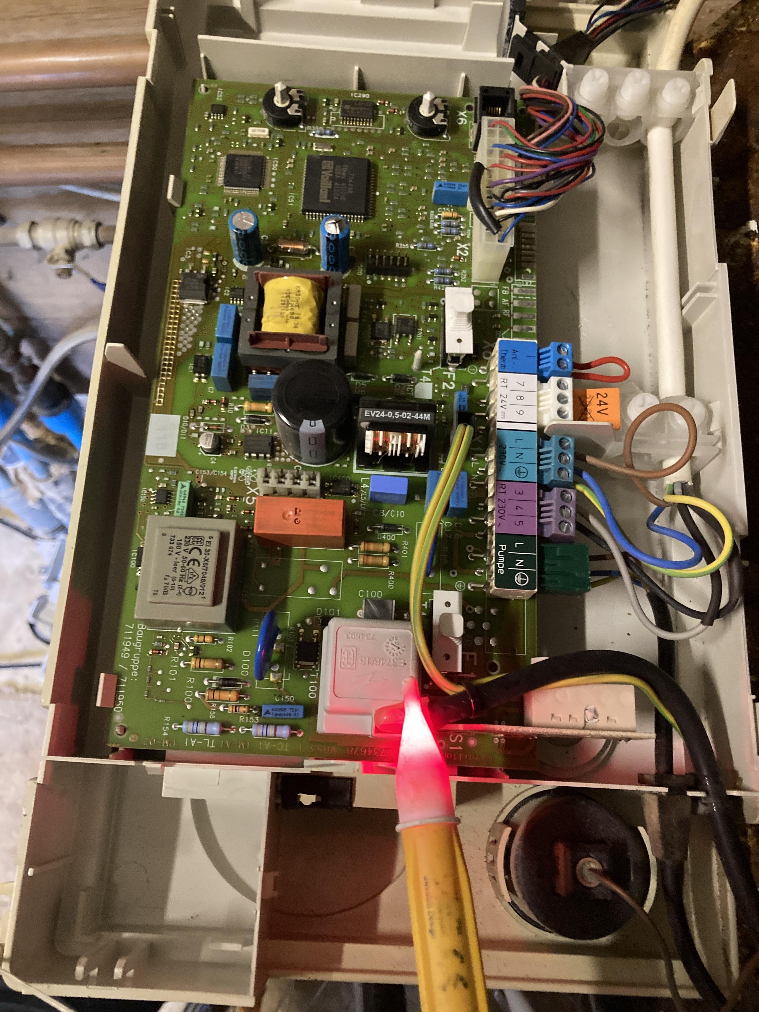

Blimey - didn’t see all the replies before ordering a reconditioned board. Arrived last night and fitted this morning and all seems to work! let’s hope it continues for a while! thanks for the replies
My Vailant ecomax 828/2 E boiler has decided to not turn on any more. turn the on switch and no display and no firing up. Switch appears to do something as the voltage detector lights up in the picture when the switch is on but not when it is off. What would next step be? just replace the whole board? bit confused most replacement boards seem to cost £250ish but this here appears to be £35! https://www.heatingandcateringparts.com/product/vaillant-ecomax-824-828-835-e-pcb-711949-711950-734678-genuine/?gclid=CjwKCAjwkY2qBhBDEiwAoQXK5RpdtYwRR67RgXrRoexafdtI698Wf4yDEJrTipeVSzXC-3ZNJ93H3hoCe_QQAvD_BwE
