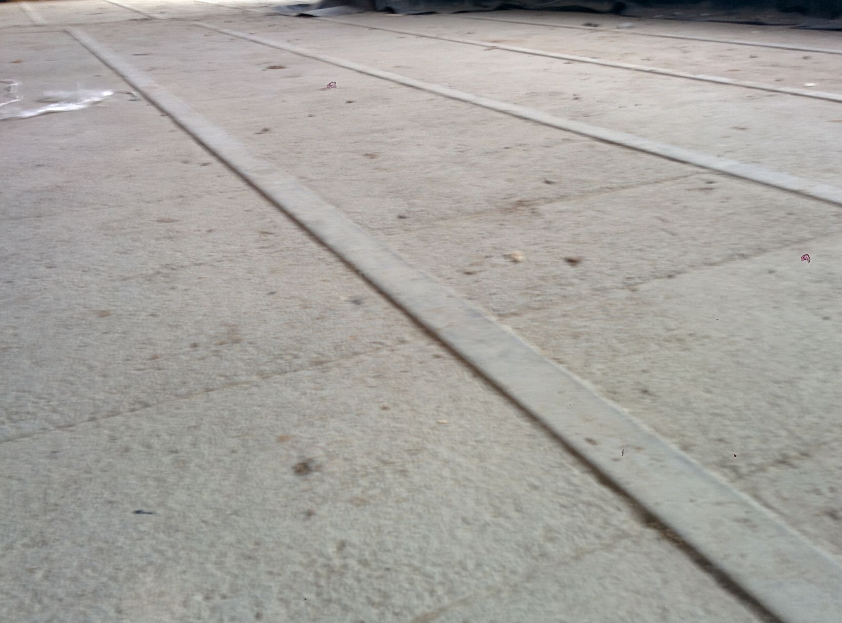

Do I need to be concerned about 3-5mm height difference between the blocks and beams in my sub floor? The plan is for a DP membrane (not sure of thickness), 200mm of PIR foam, ufh in 50-60mm concrete screed, Luxury vinyl tiles. Options I see are: Do nothing 1200 gauge DPM Dry sand Leveling compound Other? Thanks
