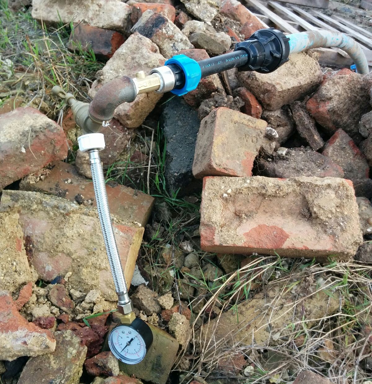

Attic cold water tank - anti-freeze measures?
readiescards replied to readiescards's topic in General Plumbing
Brilliant I'm beginning to understand now. Yes easy to get pipe from garage to house with room for large tank. got a link to an accumulator I can see specs on please? -

I hope so! The zero-flow pressure is good, but it quickly tails off when opening a tap, as per this video https://dl.dropboxusercontent.com/u/55058337/2016-11-10 08.06.52.mp4 Still viable to avoid the cold water tank option? -

Went back 5 hours later and pressure had fallen to 6 bar - odd given there is a one way check valve in the system and no obvious leak. Does 6-7 bar mean there is enough pressure not to worry about cold water tanks in loft etc? -

Sorted through a few boxes on the farm and got it connected - easy peazy this plumbing lark! 7 bar static - will see if increases over night. -

Got the meter and check valve. Can not work out best way to go from 32mm plastic pipe to 15mm check valve. Any tips @Nickfromwales please? -
