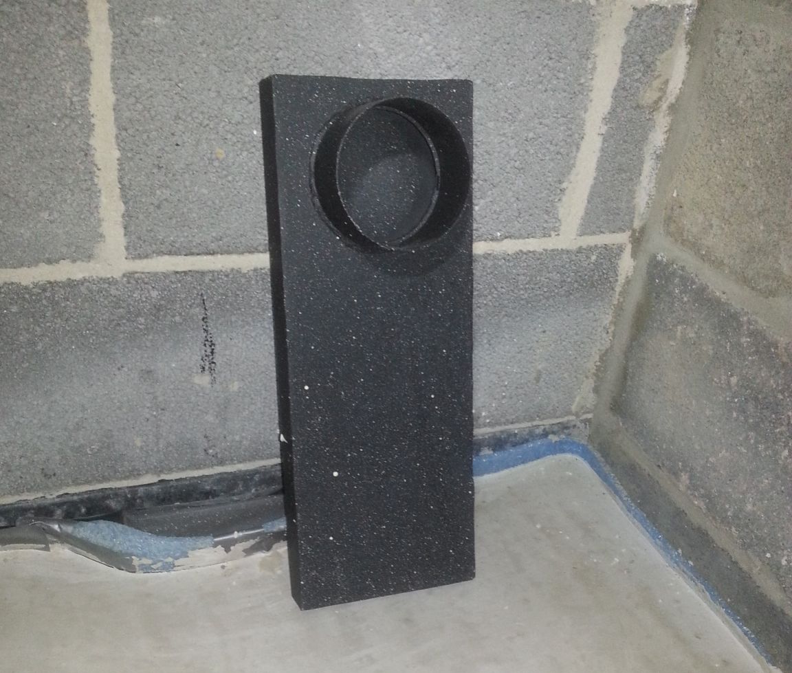

  7. My independent BI is ok with venting my log-burner from the underfloor void - likewise fed with 30+ air bricks. And as the 'direct air feed kit' supplied with the stove is pretty poor me and the HETAS installer have built this metal channel that sits in another metal channel installed before the insulation, constructional hearth and screed went in. The channel then being 'roped sealed'. (The csa of the rectangular part being greater than the circular connection to ensure no reduction in air flow). Untested admittedly at the moment though!

  13. Got an ACR Oakdale as smallest direct air room sealed solution I could find (in cream a SWMBO 'must have'). It was not till we unpacked it after 6 months of ordering we learned the direct air feed vent was at the rear instead of underneath so we fabricated a sliding adapter that feeds the stove from the void below the beam and block floor. This was installed before the functional concrete hearth and screed, getting on for a 700mm long duct!

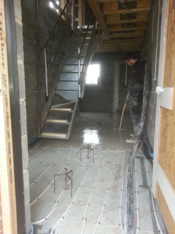

  20. What tips/advice for post treatment of liquid screed please? (Done by ScreedIt using locally sourced screed mix) A google suggestions: http://www.bal-adhesives.com/tiling-onto-calcium-sulfate-anhydrite-screeds/ Laitance should be removed by light abrasion using a suitable sanding machine i.e. a rotary floor scarifier and a 60’s grit sandpaper. Remove excess dust completely with a vacuum cleaner. Abrading the surface is best carried out 4-6 days after the application of the screed and can assist in the drying out process. Scarifying the surface is even recommended with low laitance Calcium Sulfate/anhydrite screeds as this further aids adhesion. Anyone done this, anyone done any different? Any tips much appreciated
