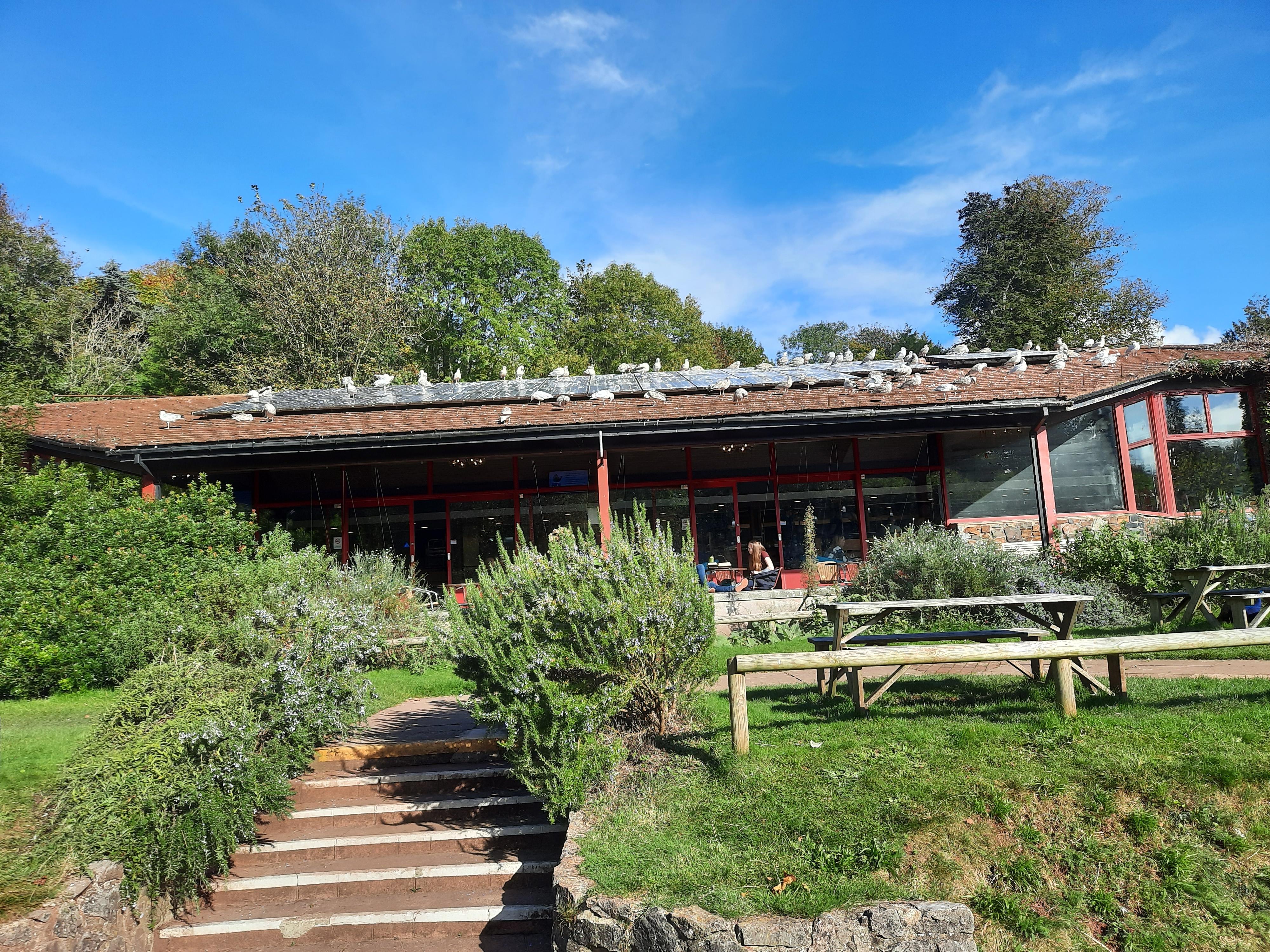

  11. Some of the panels are covered in 40% guano!
  12. For some reason the PV is not producing much power today.
