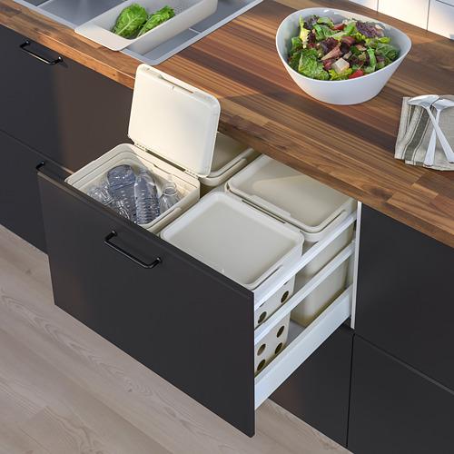

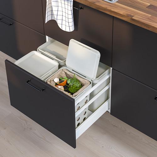

BIN DRAWER Not like this: But like this: With lids removed and 2x large size bins in a 600 wide drawer. Make mess. Open drawer with clean hand. Sweep off worktop into bin with dirty hand. Close drawer. Open drawer. Dunk teabag in bin. Close drawer. No missing. No splashing. Honestly life changing. It...doesn't smell if emptied weekly...unless you fill it with the kind of smoked fish that stinks the place up before it has a chance to rot. Smoked fish day = bin empty day. 🙂 We also have a waste disposal for goo. We started with only this but since getting putting the bings in a drawer and the tins on shelves under the sink a lot just goes in the bin these days. Try it by sticking a bowl in a drawer and filling that? -

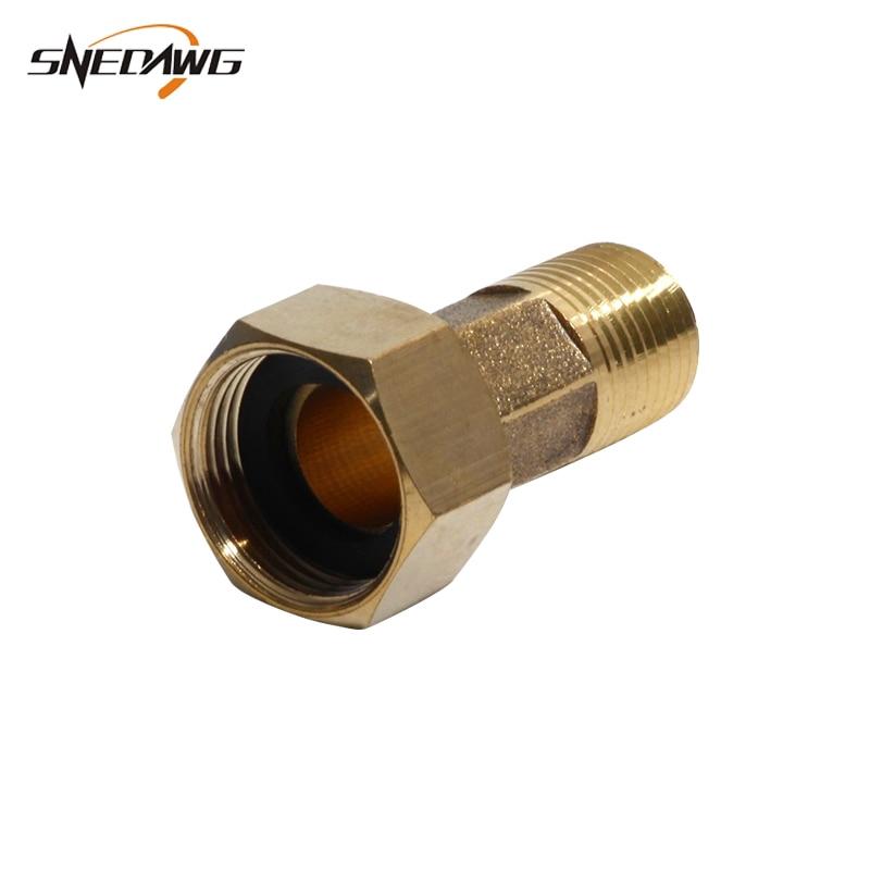

Are there hoses the right size? You usually use union nuts withmale bspt thread one side and a flat face female bspp the other for meters etc. e.g. R1" male bspt to go into 1" female taper in heat pump; and then the other side of that union coupling is a G1 1/4" female flat face to suit the hose which is fatter than the equivalent copper for the same internal diameter.
