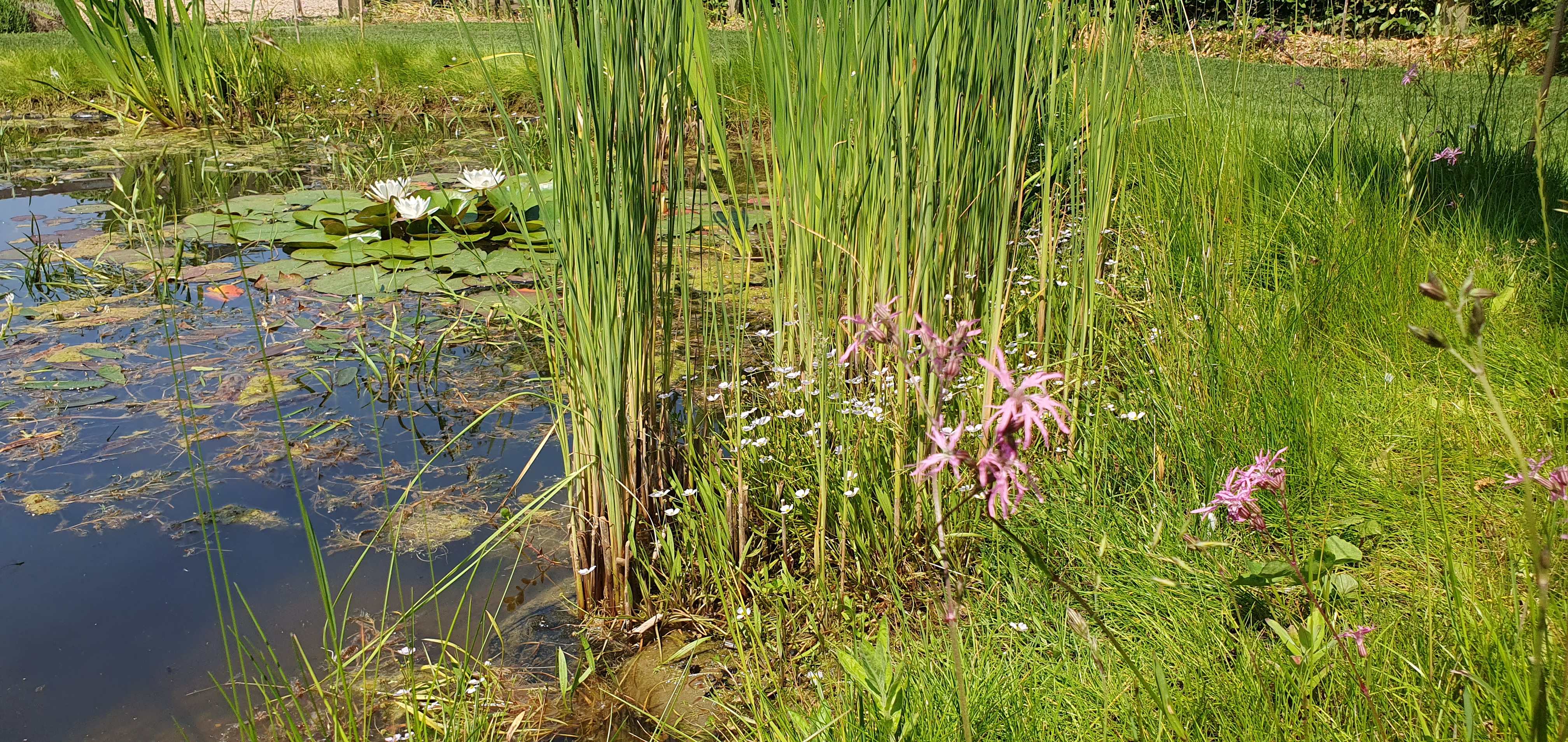

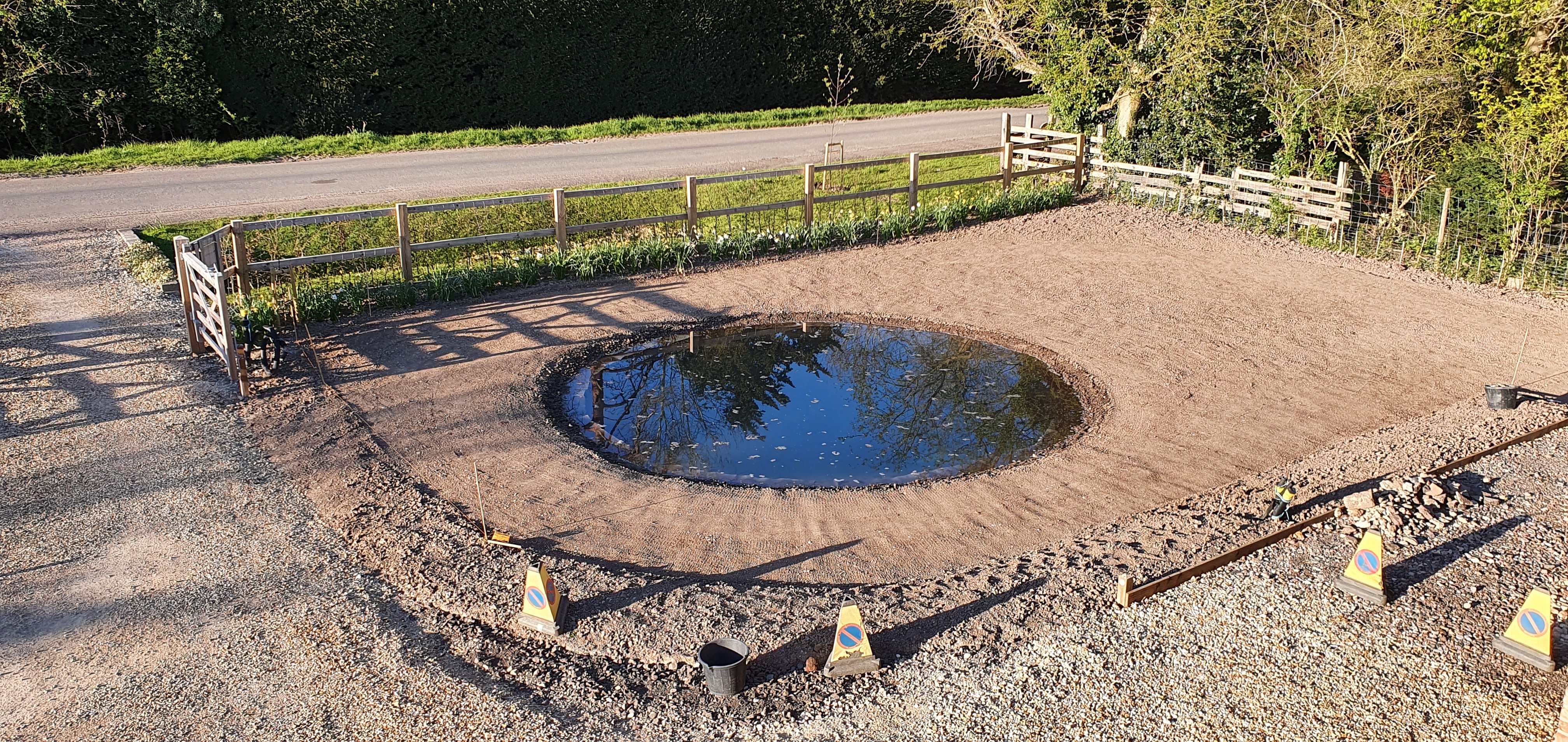

Show me your pond!
Roundtuit replied to canalsiderenovation's topic in Landscaping, Decking & Patios
That's the only one of three that made decent progress, and that's still probably the case 3 years on tbh. I did make an early mistake of using garden soil for some planting, so maybe a nutrient overdose. -
Show me your pond!
