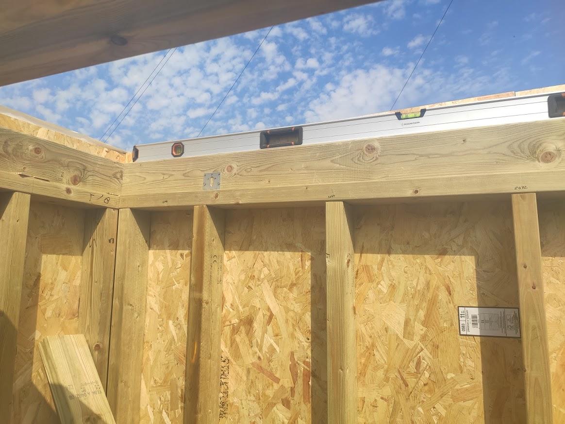

Feedback on timber extension structure
JackOfNoTrades replied to JackOfNoTrades's topic in Timber Frame
Good point. And actually I don't really need that extra joist by the side of the wall, so I can extend the flying rafters to the next joist. It's only a 68mm extra overhand on that side, but it also removes the (unnecessary) weight of the extra joist on that wall. -
If I raise the height of the front wall by reducing the depth of the fully supported joist, I can have an uninterrupted top plate that spans the distance (highlighted in green). Still not perfect but potentially much more structurally sound. In this render I've hidden the front joist so you can see everything. And a side view to show the full depth joist next to the wall, and the shorter joist resting on top of the (higher) front wall. A little unconventional maybe, but could this have solved my problem of the lintel being too high? -
Good point. I assume you mean to the left of the bifolds. That part is a bit of a challenge - there is actually no fully binding top plate at the moment because of the shape of the ceiling. I've removed the joists in this image to show what that looks like. The current lintel is 75mm too high to sit under a top plate. I can't raise the top plate because a joist needs to sit on top of them .. unless I do have a higher wall and a thinner joist running along the top? -
