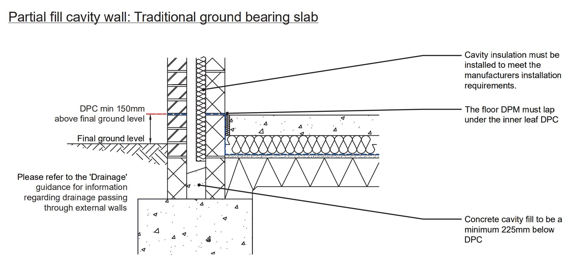

  1. After a review of my plans and discussion with the person completing them, I wanted to check a couple of areas that I think will cause cold bridging. The construction is cavity wall, 100mm dense block inner leaf, 150mm partial fill cavity with 100mm PIR, and a mixture of face brick outer leaf and dense block with composite cladding screening. Weather zone is severe 4 for NW England so blown bead isn't an option. House will be parged, internal insulation and MVHR. 1. The architect has detailed for a a returning block on any opening reveals with a DPC separating the outer from the inner. Would this not be a huge cold bridging area, if so how do i get around it and where would the UPVC windows be positioned for a solid fixing? What are my best options to minimise cold bridging but to not over complicate the window fixing. I've seen someone suggest only a partial 75mm block/brick return of the 150mm cavity then use a push 75mm closer for the remaining part. This adds a thermal break and means the return blocks work out for 175 block & a standard brick above course. or just go full 150mm closer? 2. How do you extend the cavity wall insulation down to the bottom of the floor slab level when using a radon barrier which bridges the cavity. See image detail.

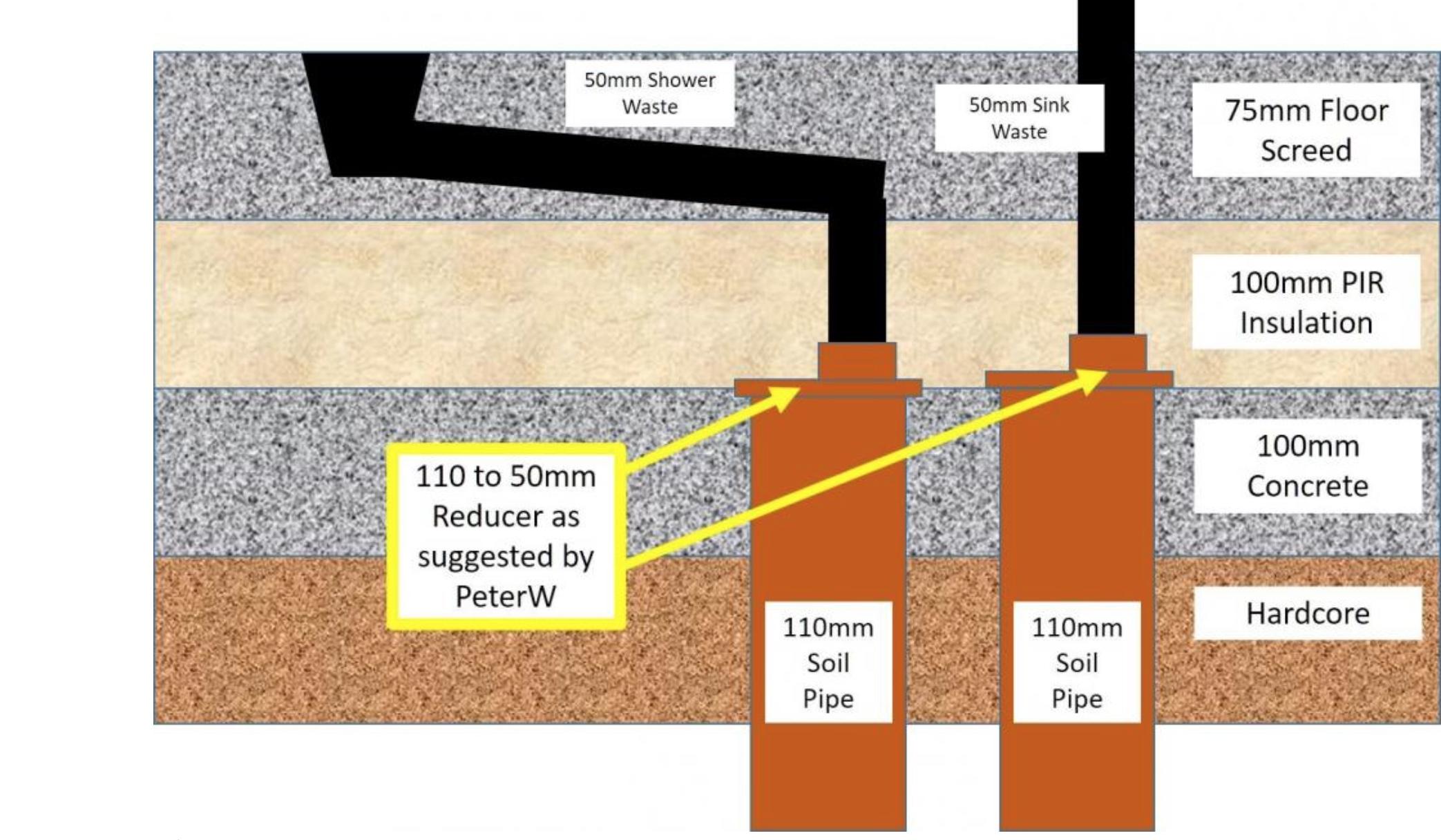

  5. @temp a picture speaks 1000 words as they say, exactly this thanks. The coloured image will be my floor make up, but the tray is in the back corner of the room not on the outside wall. So from the centre of the tray to the outside will be 2100mm. The nearest stack will be 2.2m further along the gable wall (Downstream) from where the pipe breaks out, so I'm thinking it might have to terminate into a gully which will tee into the main 110mm foul which runs down parallel to the gable wall. The ground floor toilet in the same room will exit via the floor slab with a sweeping bend into the mains too. How do waste pipes normally connect to the mains if the stack is't near. My only concern now is referring to the coloured sketch you added which is how I'd have to do it to keep under the screed. With the top of the screed being level with DPC, the outside is 150mm 2 brick courses down to the ground path height. So deduct 50mm screed, then deduct 40mm for the 2.2m waste length at 18mm/m fall, then the diameter of the pipe 45mm = 15mm from pipe to path finished level. I'd have to make a hole in the DPC too. Can a 40/50mm waste tee into a 110mm vertical foul pipe without getting blocked with crap? I always thought basins/baths/showers had to join into SVP higher than where the toilet does.

  12. Not sure if this one is for the plumbing, bathrooms or the design section. For my self build, I was planning on having a beam & block ground floor construction and having a small bathroom or shower room with toilet and sink. The architect has changed the bath to a shower and also now using a concrete slab floor. The make up from top down will now be. 50mm screed with wet UFH inside, membrane, 150mm insulation, 100mm concrete slab, membrane, sand blinding, stone. With a P shaped bath I was planning to keep the waste pipe above the finished screed tight against the wall with some boxing in as it leaves through the wall to an outside drain. How if possible can I fit a shower trap into a screed floor along with the 40mm waste pipe and not clash with the UFH pipe which was planned to cross its path? Normally you'd bed the stone resin tray down onto a finished surface and ensure the trap fits correctly but the pipe would already be encased at this point with no play in it. I could possibly replan the ufh pipe route so it wasn't in the way but I'm not sure how to install a shower waste pipe and trap so that it's in a finished position before the floor screed. Once set if wrong it's a disaster. Any advice from plumbers or designers would be appreciated.

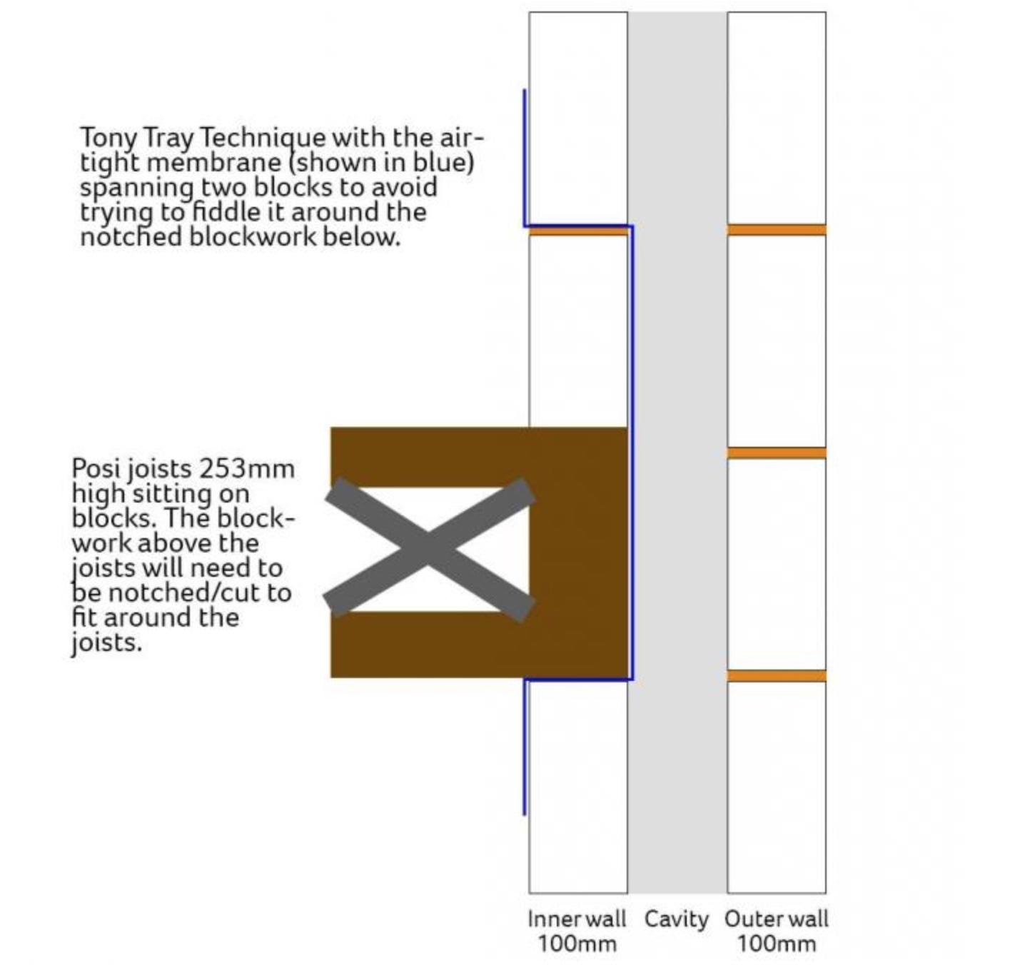

  15. I'll make enquiries about top hun joists. Would the TT still be used for this? My thoughts with both chords sat on the wall using the TT method and 253mm joists, with the wall ties being every 2 courses of block at 450mm, the spacing won't work out. The membrane would have to go up an extra course higher to avoid feeding it back in through & around notched blocks. It is possible as per a previous diagram someone posted on here which you replied to, but it would mean having the wall ties on the same course as the joists are sat on as well as the membrane under them, there would be no mortar to secure the wall ties down if they're slipped under the membrane. Having them a course above or below would pierce the membrane. Unless I misunderstanding it, I can't see how to work it around wall ties.
  16. I didn't think top hung was possible, I suppose with a bearer under the bottom chord as well, then it has good support, but top hung with bearer over the bottom chord, what benefit would that have? Are you still suggesting to use the membrane wrapped around the joists?

  18. Thanks for the photo, appreciated. It certainly helps with that gap behind to run services as that was the only draw back I could think of. I need to discuss the 3 options with my architect, I've been back & forth between wall bearing using tony tray, masonry hangers or ledger board. The joiner I'll be working with & the Architect are most familiar with wall bearing joists but not so familiar with airtightness to a high level. The three options seem to be similar in cost. TT requires the membrane which I need to check which type is used & further info on installing end & corner detail. Ledger board requires cheaper hangers and resin fixings and masonry hangers are a little bit more expensive but probably the easiest install method. There doesn't seem to be a lot

  22. At this stage I'm able to discuss these options and they can take it to the SE if required. Somethings require one others don't. I think the ledger plate would require some SE input. Adding the membrane around the outers of the joists Tony tray method seems a good way to it when using 253mm joists. Pending how the block work is fitted around that size of joist ends it could end up with notched blocks and more potential for air leakage. Using hangers hung from 2.7m down would leave 2447mm ceiling height, then ceiling board and wall board would leave around 30mm between bottom of plasterboard and ground floor. Slight extra cost for the masonry hangers. The joist company said 253 is standard, they'd have to look to see if 225 or 300mm can work for my spans and the cost. The two things I keep reading but getting no solid answer on are: 1.Masonry hangers can cause a lot of potential air leakage issues in future with partial fill cavity. I thought they'd be a great seal? 2.Masonry hangers can induce a lot more floor spring than wall bedded method.
  23. Were you on standard joists to match your brick work. No issues with springing or squeeks? The 253mm high makes a lot of labour for a brickie, notching around 50 joist ends sounds messy and costly. Manthorpe do a nice joist seal but it's wasted if the notched blocks around it aren't airtight. I liked the idea of no.3 for air tightness & being able to level the floors easily for any block work irregularities, but it requires all of the ledger plates to be nice & straight and it makes it hard to pass services/cables between floors close to the outside walls having to work around the ledger board.
  24. I was unsure if this post should fall under airtightness or build construction. Looking for advice from anyone who's used this depth of joist and considered good airtightness. The joist companies have recommended 253mm deep posi joists for my masonry self build with cavity wall which is an odd size for block work courses being 225mm. How do builders get around this? After speaking to people on here regarding air tightness around joists for a build that will have MVHR, I'm looking for advice on the best way to fix the first floor joists to the inner leaf so I can discuss this with the person doing my building regs plans. There seems to be 3 different methods but I'm not sure which is the best and the pro's and cons. Cost vs labour and airtightness. 1.Joists supported sat on the inner leaf. (Optional Tony tray method) 2.Joists hung off masonry hangers that fit over the wall. 3. A timber ledger board fixed to the face of the inner leaf and secured to the wall by mechanical fixings, then the joists attached via timber joist hangers. Would this method be best for airtightness and make levelling floors easier between inner leaf and inner supporting walls?
