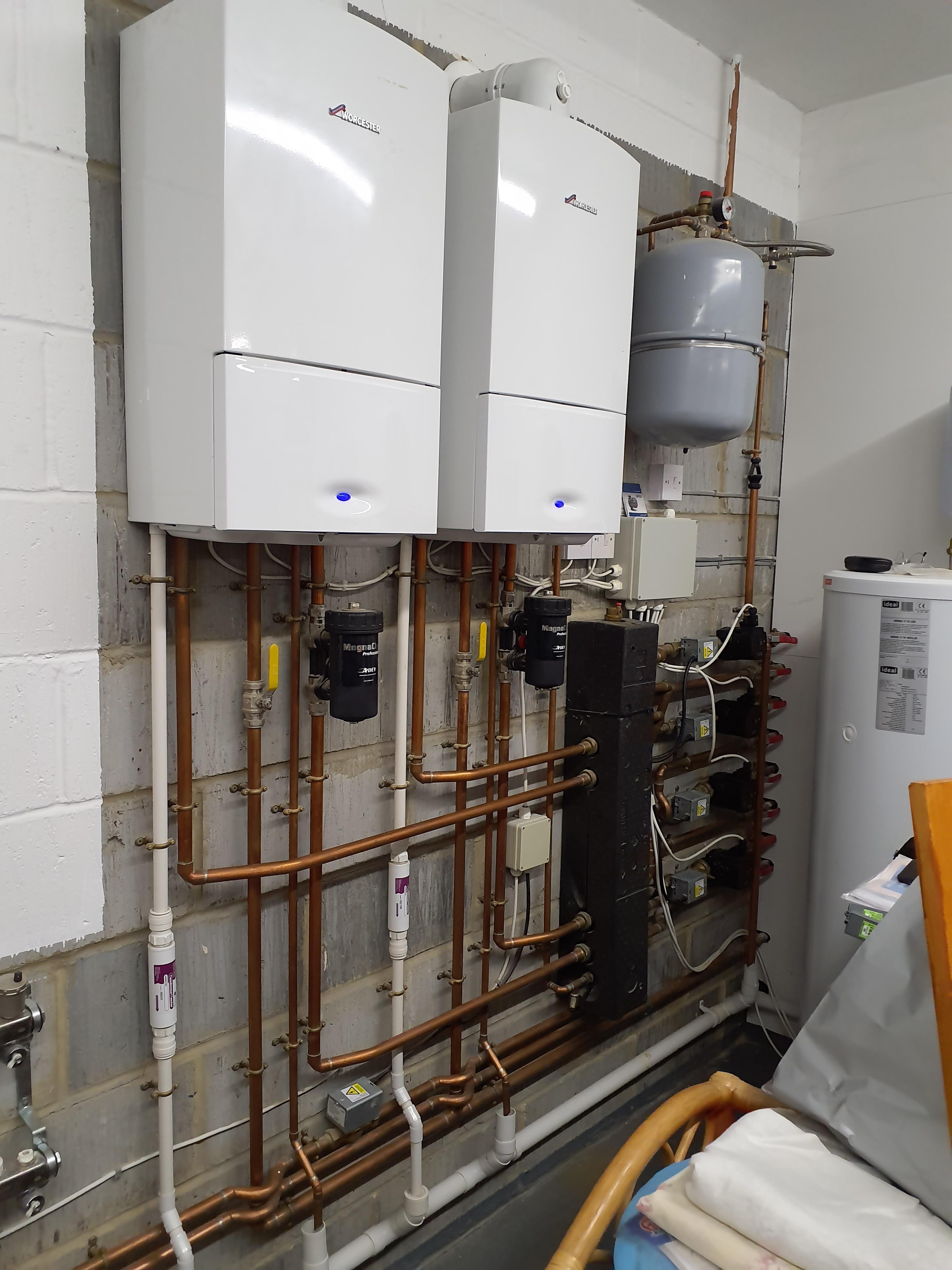

Yes, it's a 2 pipe install. For PDHW the two pipes between the outer flow and returns and gas pipe would be used to supply the DHW. So it is possible to modify your existing installation, but not without some work. I can't quite make out all the pipework in your photos, but you'd need to run pipes from these boiler connections straight to your hot water cylinder and this can bypass your low loss header pipework completely. You'd then modify the existing pipework that currently goes through the motorised valves to your water cylinder and just cap it off. Wiring wise, you could still use your existing cylinder stat, but wire in a Viessmann cylinder demand terminal box which converts the 230v call from the cylinder to low voltage to go into your boiler to run the 4 pipe PDHW. That way you can still control the schedule from your Tado app. Otherwise, you could rewire to hot water control using the low voltage DHW cylinder temperature sensor. That should, in theory, work... -
Heat loss over time (Vented Cylinder)
SimonD replied to marshian's topic in Boilers & Hot Water Tanks
How to measure the remaining HW in an unvented cylinder
SimonD replied to Adsibob's topic in Boilers & Hot Water Tanks
Do you know if your boiler has been installed with the 4 pipe system or 2 pipe system? Take a pic of boiler and pipework below maybe? -
