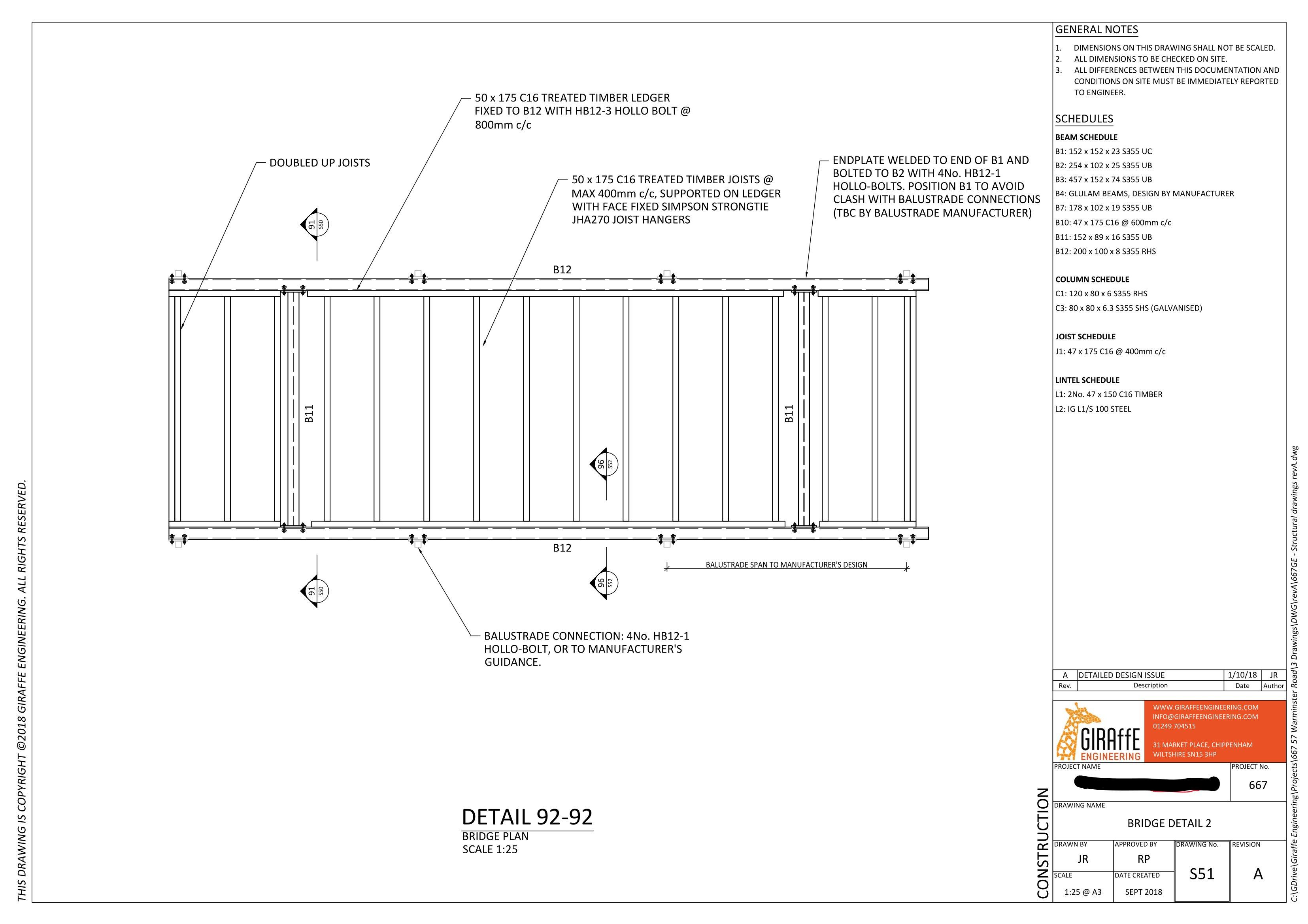

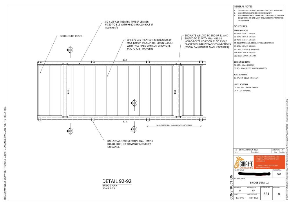

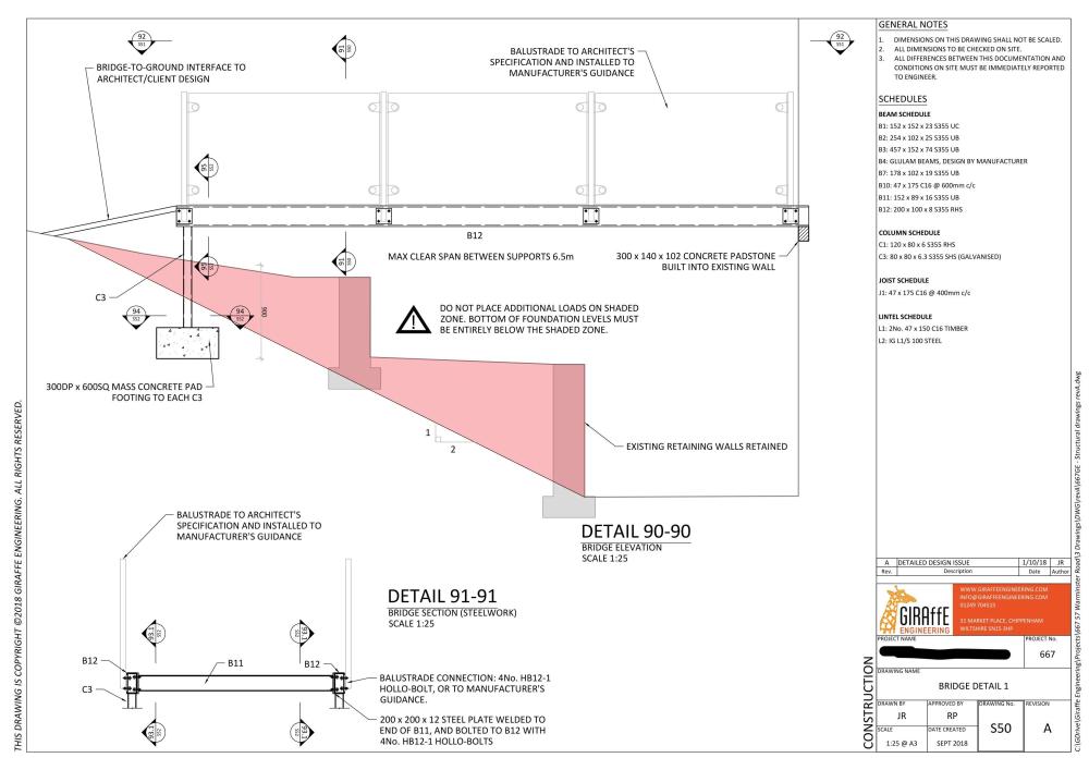

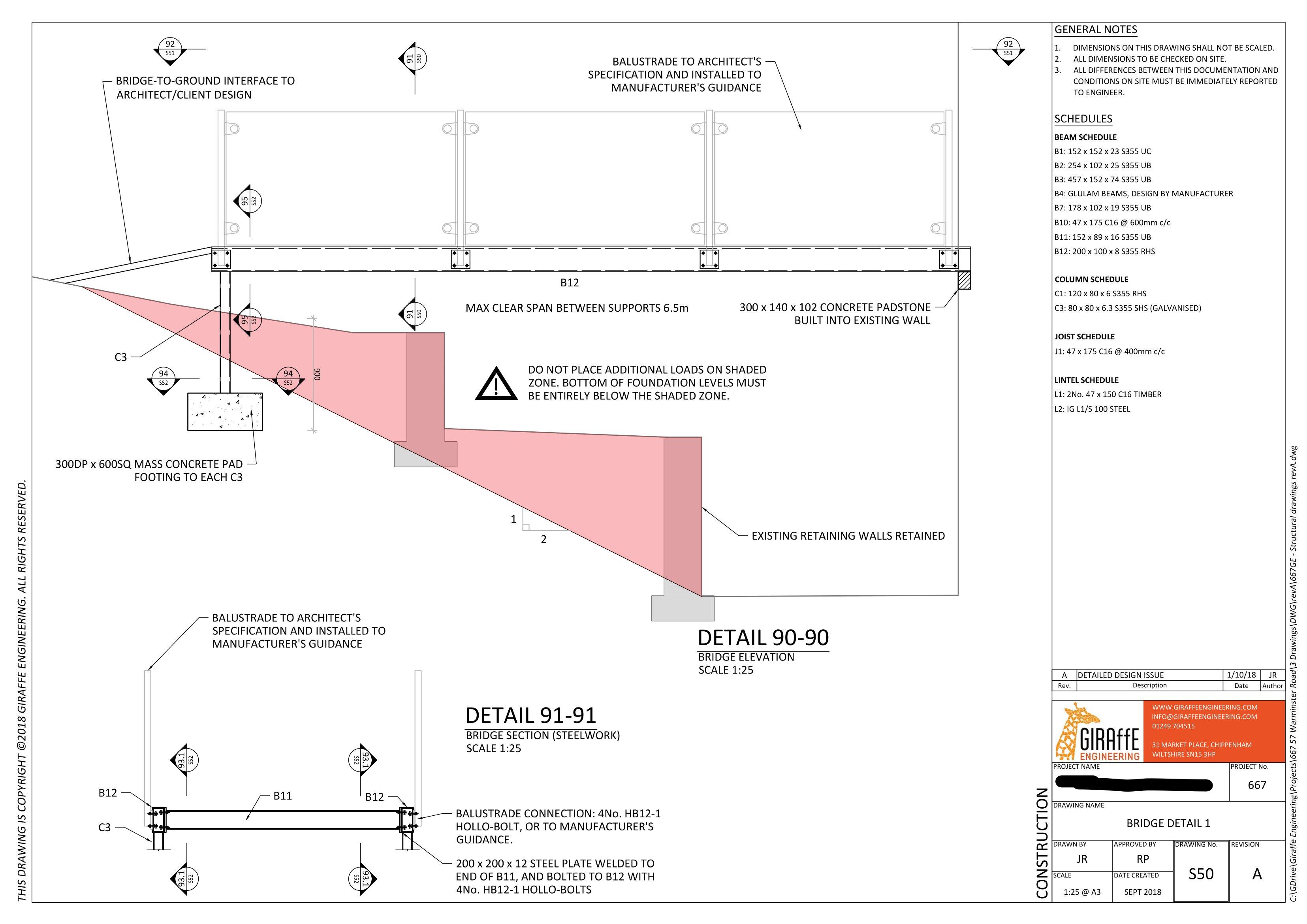

I'm now about to embark on getting my bridge done almost as per details below. We've decided on using a timber deck, which is simply plain treated deck board with build in grip strips. We've change our minds about the balustrade and I though that given the whole top floor of the house is timber, we ought to just go with a timber balustrade. Couple of things I'm pondering. 1. We're actually going to install the deck boards across the bridge not along it so I need to think of the best arrangement to modify the direction of the joists, bearing in mind that the span along the bridge for the joists would be almost 4.8m. Any neat suggestions? 2.how best to fix the balustrade timber posts to the steel columns - do I fix with hollo bolts directly or do I need a bracket which in turn is fixed to the column using hollo bolts? 3. how to detail and make the balustrade itself. 4. any other suggestions ideas on detailing the decking to look nice, especially at the edges just beyond the steels - should I just leave a little bit of a cantilever, or would some kind of edging/frame at the end of the deck board look better?
