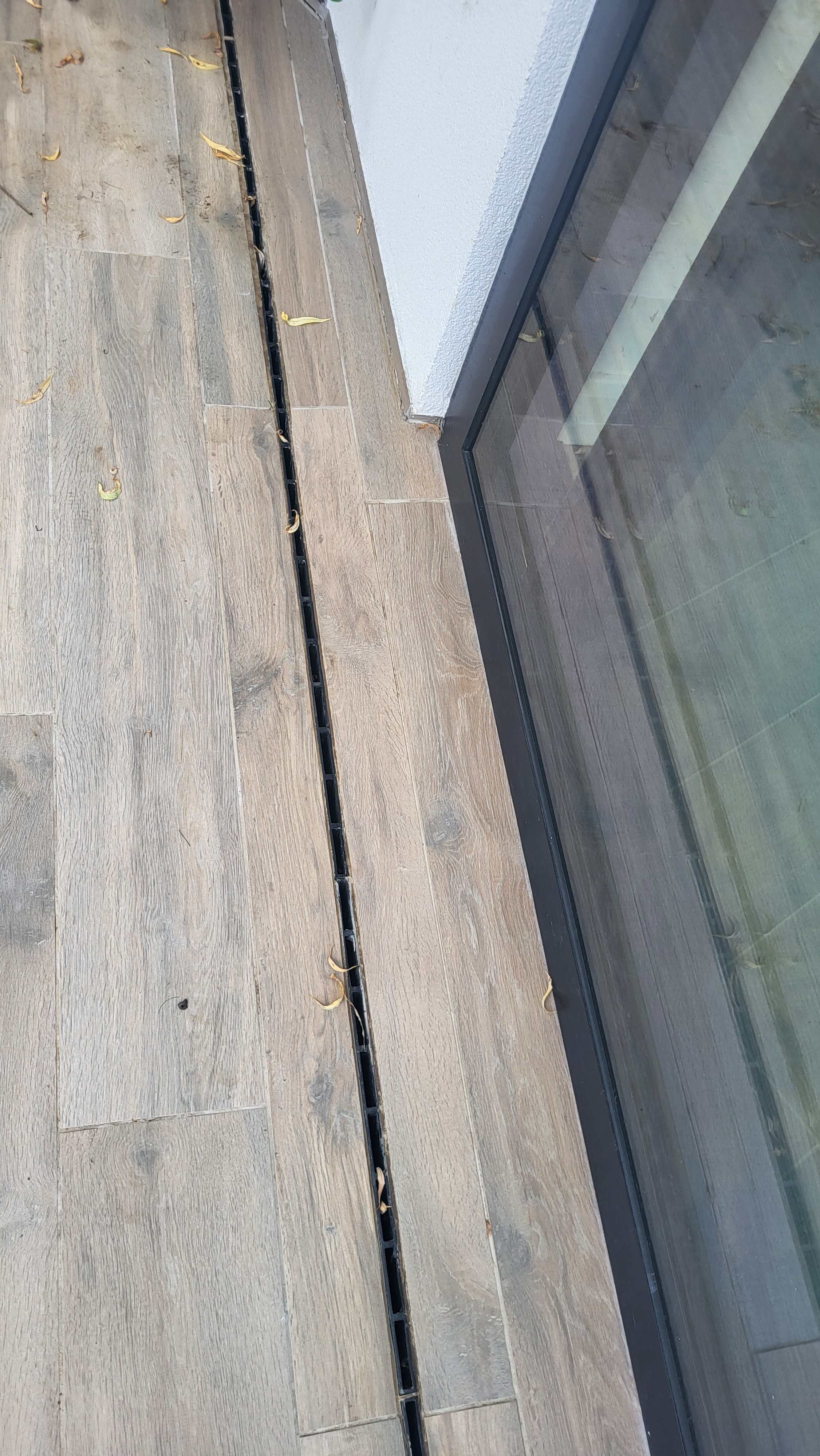

I'd do some posh acro drain all the way round, feeding into the drains you've already got. Grout in some nice tile trim prices. Would do the job fine.
