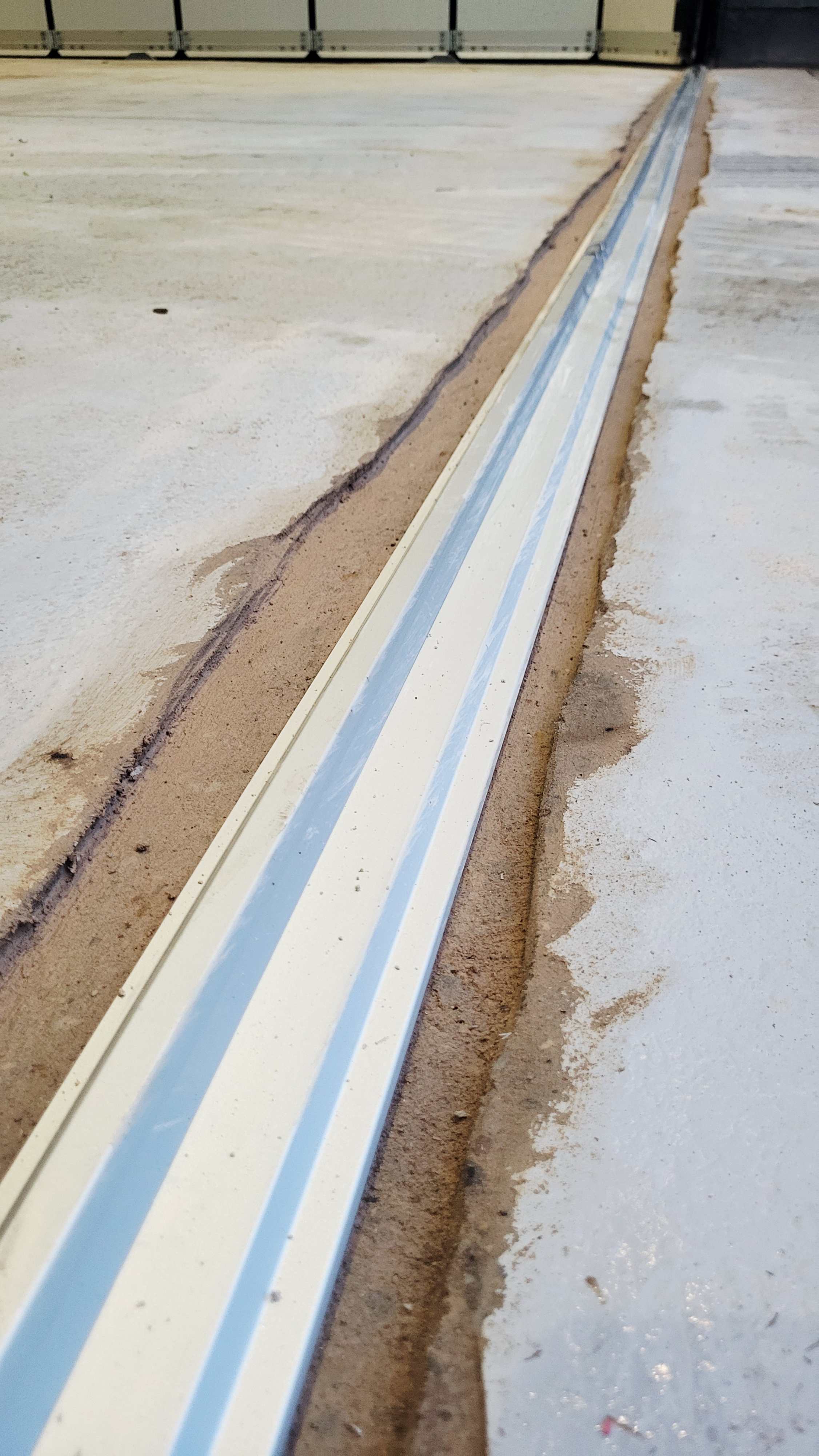

Thank you! Any benefits to adding the SBR to the self leveller?
Thanks, that'll be the plan! Is there anything more I can do for belt and braces, as it will be driven over daily? Additives to the SLC, priming with more then water etc?

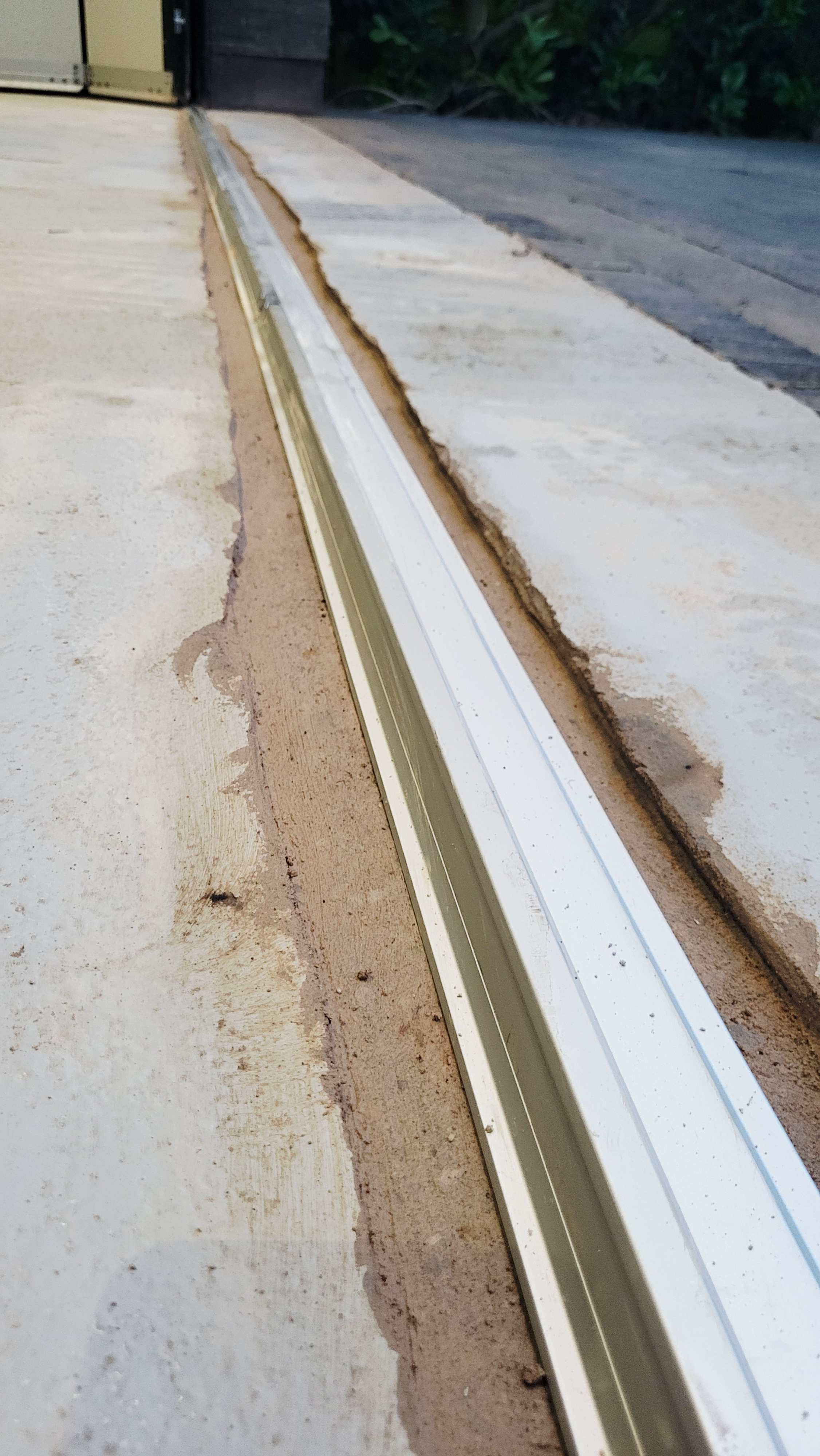

Thanks Conor! That is what I was hoping to hear. Track sits slightly higher, but I'll mask and dam it off slightly and level either side of it.
That's what I'm leaning towards, building a small dam with foam tape or equiv and fill the void? Any ultra high strength ones? Should I prime the floor first?
We have had to have our garage door track replaced due to issue with the sliding door sticking. Hormann & garage door company have been brilliant over the years, but I do now need to try and tidy up the 'final solution' which was grind the floor flat and relay the track. I now need to tidy up this small trench, with the track installed... It is entirely no removable. I just want to improve it visually, and will then repaint with epoxy floor paint. Any tips? Thin concrete mix? Reinforced? Any other clever ideas? Thanks....
