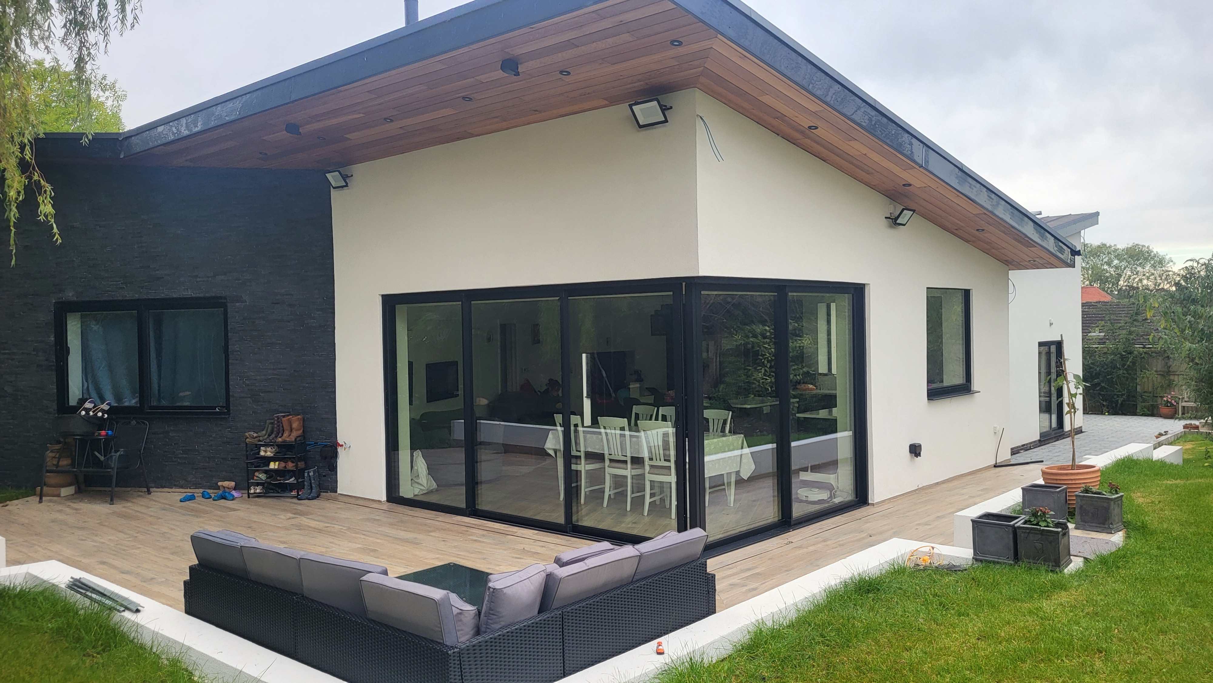

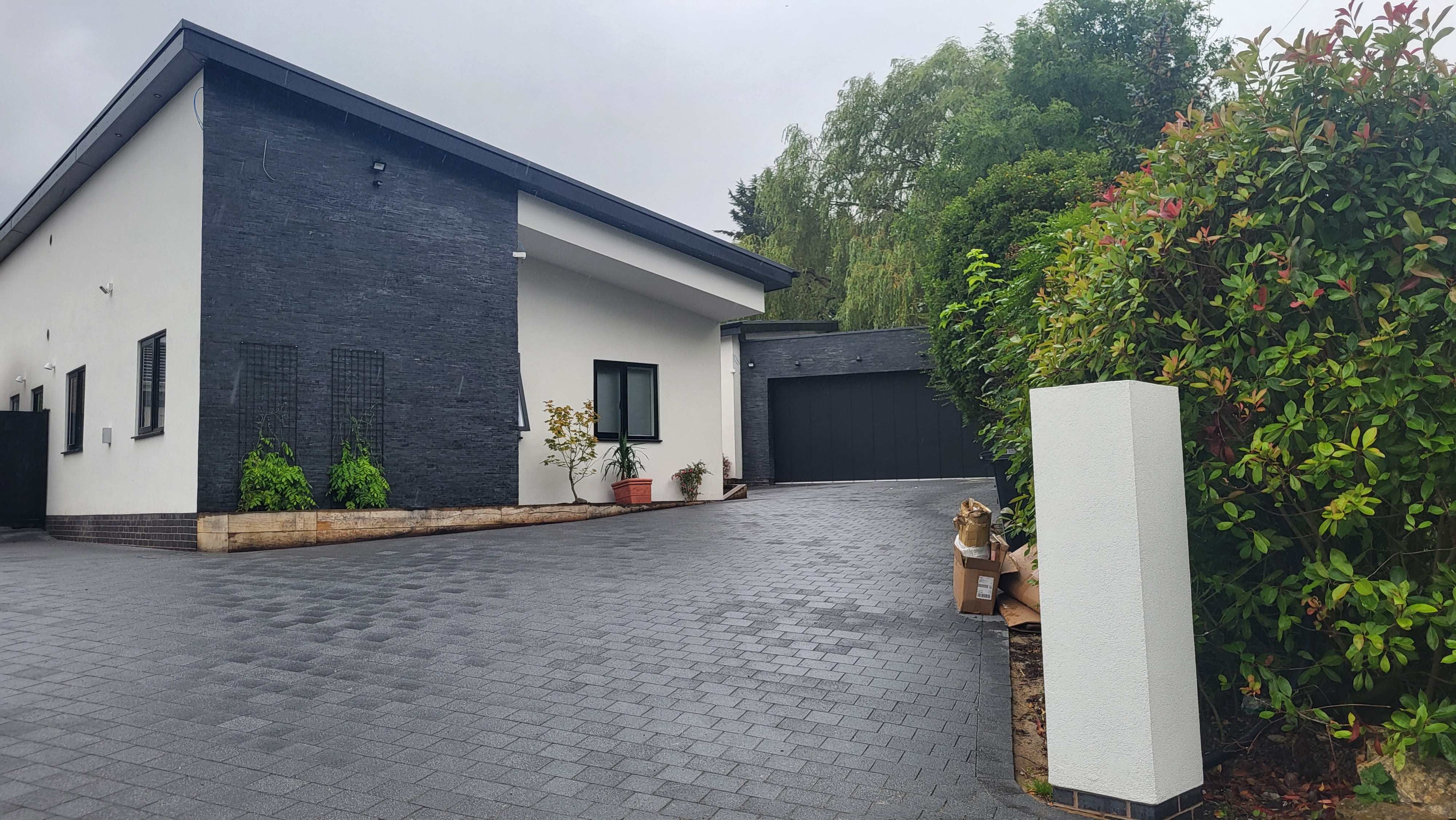

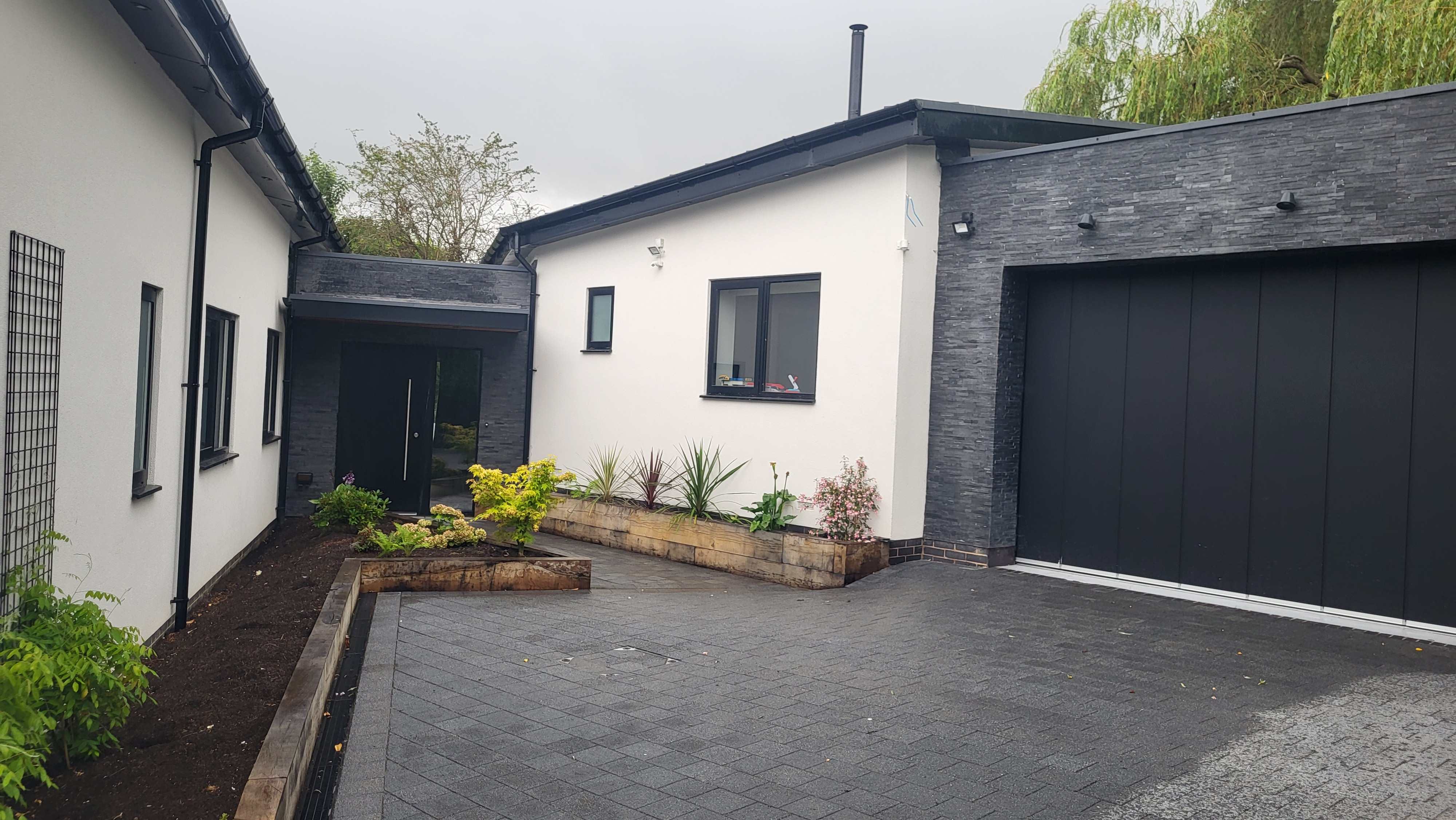

White render, black aluminium windows doors and the slate cladding was the style we went with! The finished off with some nice western red cedar cladding (I think it's called? Expensive stuff!)
