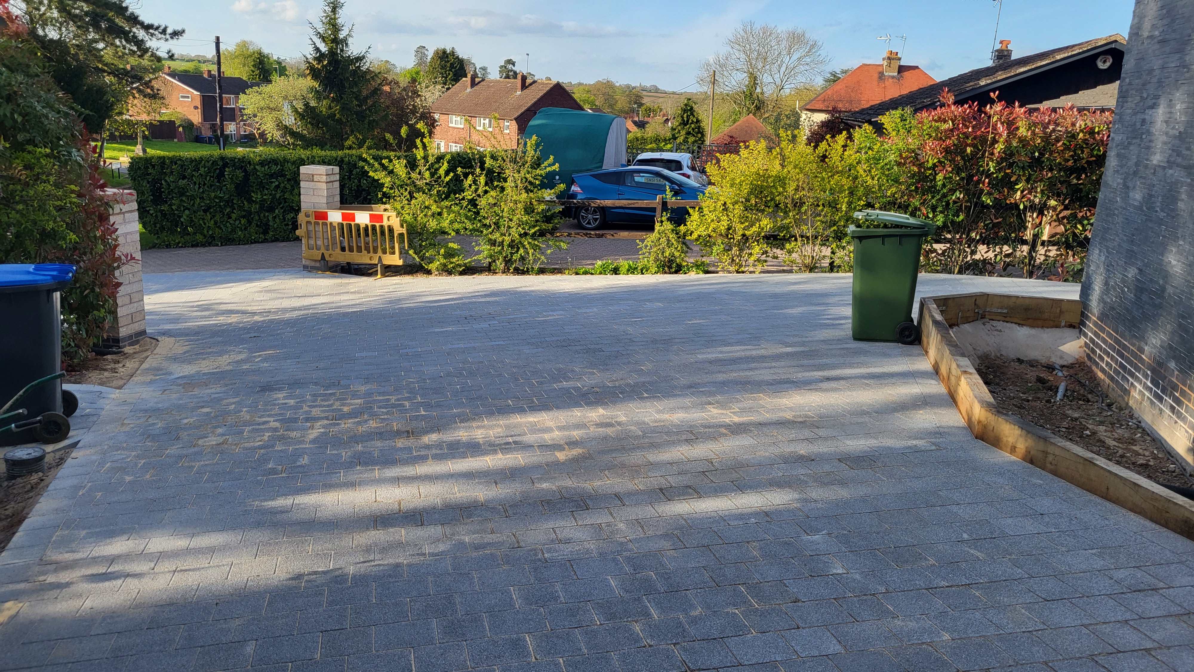

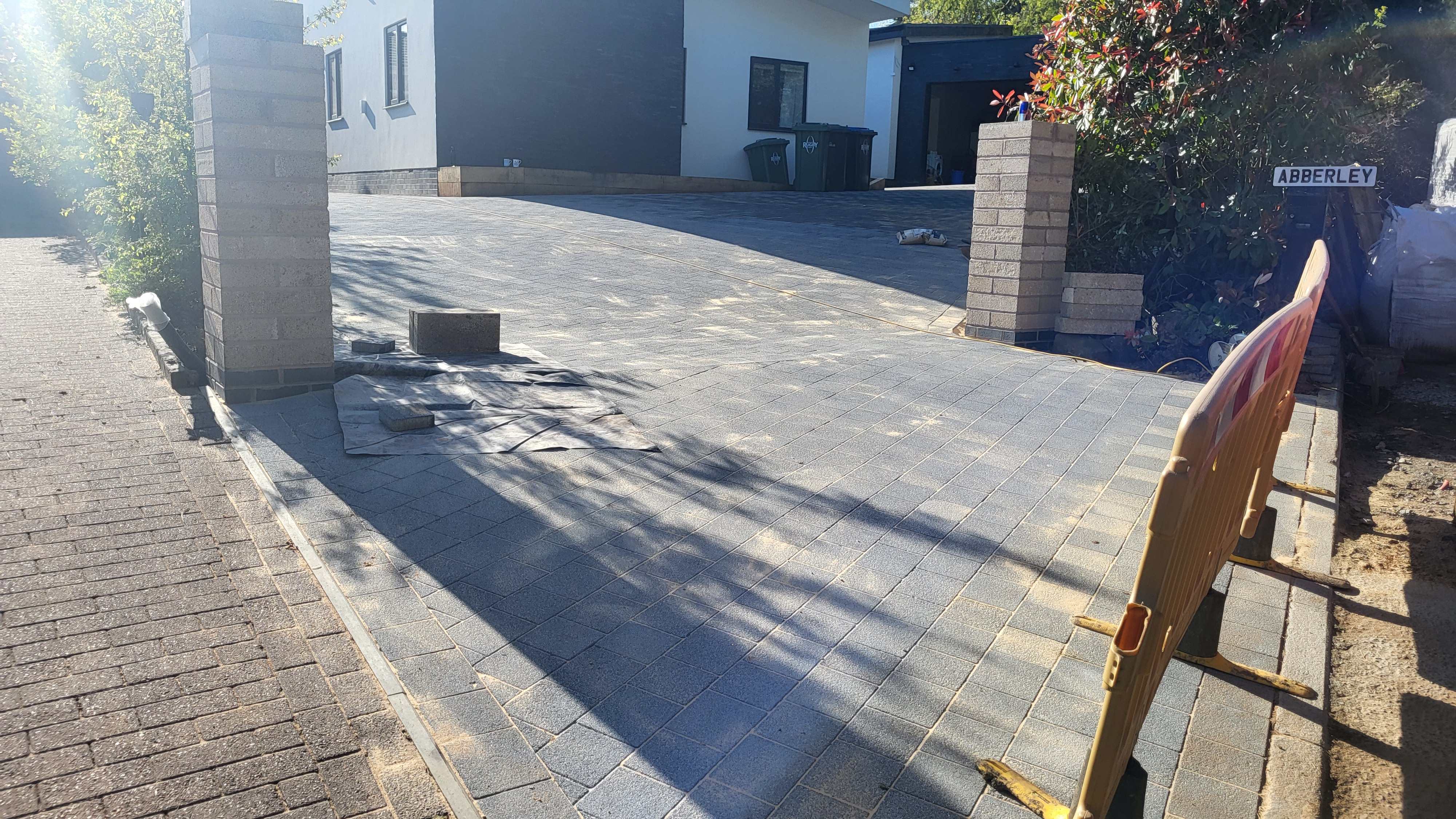

We've got two pillars ready for gates, but due to our driveway curving round one of the gates, one gate will intrude in the driveway if it only opens 90 degrees. Likely to only be a pedestrian gate to keep it narrow enough to account for the steep driveway in that area. Then have the main vehicle gate where the driveway is shallower. Driveway etc (block paved) all laid, so would prefer to stick to above ground mechanisms where possible. How complicated are we going to be asking for when we ask companies to quote? Any pragmatic routes we should be considering? Pic attached, with the two pillars shown. Thanks!
Thanks Connor! The size of the foundations implied the pillars are bloody heavy, just not something I know anything about!
We built two block gate pillars as part of our project. They are made up of high density blocks laid flat, 2 blocks wide. They sit on foundations around 0.5 x 1m sq. Render then applied. 1.8m high for a sort of 1.2m ish gate? The gap is 14ft wide, a miss communication when I wanted them closer together (builder replaced the old wood posts that were there 'as is', I verbally asked for them to be 10ft during quote stage... I didn't spot until too late) A year later we're now looking at installing electric gates. Due to the driveway gradiant rising more steeply on one side, we're looking at doing a 10ft gate and a 4ft pedestrian gate. Now the builder and his team (who were excellent to be fair) have said they're strong enough to hang a reasonable gate off... But my OCD and naturally cynical nature has me double guessing based off zero knowledge. We'd look to have a simple modern aluminium gate with slats. Short of hiring a structural engineer, anyone have any thoughts?
