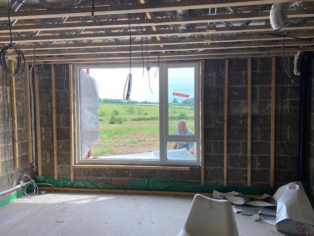

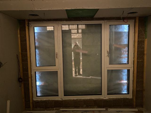

Totally agree some of the blame is down to Internorm and covid-19 but Ecohaus measured several doors and windows wrong in the first place leading to this second wait. Originally these were measured and then double checked at the pre-installation point by Ecohaus's director who also pick up the fact they were wrong. -

Another little update Original planned replacement items were meant to be delivered to England between 13.08.2020 - 29.08.2020. This morning Craig has emailed me to say these are now being delivered 26.09.2020. Original installation of some of the windows took place 16.06.2020. This means the replacement items Ecohaus had manufactured wrong are on a 15 week delivery. This 15 week delivery for the replacements doesnt include for the original delay. Please note the we placed the order for these back in January so we are looking at approx 40 WEEK DELIVERY if this second installation goes to plan.
