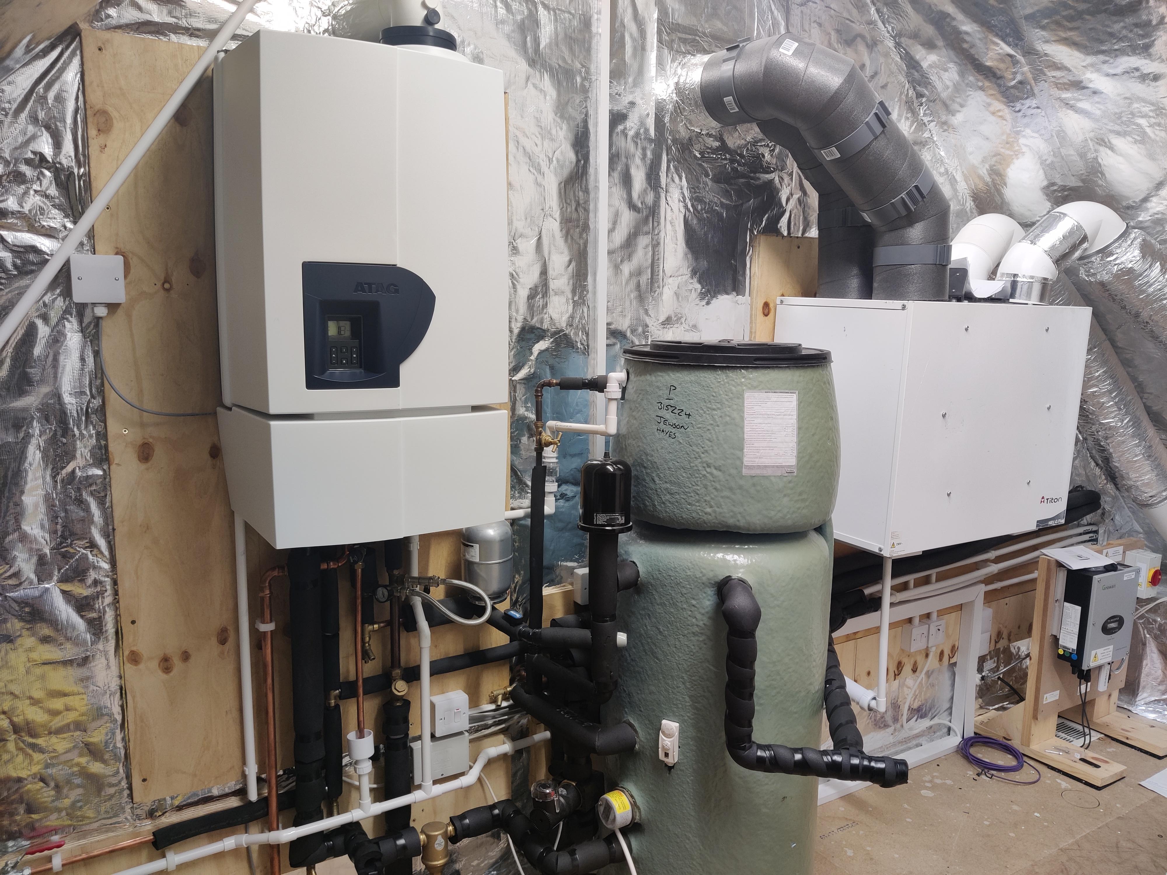

Photo of my combi set up. Thermal store upstream of combi. Cold water is connected to DHW coil, and is preheated prior to going into Atag combi. Winter, combi central heating circuit connected to closed loop heating coil, acting a UFH buffer, UFH connected to thermal store. Thermostat limits boiler heating of thermal store to 40 degs half way up cylinder. If there is excess solar PV, this heats boiler immersion. Summer, heating side of boiler off. PV excess to immersion. Immersion set to 75 deg. Temperature of cold Water feed to boiler limited to 55 degs by thermal store mixing valve. Atag boilers can take preheated water.
