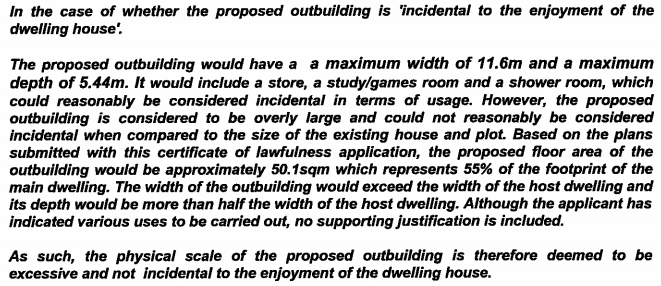

Assuming the OP would be going down the LDC route, the LPA would asses the size of the outbuilding in context with the existing dwelling at the time of the submission of an application. So it’s always advisable to extend a dwelling prior to applying for a large outbuilding. The only potential issue with this is that LPA’s can look to withdraw PD rights following grant of ‘formal’ Planning. -

So you can get a pitched roof designed to come under 2.5m on a footprint of 10m x 6m? The PD rules for outbuildings do not include for it to be used as a residential dwelling/annexe, so be careful there. Although under PD there are no specific rules on how big outbuildings can be, their size has to be relative to the existing dwelling. I can't see the LPA agreeing to an outbuilding under PD, which is more than 50% of the floor area of the existing dwelling to be relative/ancillary. -

Although not directly answering your questions, but I have a few questions... - How close to a boundary is the outbuilding to be? - What is the outbuilding to be used for? - What is the floor area of the existing dwelling? -
