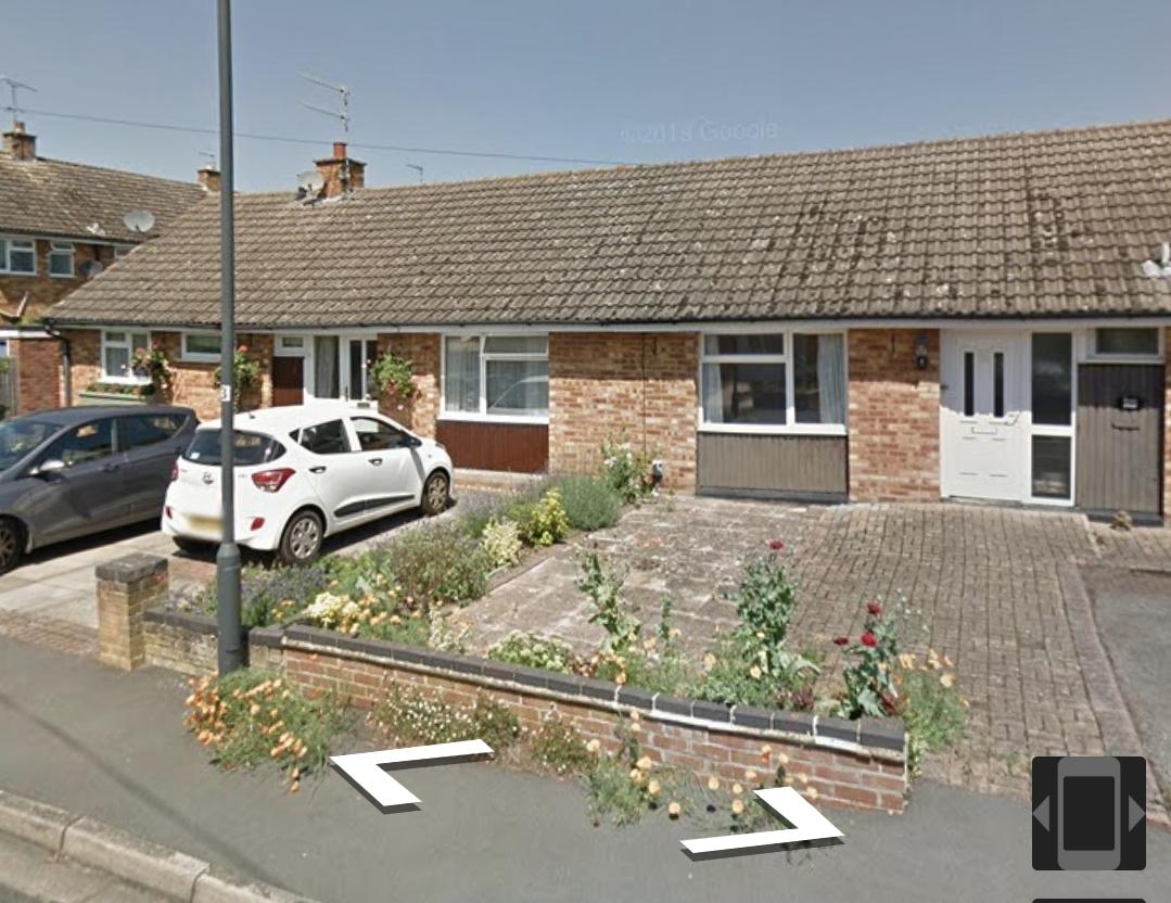

  2. Hi all Three years ago I posted that I had instigated a subsidence claim re my dad's 1963 semiD bungalow in Stratford upon Avon Warwickshire and had therefore had to place our extension plans on hold pending claim. Three years later, insurer (foll use of its multiple experts) has accepted full liability for claim, declared that as it is progressive subsidence and that due to extent of damage to bungalow & the challenges of the land/original foundations that the bungalow is to be fully demolished, the (new/tbc) floorplan is to be fully piled and that a new DETACHED bungalow will be built. It has been determined that detached is required due to the required repairs to ours would endanger the attached bungalow. Next door are very happy to go detached at our Insurer's cost (& us giving them c4 inch for outside wall) Insurer has elected to use our architect & our structural engineer and we await the first designs - the challenge being that the existing bungalow's width will be reduced by c1.8m (combination of: 2x exterior walls ilo one party wall, one new rear access path (we want at least 1.35m) & leave at least 0.35m between us and other boundary. Question One The good news is that we have good depth of plot both front & rear so I thought a *replacement design (for 3 beds, one lounge, one kitchen, one main bathroom, one wc, one hall) would be simple ie just go deeper and less wide.........however our architect has advised that although we are not in a conservation area that planners hate different ridge heights/ roof pitches.........so how does one go deeper/how much and keep planners happy? Question Two: Also, we are hoping to work with Insurer and have a new/bigger sqm build with us paying the difference of course - nothing major, but want to have bigger kitchen, bigger main bath (to make into wetroom with bath) plus extra spare space for a staircase (in case we ever want to go into roof & would also pay for the type of joists/materials required).........how is this best discussed/evidenced to Insurer Build 1 vs Build 2 costs (checked by a QS that we engage) & we pay difference? (Dad can decamp to my house so we would already be contributing "accommodation" costs) We already feel that we have won the lottery with Insurer accepting full liability as it has been a very rocky road and to get a detached new build is a dream BUT I want to make sure that I don't miss any opportunity to get the best/right build for us. Thanks, Michele

  4. Hi, I'd really appreciate your opinions please re power grouting vs piling ref our insurance claim. Dad's owned from new 1963 3-bed semi-detached bungalow has major subsidence across majority of floor plan. Eg across back of property it drops 158mm in 5000mm. Rear and front elevations have moved off damp course. External brick work has cracks through bricks in several places, tiles in bathroom are being pushed inwards off wall (front elevation), ceilings buckled throughout. I could go on.... Hysterically, Insurance after finding/fixing minor drains issues front & rear, then completing 2 months of stud monitoring declared property to be stable and wanted to send decorators in. Thinking this was utter nonsense, I instructed our own SE who discovered sand/ash fill foundations, major erosion/voids and trench footings. To our & our SE's utter surprise, Insurance has fully accepted our claim for subsidence in writing and we await their & their "experts" (360 gobalnet & shire-uk) proposed solutions for ground stabilisation & repairs below/above ground. Initially 360 proposed power grouting but this was wholly rejected by our SE not least because of the lack of a party wall agreement (subsidence is also affecting adjoining property) & that 360 offered no proposal for superstructure repairs.....which he believes should be agreed at same time. He is a very experienced 45 years+ chartered SE and his view is that PG is not a suitable fix for our issue but also that the cost of the amount of PG required ....would make it uneconomic and nor would it be the required permanent solution to make bungalow fully stable in long term. His view is that full demo, pile & rebuild is cheapest and quickest for Insurer. This is also our preferred route.....as would also rid us of a pig build rear elevation ....we gain/lose a brick across before/after a cedar board insert. Does anyone have a view of PG being proposed by Insurance companies? This was latest comm from 360: "It is impossible to know at this stage the pros and cons / costs of any scheme and this will need to be developed – obviously the economics of any solution against demo and rebuild would need to be assessed. Ultimately, this will be a decision that insurers will make and not something that Shire will determine – they can only advise us on the technical aspects. I would reiterate that no decisions will be made without being discussed with you and your father. Once Shire have been and assessed, we will be in a better position to determine the best way forward." Sorry for long post, Thanks

  6. Hi So a (failed) subsidence claim, a full ground & building survey has determined that my father's 1963 semi detached bungalow (3 bed 86 sqm) is subsiding due to: 1) original insufficient foundations (sand/ash & inappropriate sized hardcore ie with huge gaps) & 2) multiple above-ground original 1963 quality of build (ie pig build inc different number of brick layers at various stages aroundf the property). Our independent structural engineer after multiple trial pits has advised that the property requires underpining across its entire footprint to make it stable before we even think of trying to correct the horrendous pig build. The property is long overdue to be refurbed (wiring, heating, decoration etc) and hence we THINK we have concluded that a demo/rebuild/minor extension is better than trying to repair the existing - subject to planning permisson of course. Our rationale: Bungalow Values £380k - New Bungalow (115 sqm) new foundations, fully mortgageable (Rebuild (inc vat claimback) £135k max (no rehousing as we have FOC options, cost 100% funded from savings) £140k - Existing Repaired/refurbed Bungalow inc = £90k Am I over assuming when I conclude that if the new bungalow is built to all required building reg standards and on new fully piled foundations (with expansion joints between us and adjoining bungalow ((only partly underpinned in 1990) that this would wipe the slate clean for Insurers and Mortgage providers OR would the property still have a a proverbial alabtross around its neck? (The owner of the adjoining bungalow uses it as a long term rental property and has done for 2o years plus, as such he has no wish to spend money on his property other than maintaining a safe (but crooked) property for his tenant to reside in. Also, please can you recommend the best book for planning a demo/rebuild. Thanks, M
