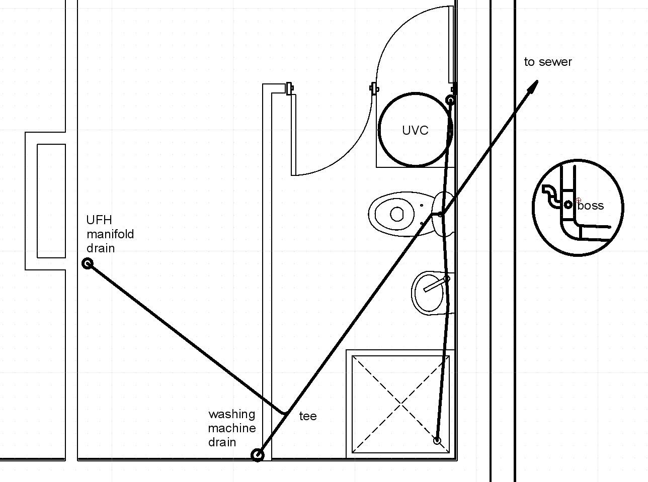

Following @Nickfromwales advice I started with 50mm pipes for shower and sink, but what advantage (in performance) will they give me for manifold drain and UVC? Being at UVC, will I be able to drain into common stack (made of uPVC), or do I relly have to think about a separate through the wall discharge point? Here is the schematic, the spaghetti junction under the toilet is just boss pipe linking all the 50mm branches, one of those with 2 x knees to adjust angle to suit. Edit: do I need a trap for washing machine, or a sealed connection will do? Edit 2: AAV is missing! Will it be happy in UVC cupboard?
