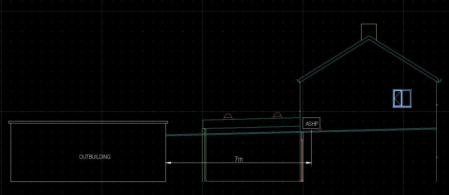

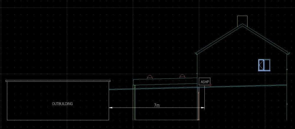

Mancave 30 m2 2 m from the main building and 7m (ok 10, with elevation) from planned location of ASHP unit. Is it better to connect it that way, or to have a separate small ASHP unit for the mancave only - I know it will need planning permission (but I'm working on one anyway, so can throw in just in case), and will cost slightly more, but running well insulated pipes may be a challenge and expense too.

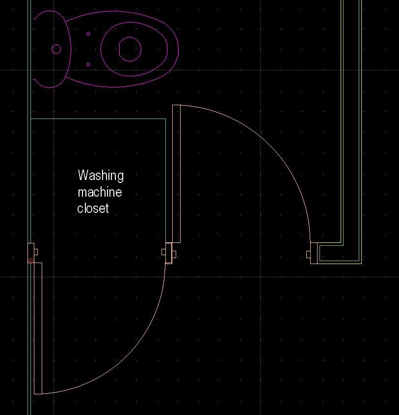

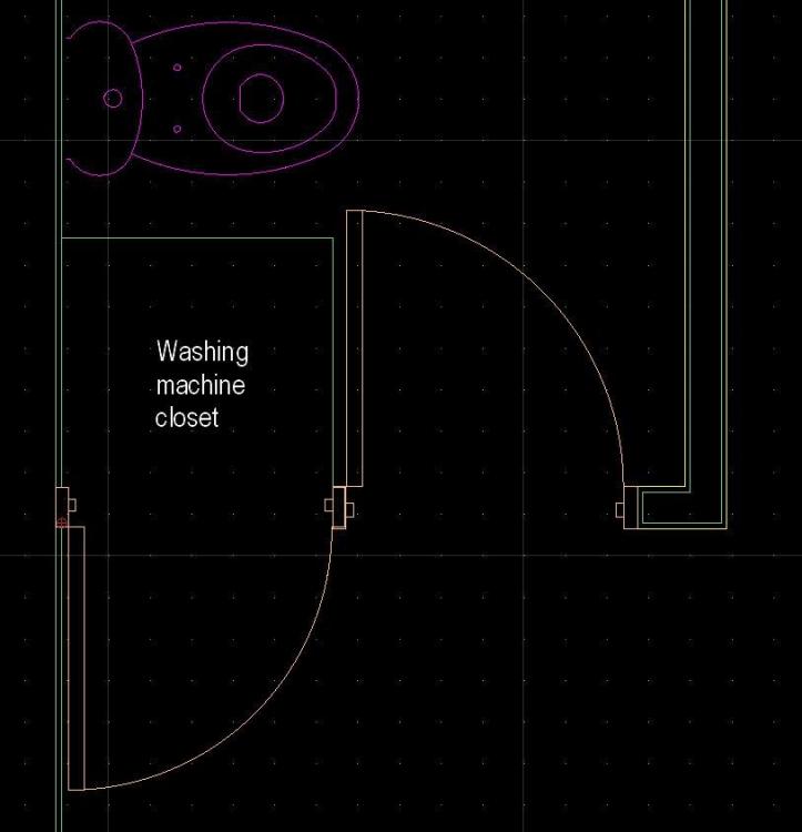

Because a washing machine/tumble drier becomes a killer the moment it walks into a British bathroom, we'll better keep it out. Kind of. I carved out a 'closet' so the access is from the outside. Question: what constitutes a 'wall' the idea does work? Is a single layer of plasterboard enough? It would be hard to join it at the corner, so I might slot in some batten and make the partition at the toilet side a double layer, but still no more than 50mm total thickness - is that any better?

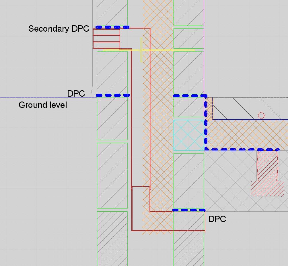

A drain seems like the most sensible solution, that will simplify the outer leaf DPC (leaving only the 'standard' layer at 225mm in my case) and will protect the wall from any surface water - the slope of the garden, however shaped, will still be towards the house in the end I've found some ideas here https://www.pavingexpert.com/threshold01#doorway-drainage (there is a patio door to consider as well, will just extend it all around the wall). One question still unanswered though: can inner leaf DPC be also positioned at 225mm (1 block course up), rather than at the floor level? That would make my life so much easier to have that floor level joint available for wall ties.
As the original house is barely above the ground and the garden is sloping towards it, so the finish floor level of the extension will be at ground level. That maybe makes stepless patio door and Part M happy, but causes issues elsewhere. There aren't too many details available for this case (all the stock drawings cover typical case where FFL is well above the ground and the life is easy), but I found something and translated into this: So it uses a 'secondary DPC', although as I look at it, what is marked as 'secondary' is actually primary >150mm from the ground DPC. The other layer right at the ground level doesn't seem to make much sense, but I believe it is there to restrict travel of moisture at least internally, as if it somehow crossed the cavity, there is nothing else to protect the inner skin. Is my thinking right here? Is the original idea sensible? Does the inner DPC need to end at FFL, could it not go one course up ?
