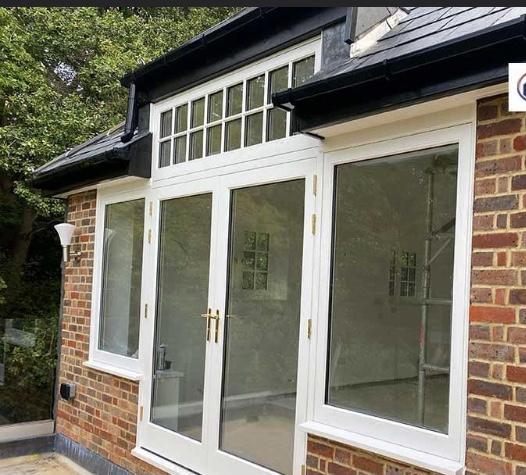

A bit like this? Ive no idea on the engineering/design practicalities but it seems you’re having headaches solving the lintol/depth issues & at the same time losing height & light from your window.
I’ve been put in this scenario myself-it’s an absolute #**#ache. As Declan said-blown in beads or full fill cavity batts are the practical solution. Otherwise,you’ll end up with an improperly inststalled,underperforming insulation system. If the PIR has gone up in price & is still packaged,would you not get the majority of your money back?
What width is the window shown? Would it be feasible to sister up the trusses either side,have the head of the windos as an upstand (kind of like a dormer) and trim across to suit?
