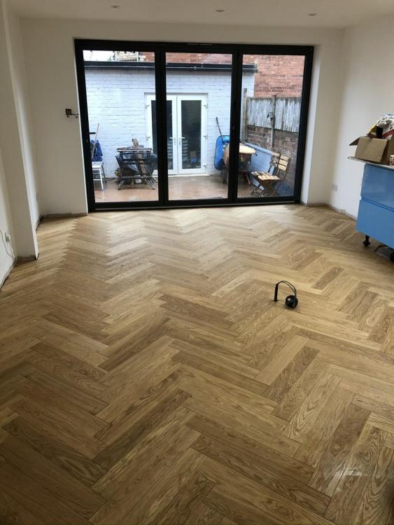

I too followed all advice, ie, screed was dried for over 7 months, flooring was acclimatised, temperatures slowly brought up once commissioned. I don’t know if it’s anything to do with the herringbone pattern?
My kitchen stat is at 18 and rest of house at 21 (it’s draughty out of the kitchen!) I think your right with the shrinking and swelling, the slight gaps are setting off my OCD - suppose I’ll just have to get used to it!

Hmm, the house is a Victorian terrace, solid walls, no cavity insulation, minimal loft insulation, however the new kitchen, has 150mm celotex in the slab, and 130mm flat roof construction. It’s always considerably warmer in the kitchen half of house. I actually can’t turn the blender down any lower on the UFH so unsure how I’d progress from here!
Thank you, running at 35deg, the minimum it can be set at.

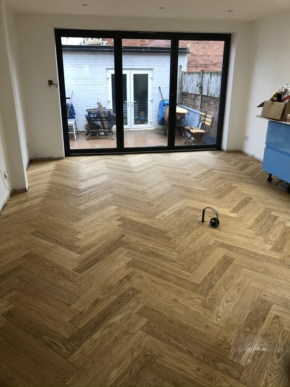

Hi Guys, Back last summer I fitted an engineered wood floor in a herringbone pattern. This was onto a levelled screeded floor and stuck on with f ball styccobond. Since I’ve been using the UFH more the planks appear to have shrunk/moved leaving a 1-2mm gap in places. Is this likely to settle/get worse/get better with UFH off? Any ideas? I’m quite tempted to fill in the gaps and re-oil the floor in the spring. Said floor:
