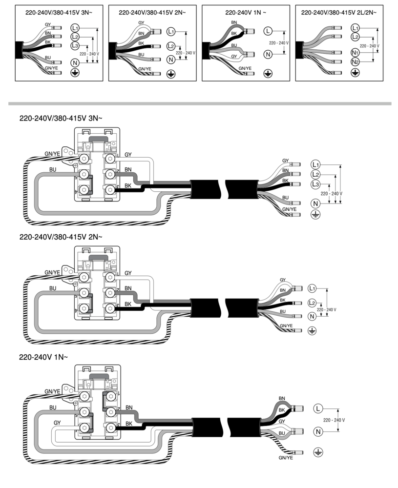

Late to the party but 2 phase is pretty common in Europe. Typically oven wiring diagram. Options for single, two or three phase depending on the supply:
